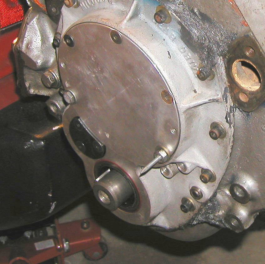

to add complexity I have a pointer on the gear drive cover for timing... (IMG:http://www.914world.com/bbs2/html/emoticons/screwy.gif)

i doubt that the pointer will be accurate on whatever balancer he has.
when using non stock stuff its best to establish tdc with a dial indacator with the head off. then you index you pointer and balancer for tdc.
after market has been off way off in my exper.

If ya have it dead nutz.. (I would)
Messix is correct.
Come to think of it...
To time the engine with a timing light..
You are going to HAVE TO KNOW exactly where TDC is.
So the pointer is accurately reflecting the TDC or whatever degree BTC your balancer is supposed to show..
Else your gunna be stuck timing it by feel... (not) (but it can work if it's all ya got)
Thanks Messix.
By the way... Does the balancer have degree tape or markings on it?????

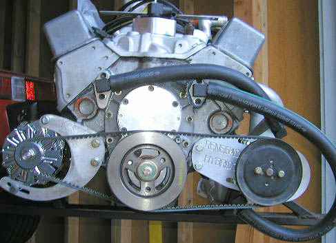

The HEI rotor is not as "pointed" as non-HEI...
The engine ran in a car for a year. The PO just removed his injection manifold and dist...
I didn't even install the original pointer since the belts were in the way. PO ran elect. water pump...

These guys got it covered, just be careful w/ the 5-7 plug wires, it's easy to mix them up.
As far as timing, can either build a bracket and mark the balancer somewhere you can see it w/ the motor in the car (and running), or go through the top of the bellhousing, and mark the flywheel, i've seen both ways work succesfully.
I like to make a bracket on the bottom 1/2 of the balancer, drivers side, and mark where TDC#1 is, have to lay on the ground to see the mark, but it's not too bad. Also have to have a timing gun that you can dial in the timing you want. A 2nd person moving the dist is 500% easier than doing it all yourself.
