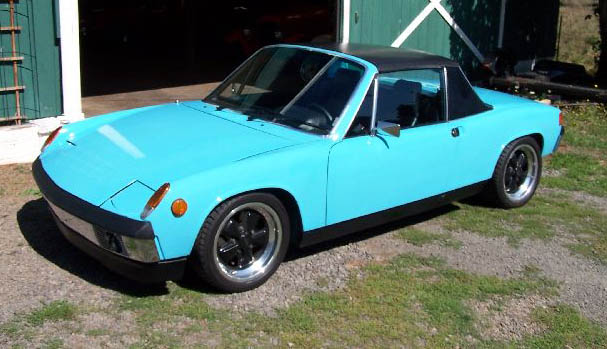

I have the large backspace 16X7 dials on my narrow body (wish I could be called that) with spacers. 205/50/16 is all that will fit without doing a tug and pull. 1 1/4 " spacers on mine. Your results may vary. BTW, even the 205's get wider with the 7" rim, it spreads them out a bit.

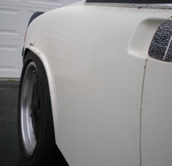

The picture shown is of my V8 car with 7” x 16 Fuchs 911 offset. The lip is rolled. This car is getting 951 offset 7” and 8” Fuchs with 245 rears and 225 fronts.
There are pictures of people on this board running 8” 951 wheels with just a small bit of adjustment to the stock body. The 8” 951 look just like the 7” 911 wheel and need just the lip rolled. One of them will step up or you may find it in the search area. 8 rear 7 front

Thanks for posting the image. I am amazed 245 fit as well as they do, I was expecting the body to be far more distorted to stuff that size rubber into that wheel well. It gives me more hope about my 225s.
I was checking out the space I currently have with deep 6 fuchs and 205/50 B F Goodwrichs. I have enough room to run my fingers between the tire and fender with completely stock openings. I have been studying the wheel charts and the 7R extra inch is all to the inside. The 225's should be 10mm wider on the outside and 10mm wider on the inside It would be close but the 10mm width on the outside of the tire "might" just fit. I have no clue if the extra width to the inside would rub on the tub.
I will start by doing some test fitting. The 951 wheels I have have no rubber on them so I can't try them as easy as the Rs. I won't get around to this for a little while, it's a little cold out there, New England winters . I will report back

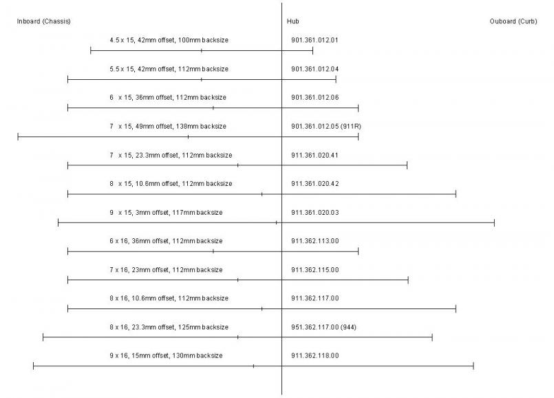

This chart help me when I was trying to decide when switching from 14" x 5.5" fuchs to 16 x 6 fuchs on a /6. There are so many factors since there are some wide 205's.

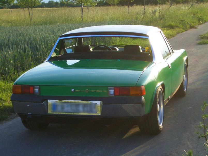

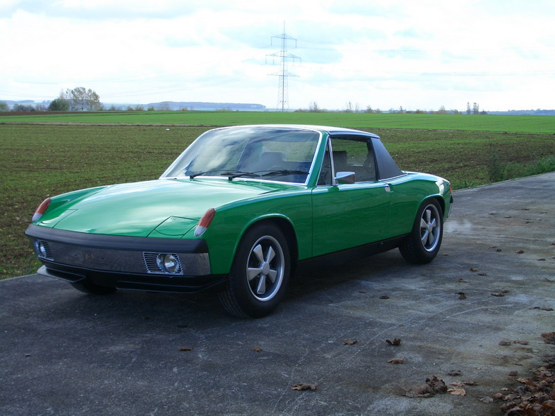

I`m driving 7"R Wheels all around and also 7 + 8 x 16 (951) from 944 Turbo. For the 7"R Rims you hva to take Spacers (on my Car 27mm). On the 7R Rims i have 185/70/15. The rear Fenders are bumbed out about 1 inch and rolled. In the Front it`s not bumped, but also with Spacers and rolled. If you don`t take Spacers, the Wheel will "scratch" the Body. On the 951 i have 195/50/16 in the Front and 205/50/16 in the rear. There is not much place at the rear Fenders between the Rubber and the Body, maybe 5mm.

Your 914 is gorgeous. Thanks for posting the images.
