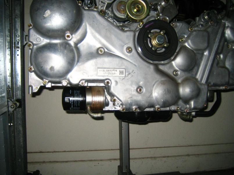

First pics of my EZ30R engine with 1000 miles total!
Now to take out the Ej20 turbo this weekend and see if the new engine can fit on the renegade engine cradle!

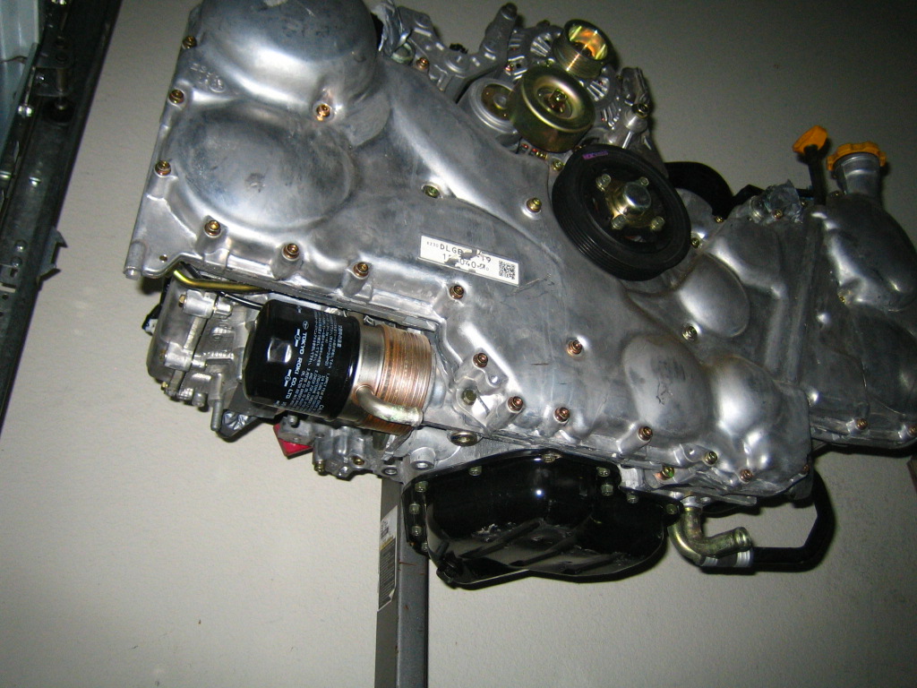

How about a side view pic so we can see the oil pan. Is this the engine with 1 big exhaust port or 3?

QUOTE(Porcharu @ Apr 2 2010, 11:03 AM) *
It should be a three port engine, due to the composite intake, the earlier engines didn't have variable cam timing or valve lift, and had aluminum intakes.

EJ20 is out finally!
Yes it is the 3 Port Exhaust, not one.
Its going to be N/A, check out the oil pan, save depth down as Ej20, but obviously different.
Just ordered the Motor mounts(different than Ej20) from ebay yesterday, so i'll be trying to fit this baby into the Renegade Mount next week.
Stock Subaru Engine wiring Plugs also ordered, so this wiring will be clean! Should plug right into the 2 square electrical plugs on the engine.
Going to be Dual exhaust, and I am making the header, so you guys can see my Tig Welding, I think I am way better at it now.

side

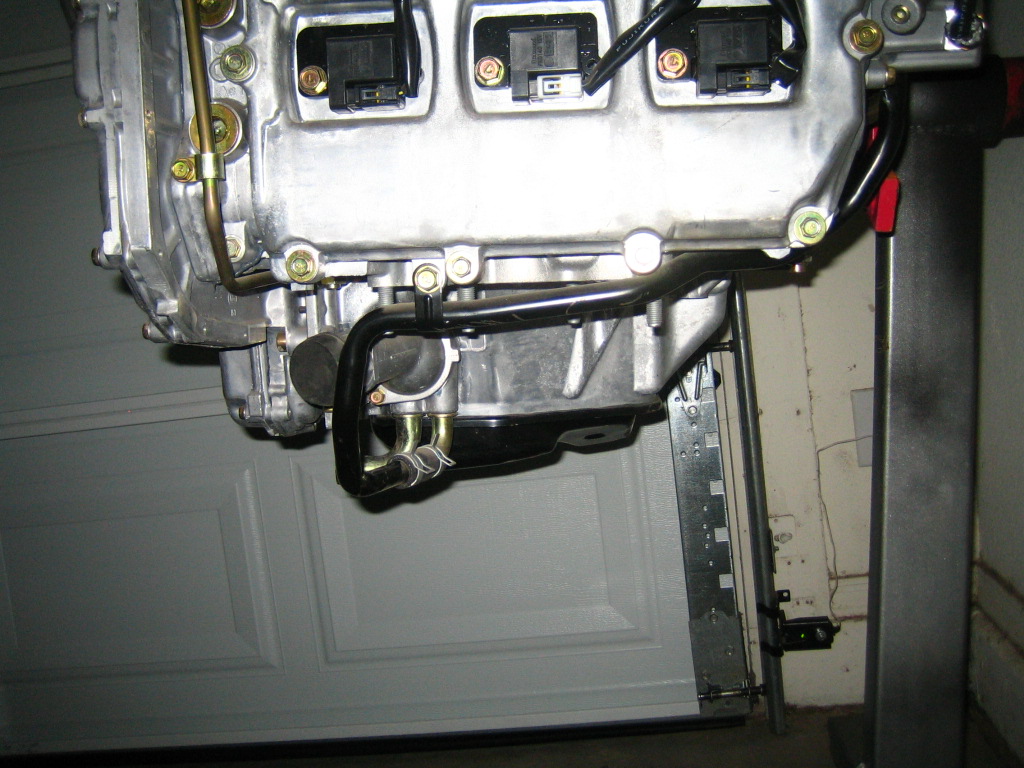

Underneath....hey also if anyone knows...Why doesnt this Engine have a fuel return line? They all dead end into the injectors equally with no return. Have to figure out how to hook this up.

Member No.: 10,496
My Dodge V10 has no return line either. It uses a 45psi pump to the 45psi injectors. The pump has an internal bypass to "dead head" the fuel during idle.
