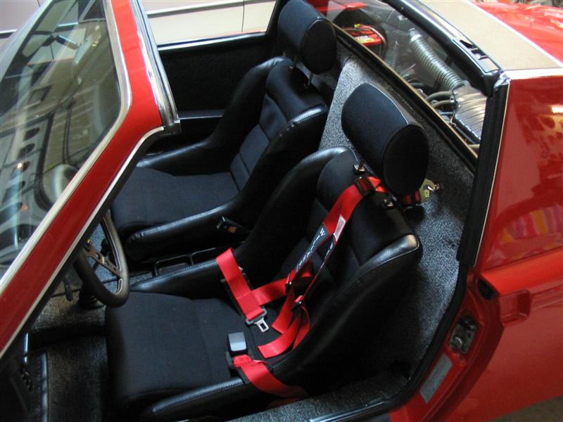

Here is mine covered in perlon. I love the look compared to the backpad. (IMG:style_emoticons/default/biggrin.gif)

Dynamat, on the firewall and then I just used spray adhesive to adhere the perlon to the dynamat.
(IMG:http://www.914world.com/bbs2/uploads_offsite/i132.photobucket.com-3881-1274113295.1.jpg)
(IMG:http://www.914world.com/bbs2/uploads_offsite/i132.photobucket.com-3881-1274113220.1.jpg)
The roll bar...
(IMG:http://www.914world.com/bbs2/uploads_offsite/i132.photobucket.com-3881-1274113220.2.jpg)

I had to cut a couple pieces of carpet for the bottom of the firewall and the area between the seats. Easy enough to do. Just cut the pieces and get a local shop to stitch the edging around it. I think they charged me about $20 bucks.

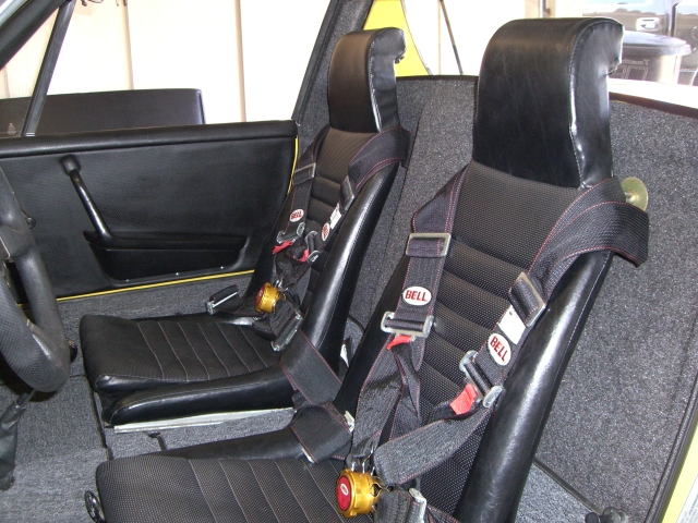

mine...

That would be tough, as it would have to be a molded part. The amount of curves and reccesses on the firewall is surprising. I initially cut mine with what I thought was plenty of overhang that I would simply trim off after it was glued in. It ended up being way to small. I then added an extra 16"+ to both dimensions and was able to get it in - after graciously using both a spray bottle and a heat gun to strecth and mold the perlon to all of the ins and outs. It was way more work than I expected. My fingers were raw afterwards.

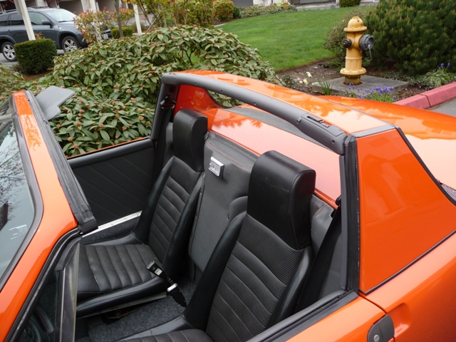

Here's mine that I did a few years ago.
