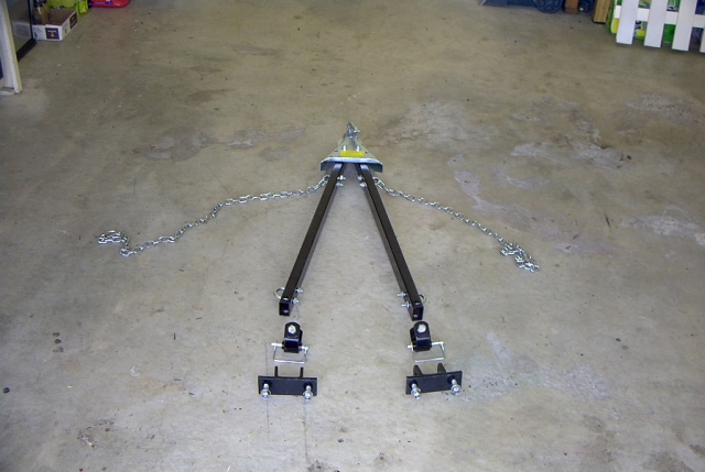

Interesting, that's my today project. Bought a cheapo on ebay. Plan is to put car brackets behind grills if there is enough room there. Looks pretty simple, but you know how that goes (IMG:style_emoticons/default/biggrin.gif)

And the target..

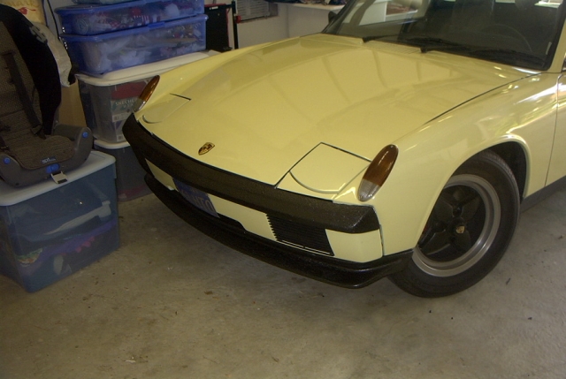

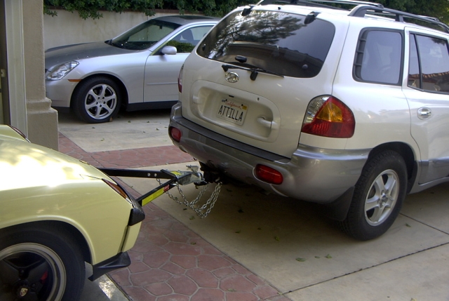

As usual with my projects, I goofed and mounted plates too far apart. Thought it said max 46" separation but it was 41". Reading comprehension!!! A few rubber plugs and skinned knuckles later, all is well. Brackets fit easily behind grills, so no cosmetic problem.
Nice 'u-joint' setup on towed end. Eliminates need to mount on a perfectly flat area. Now to FLAPS for light wiring. Can I tap into the 914 tail and brake lights? Attached image(s)
| Howard |
Apr 29 2004, 06:28 PM
#17
Incontin(g)ent Member ![]() ![]() ![]() ![]() ![]() Group: Benefactors Posts: 5,785 Joined: 24-July 03 From: Westlake Village, CA Member No.: 943 Region Association: None
Pic 2

Howard,
I really like your set up. (IMG:style_emoticons/default/clap56.gif) Would you be willing to share some detailed info on its design; materials used, dimensions of components, and perhaps close up photos of the brackets mounted? I also have a Santa Fe, a 2004 3.5 liter. How does yours handle towing the 914? Do you feel that the Santa Fe has enough power? Thanks |
