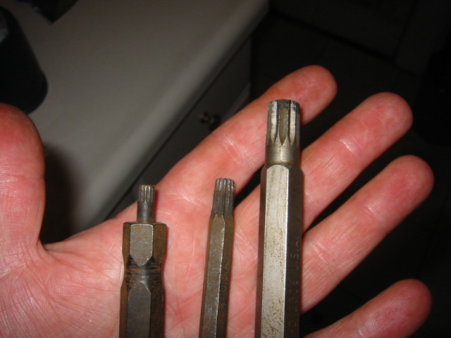

its a double square bit, 8 points. Torx are 6 i believe, the 911 tool listed in PP is the one...
This same bit is available at your local sears, or good auto parts store

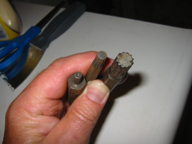

here are some selected bits for internally driven bolts..
TimT
post Jul 7 2004, 06:03 PM
retired
Posts: 4,033
Joined: 18-February 03
From: Wantagh, NY
Member No.: 313
Snoooozle

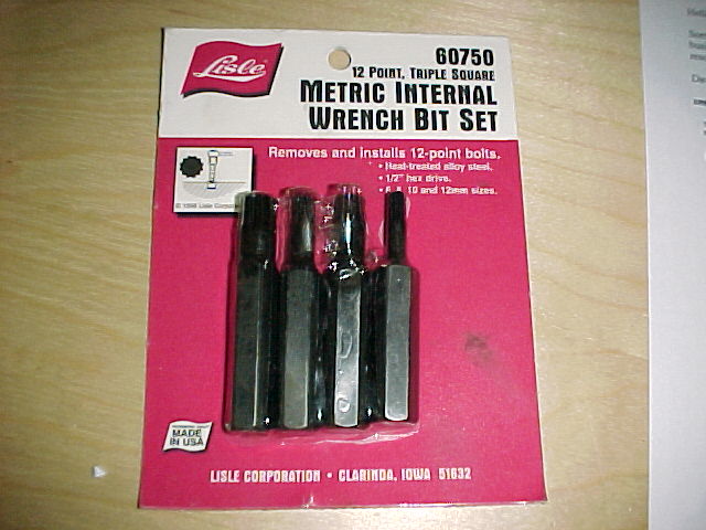

My Sears no longer has them (I checked recently).
Pep Boys did:
All the info you need should be in this picture. Less them $10 for the set if I remember correctly:
From my experience, always tap them lightly with a hammer to fully seat them though the muck and grit before torqing on them.
