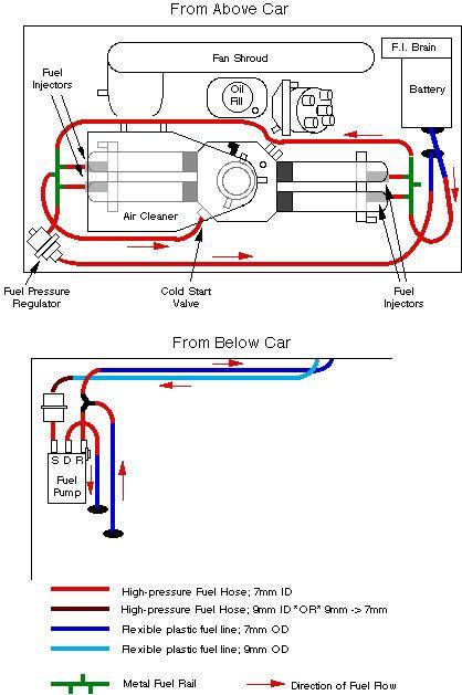

QUOTE(newdeal2 @ Jul 15 2004, 09:46 AM)
Just add one with a barbed T after the fuel pressure regulator .
Not with the stock FI setup... You want to T into something "downstream" of the fuel pump, and "upstream" of the pressure regulator.
Pressure regulator analogy time--
Picture a garden hose. Turn it on and watch the water come out of the end. There's some pressure in the hose, right, but not a whole lot because you're letting it out the end. Now, put your thumb over the end. What happens to the pressure inside the hose? It goes up. Now, let your thumb just a little tiny bit off the hose. You get a spray of water, of course, but what happens to the pressure inside the hose? It drops, by some amount that partly depends on how much of a gap you leave.
OK, now picture the water supply as being the fuel pump. The garden hose is the "high pressure loop" of your fuel system (including both fuel rails). Your thumb is the pressure regulator.
The regulator is a spring-loaded valve. When the pressure inside the rail is high enough, it pushes the valve open and bleeds off enough fuel to drop the pressure back down to the set amount. It's as if you moved your thumb to make a larger or smaller opening according to a pressure gauge on the garden hose. (The L-jet one has a vacuum diaphragm as well as a spring, and the fuel has to overcome the manifold pressure as well as the spring force in order to bleed off into the return line. But it's a very similar idea.)
--DD

SpecialK
post Jul 15 2004, 07:13 PM
aircraft surgeon
Posts: 3,211
Joined: 15-March 04
From: Pacific, MO
Member No.: 1,797
This may explain what Dave is trying to "lay down" as far as gauge location goes. If the regulator is your thumb, the injectors are leaks in your hose upstream of your thumb. You need to know what the pressure is in the hose.
Whatever...a picture is worth a thousand analogies
Ooops...compliments of the 'Bird' and Dave.
newdeal2
post Jul 15 2004, 07:19 PM
Unregistered
The gauge was located just above the regulator in the diagram before the fuel rails
SpecialK
post Jul 15 2004, 07:25 PM
aircraft surgeon
Posts: 3,211
Joined: 15-March 04
From: Pacific, MO
Member No.: 1,797
Should work correctly then (IMG:style_emoticons/default/wink.gif)
