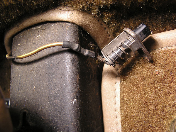

86motoman, just for reference here's a couple shots from my '76

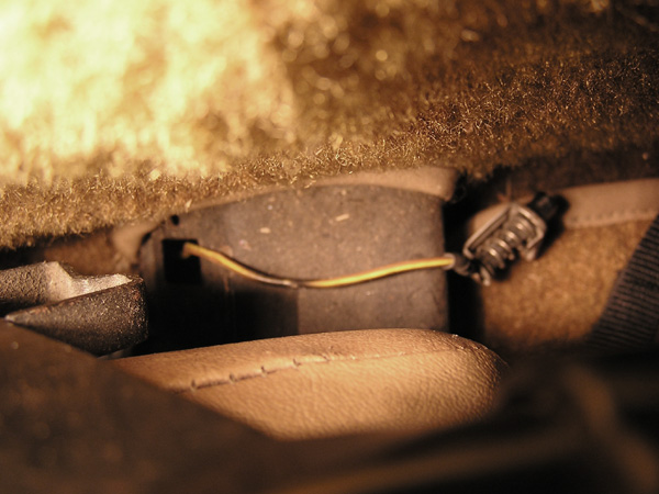

#2 (look down on left-side of drivers seat)

That's not a burn is it???? (IMG:style_emoticons/default/ohmy.gif)

QUOTE(sgomes @ Sep 13 2004, 09:00 AM)
heh, yeah. If you think that's bad you should see some of the other PO wonders I'm dealing with (IMG:style_emoticons/default/blink.gif)
