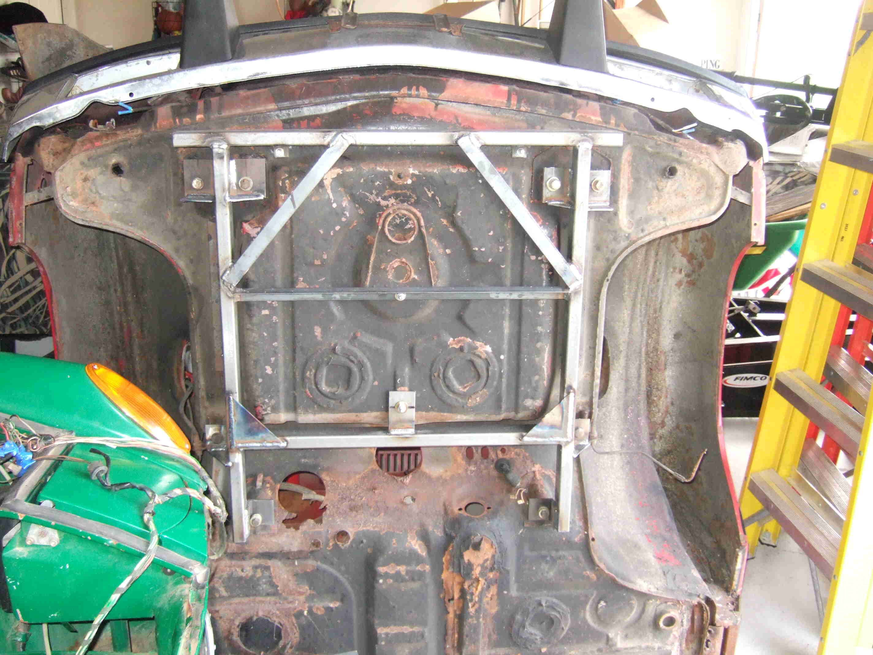

I am welding in the inner suspension ear and I am trying to figure out what dimensions have to be exact and which can be accommodated in the regular suspension adjustment. I will of course try to get it perfect but I am looking for any gotchas that I have not thought about yet.
I know I should have jigged it up before I got started but that was years ago and that ship has sailed. If you have any thoughts on how to build a jig and do it now I'm all ears but I have not been able to figure out a truly reliable method yet.

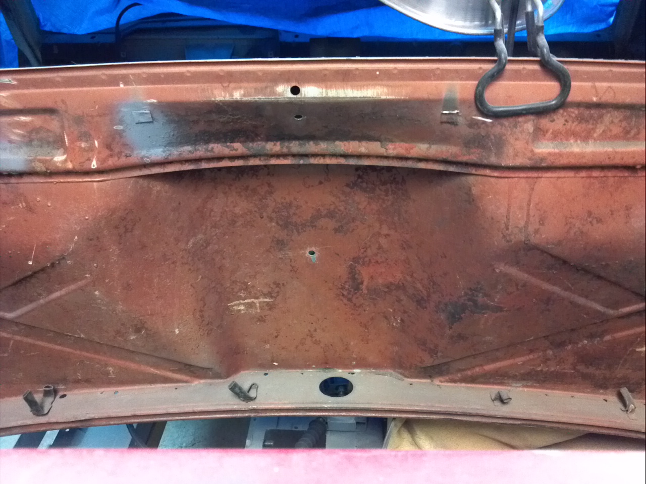

Jeff Hail
post Oct 31 2014, 09:46 PM
Posts: 1,141
Joined: 3-May 07
From: LA/ CA
Member No.: 7,712
3 holes to choose from

As for the twist. I think when I put in the new engine compartment long one end is off just a smidgen. Everything was perfect when we measured and tweaked the old suspension console for about 4 hours. Thinking I had everything exactly in place with clamps. I used self tapping screws in every other hole to hold it down before I started welding. That must have tucked the firewall side of the console just a tad tighter on the top corner and I didn't go back an remeasure. I was getting too excited about getting to weld again. DAMMIT .............. (IMG:style_emoticons/default/hissyfit.gif) (IMG:style_emoticons/default/hissyfit.gif)
Worse part is I can now see it with my naked eye when I put the all-thread thru the two consoles to measure the spread. It lines up about 2 inches from my frame jig. That really pisses me off (IMG:style_emoticons/default/hissyfit.gif) (IMG:style_emoticons/default/hissyfit.gif)

QUOTE(Jeff Hail @ Oct 31 2014, 11:46 PM) *
I didn't have any type of jig for the inner suspension console either. Using the third hole down in Jeffs picture, I cut a piece of steel brake line to 28 1/4" to get the fore-aft alignment.

MacGyver ( Super In Law, Grandpa Jack) built me a giant divider type gadget to measure more precisely. Worked great. But still off 3/16" or 4mm.
I wonder how far off the other 3 cars I have are based on Jeff's lifetime of observations? Project for another day.
