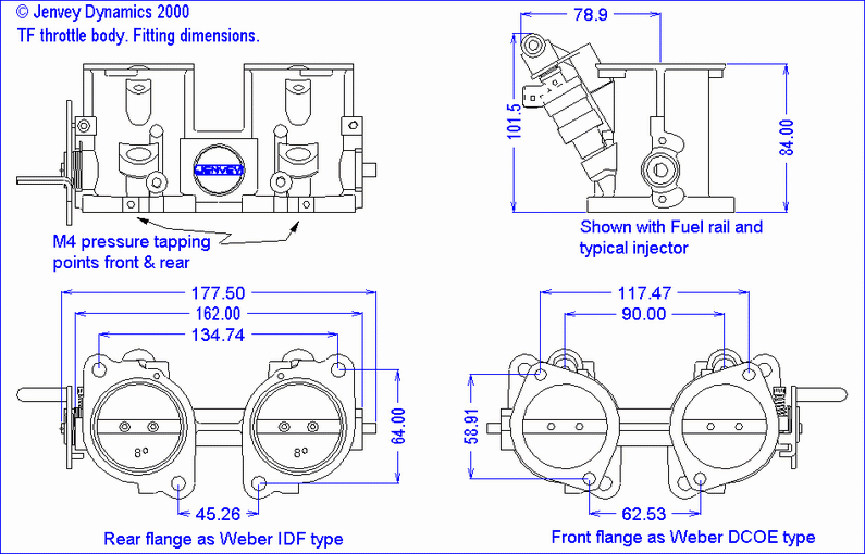

I've been researching the Kit Carlson EMS, and i got some TB questions.
Will a particular Jenvey TB work with the 3 bolt, 2L head ? part # ?

I run their stuff alot. You ned the TBs that allow the use of an IDF manifold, then you need the correct manifold for your heads.
I am running their TBS on my 3.0 in 52mm flavor- They have nice stuff.

yea, the TF Series. but they have a four bolt configuration to mount to the head...
what about the 3 bolt, 2L head ?

You don't both them directly to the head. You bolt them to a carb manifold, in this case an IDF carb manifold. The IDF manifolds for the T4 are available from everyone that sells carb kits, often in a form that cam be used on 3 or 4 bolt heads (five mounting holes).

Your engine would look like this. Those are Jenvey TBS in 45mm flavor...See how the TB bolts to the manifold?
http://www.aircooledtechnology.com/kitcarlson.htm
tall or short manifolds ? looks tall in the pic...

Doesn't matter as long as they have the weber IDF bolt pattern.
The TB is just like a weber carb without the jets, float, etc.
But the tall manifold is most likely better for flow.
