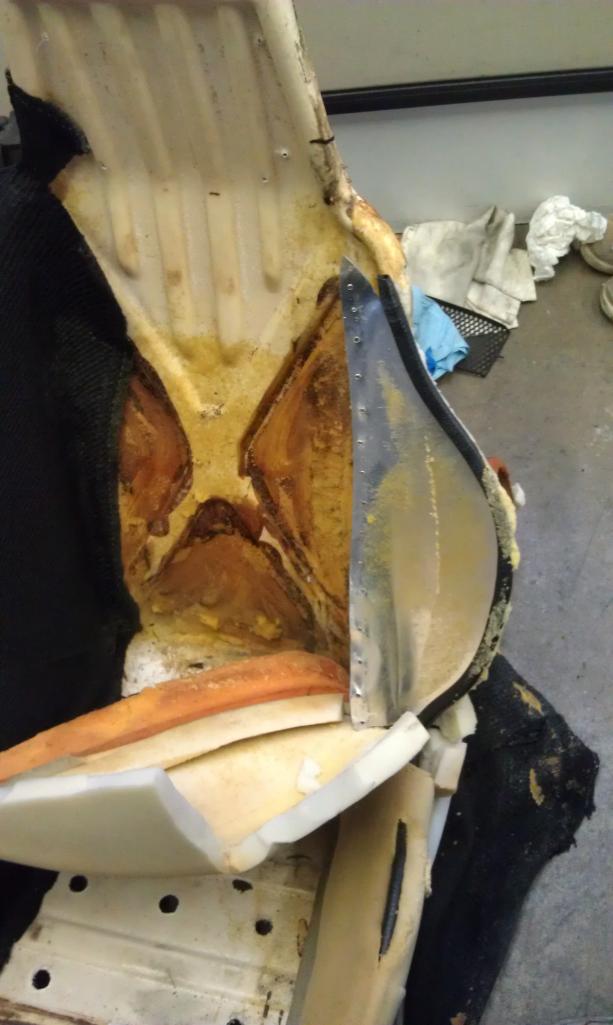

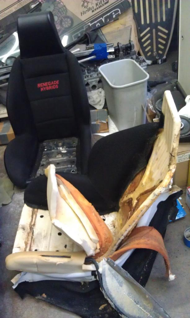

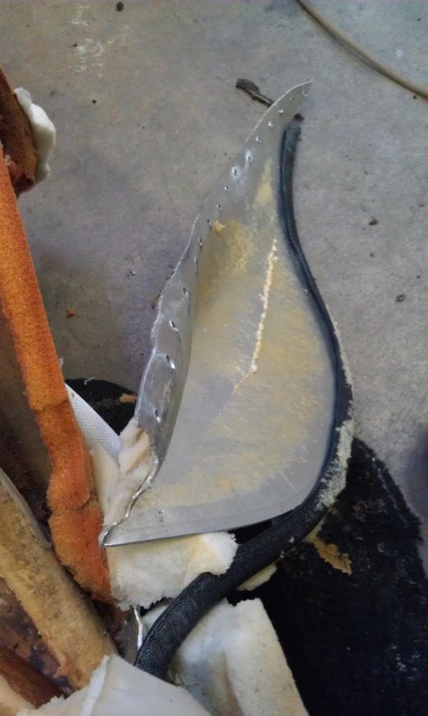

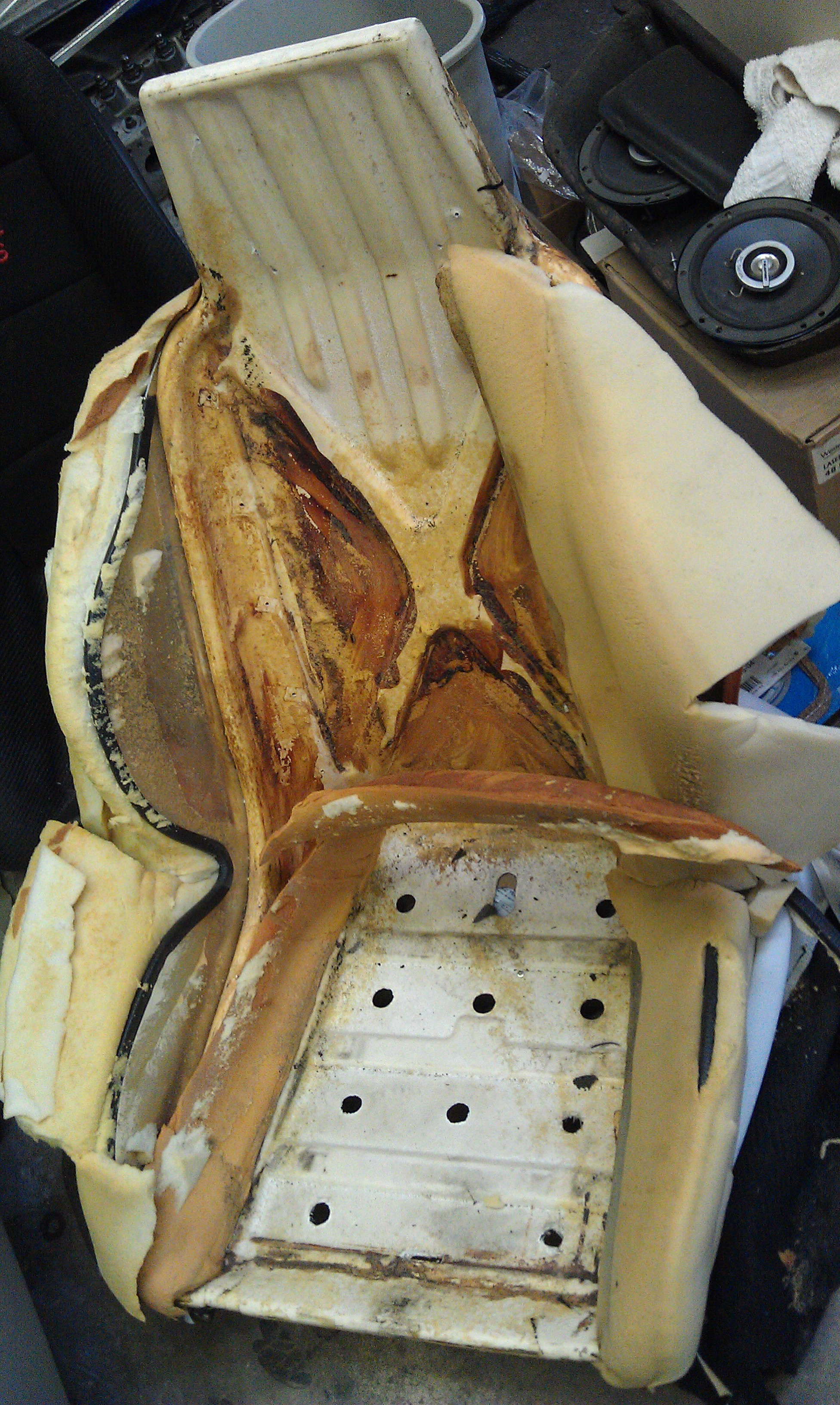

its a real 914 seat with added aluminum "wings" . the wings are riveted onto the OEM FG shell. the attachment point is too weak and the aluminum wing is also too weak. it flexes with ease and the movement of getting in and out of this VERY deep bolster will cause it to break with daily use

ill post photos of the fix. 2 steel wrap around ribs riveted to the FG shell and the wings
epoxy the broken head rest and epoxy teh wing attachment and rivets

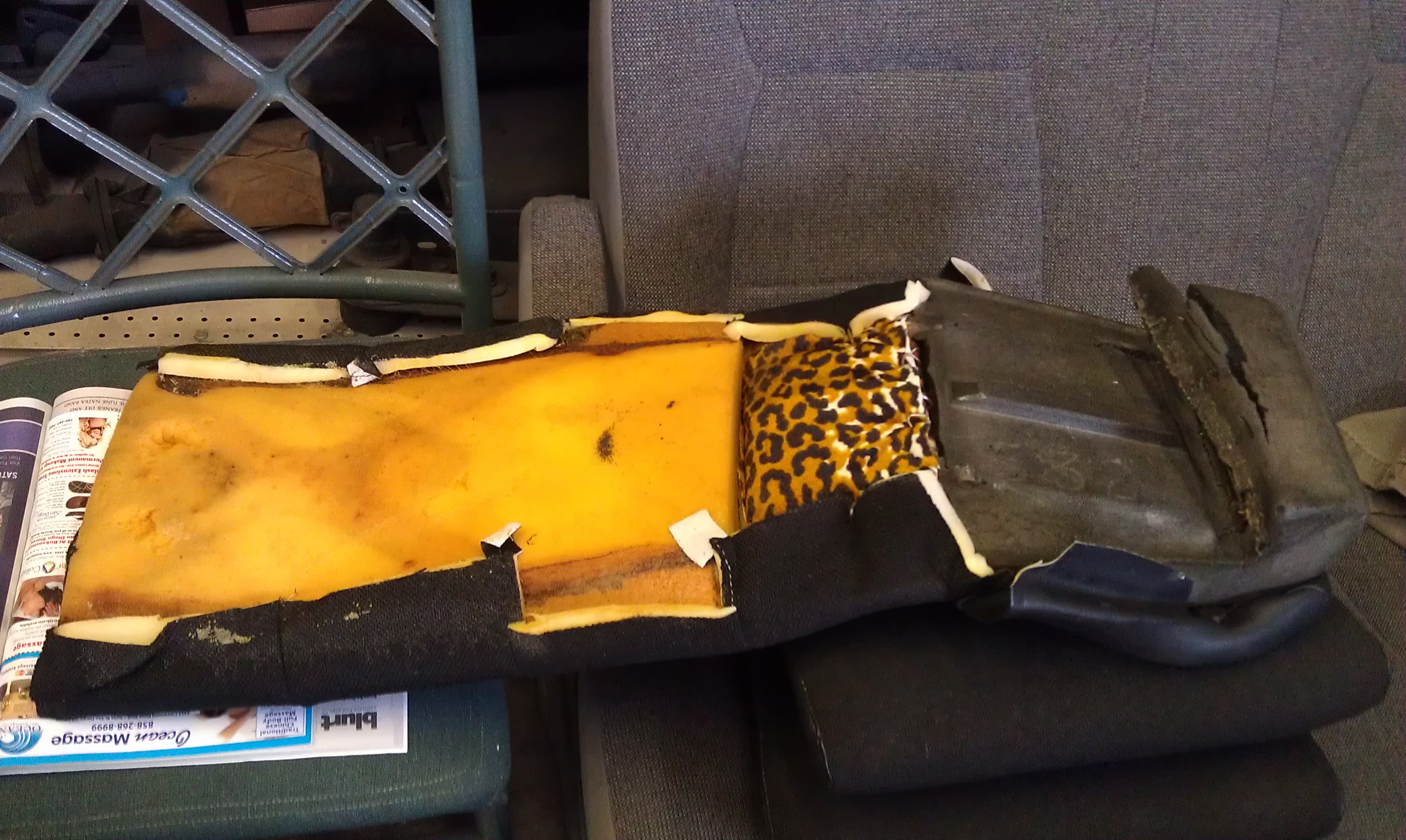

head rest foam block wraps around OEM wire frame. wire frame is screwed to FG shell

wing was 1 pc per side

I wonder if they can do the whole seat in leopard print? (IMG:style_emoticons/default/idea.gif) (IMG:style_emoticons/default/barf.gif)

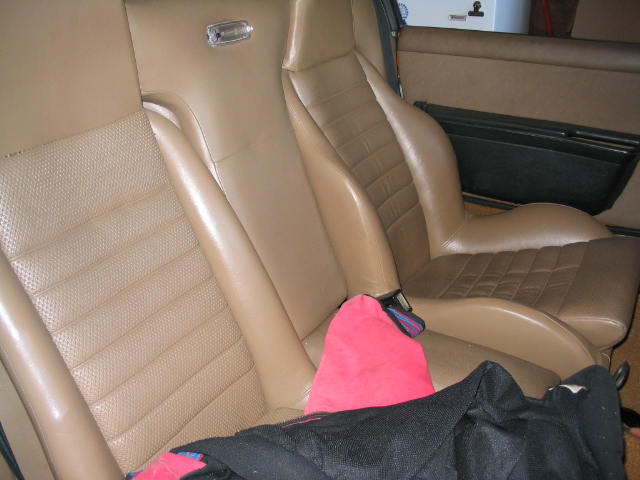

Any decent upholstery shop should be able to build up your stock seats as big as you would like. I had the bolsters built up on mine. Not as big as the Renegade seat but still a nice improvement while retaining the factory look.

^^^ Wow! Those are nice!

Lastly, it is no secret that we use the existing cores supplied by our customers and build the seat as you have seen on this thread. The funny thing is, we had never had any failures to our rivet method since day one that we were aware of. Furthermore, all of us with 914's have 'our' seats and race the crap out of our cars. The only thing that I can figure is the core was brittle due to age and heat, or there was cause for breakage from a hard hit. If the seats were sent back, we probably would have found another core and fixed the issue. We have been known to do nice things for nice people! ;-) (**Toast says its because of Sean's short butt getting in and out of it all the time that it broke. teehee)

Before this becomes a flame fest. These are my seats, and I had asked Sean to take a look at them. The side bolster was already broken when I acquired my car, earlier this May.
Thanks Scott, for standing behind your product, except I didn't purchase my seats directly from you. It came with my car I bought.
What happened to the driver seat? Who knows? It just happened that a question was posted and my seat was torned down for repairs.
