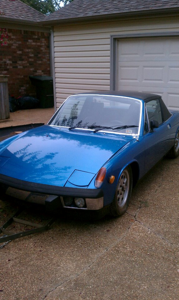

I can hook you up with a one owner (well 2now that I have it) with 39K miles. Needs 2 new front struts and will need paint, even though it looks really good now, to be perfect. All original except carbs instead of fuel injection. I can put injection back on it for a little extra cash. Leaks no oil and EVERYTHING works including the seatbelt buzzer, and the light on the defrost switch. All this for the small price of 10K.

I like the color (looks similar to my Cayman) and the year so it sounds tempting. How's the interior? Looks like you're in Memphis so I would need to get a local PPI and figure out shipping.
