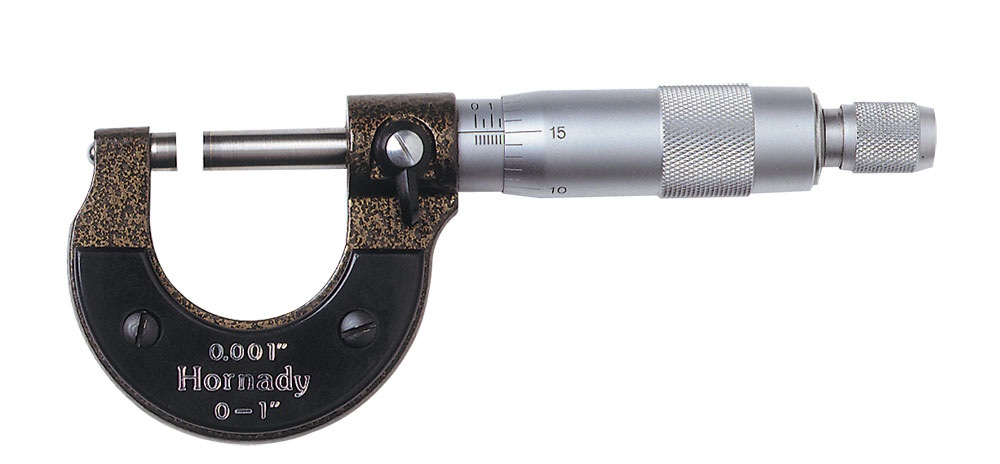

I have several other used shims here but I don't see any thickness or part numbers printed anywhere on these. How do you measure these? L

Theses

Where can I buy this? L

Harbor Freight. ebay. amazon
