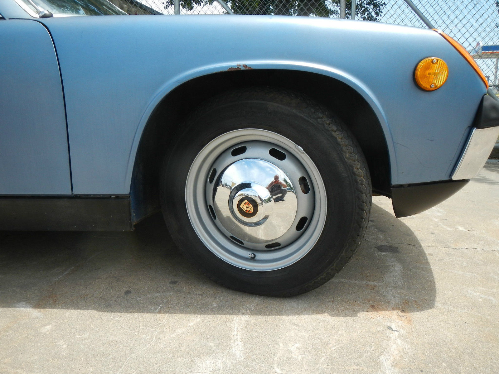

Those are not 356 wheels. 356's never had 4 lugs. I think those are aftermarket chrome rims and caps, mostly marketed at the Volkswagen crowd.
I posted this picture a few weeks back, appropriately in the sandbox, cause I mentioned the similarity to a penthouse babe's nipple..... (IMG:style_emoticons/default/aktion035.gif) probably why I am drawn to them.
1 respond-er said they were 356. I know you can't believe everything you read, but his are not much different...... a bit less nipply, but close enough to fool me.
and you have good eyesight, cause I don't see any lugs on post #1 pic. I would bet they have 4. (IMG:style_emoticons/default/confused24.gif)

I don't need to see any lugs. Porsche 356 5 lug wheels have a raised area around the oval cutouts around the rims. These rims are flat around the cutouts. Another giveaway is Porsche 356 rims have 10 oval cutouts and these only have 8. Pull a hubcap, I can guarantee there are only 4 lugs.
