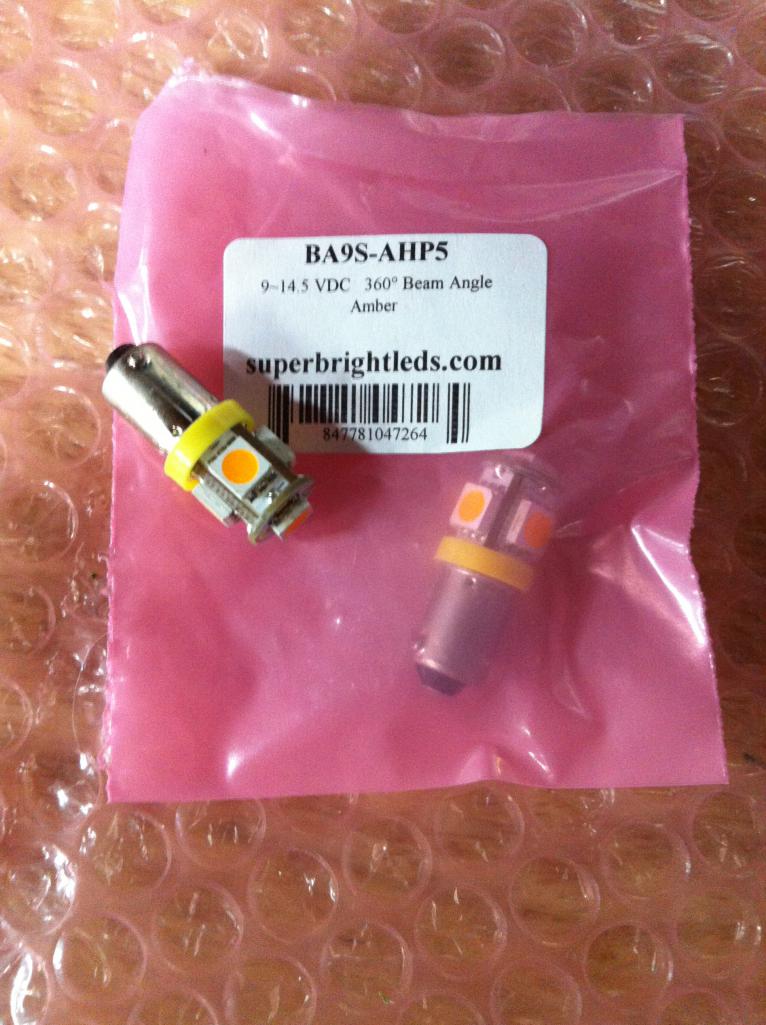

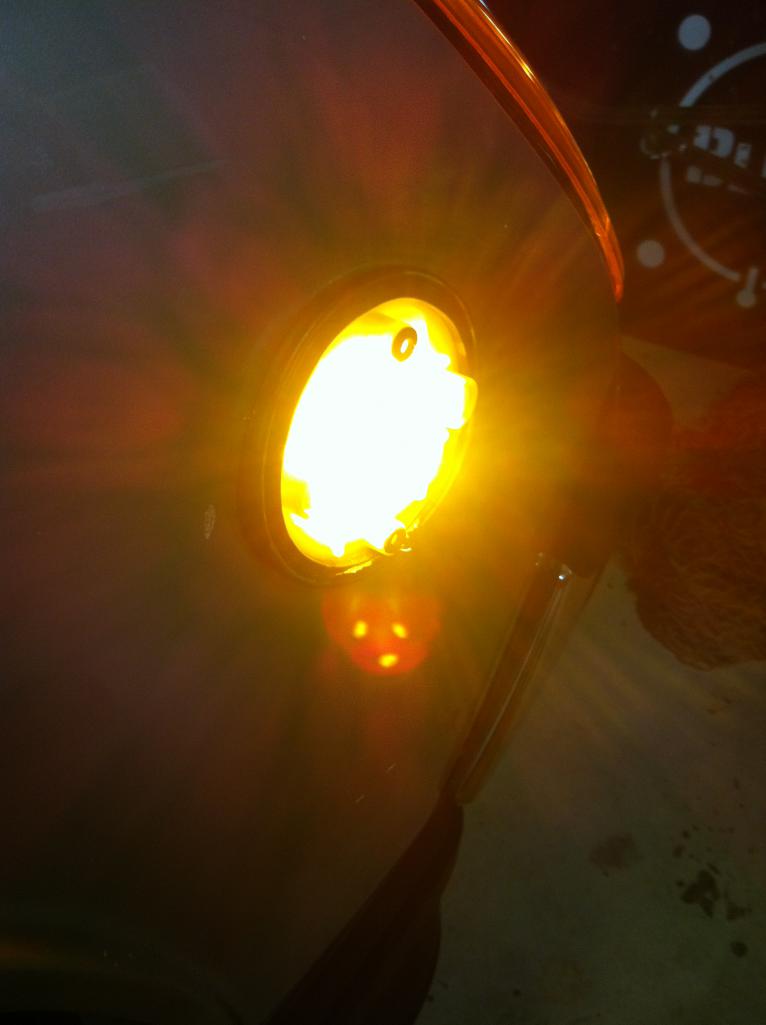

(2) Front side marker bulbs – Amber [BA9S-AHP5] $6.95
https://www.superbrightleds.com/moreinfo/ba...#/attributes/16
They're this bright and that's without the lens attached!

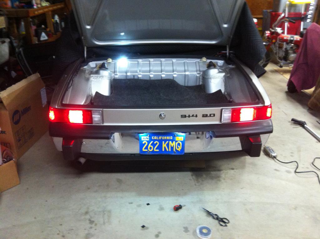

(3) License Plate Lights and Rear Trunk Light bulbs – Cool White [BA9S-WHP9] $9.95
https://www.superbrightleds.com/moreinfo/ba.../#/attributes/1
Left side is the old bulb, new LED on right

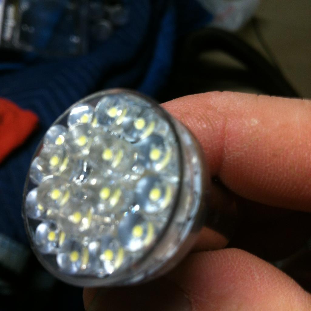

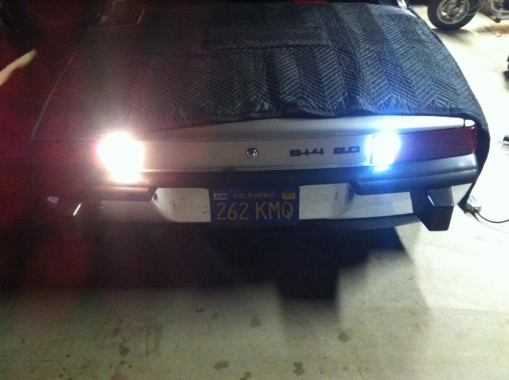

(2) Reverse Light bulbs – 1156 Cool White 100 degree [1156-W24-WV] $6.95
https://www.superbrightleds.com/moreinfo/s-.../#/attributes/1

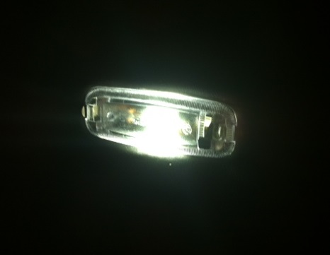

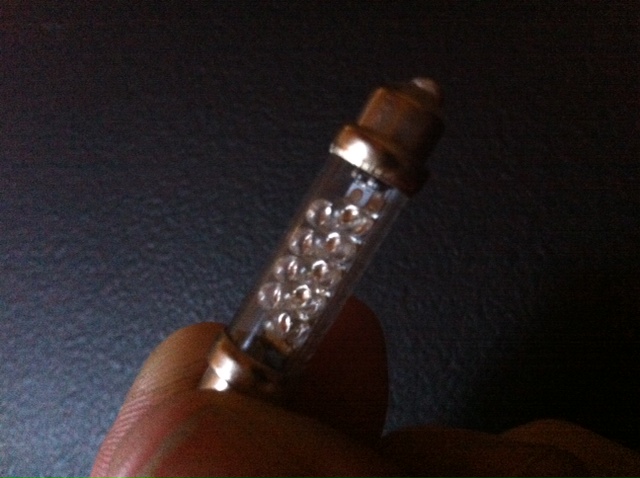

(1) Interior Dome Light bulb – Natural White [4410-NW9] $4.74
https://www.superbrightleds.com/moreinfo/fe.../#/attributes/3
Edit to add pics (IMG:style_emoticons/default/beerchug.gif)
I went with the Natural here because it looked just like "stock" -- I'd also picked up a Red and a Blue bulb, they're cool but dont really produce enough light to use as an effective dome light...If you're just going for looks the colored ones are cool, but for real life use they're going to be kind of dark.

Note brightness of LED sidemarker compared to standard from TS/Marker:
Reverse bulb reference for size in housing:

Rear of car complete:
(IMG:style_emoticons/default/aktion035.gif)
The pictures don't do them justice, they're very bright and clear, great upgrade and overall it took maybe an hour to complete! (IMG:style_emoticons/default/beer3.gif)

Member No.: 4,482
How about the interior light bulb? That would help preserve the housing as well by not producing as much heat.
eric9144
post Mar 13 2015, 03:25 PM
Posts: 2,803
Joined: 30-March 11
From: San Diego, CA
Member No.: 12,876
QUOTE(GeorgeRud @ Mar 13 2015, 01:22 PM) *
Funny you mention that-See Post #5 for the info on that-I actually tested that by leaving the dome light on for about 20 minutes, then popped it out, bulb was cool to the touch!
No more torched dome lights!
