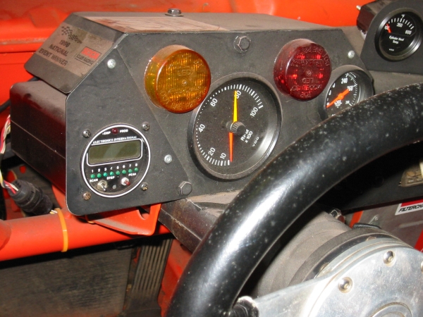

Hello Chris. Thanks for your response. Regarding the nine holes, I was just curious about why they are there. It seems like there would be some function they were the provision for. I checked out one of the vid clips on your site. I'm on a dial-up so the footage comes in the installment plan, just a bit tedious but I'm dying for the view from the cockpit for myself. I took note that it appears you have the stock dash removed completely from your car. I have been considering doing the same thing and just fabricating a small console to house the gauges for the vitals. I never got a clear shot of your instrument panel from behind the wheel, is that the route you took as well? Regards, -K-

I can't tell you what the factory had in mind for the holes, but I am using them in my race car for the oil cooling system in an unusual way.
Here is a pic of my dash.
