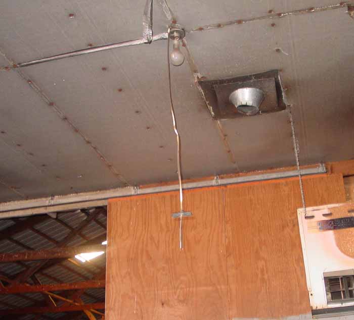

The Arctic winter broke briefly today here, with temps near 60 for the first time since late October. (IMG:http://www.914world.com/bbs2/html/emoticons/boldblue.gif) So, Stef came over and we put the new clutch and trans in. First I went to turn the lights on in the shop. . . nothin? So I open the giant double doors to the Great Midwest NARP Assembly Building, and I see something odd (IMG:http://www.914world.com/bbs2/html/emoticons/idea.gif) Boy, I don't remember that bank of floresent lights leaning up against my tool box. . . .

Ya know, I bet they used to be attached to that strand of romex hanging right there. . .

Which means they probably bounced off the V8 right about. . . . . there. . . . . DOHHHHHHH!!!!!!!! (IMG:http://www.914world.com/bbs2/html/emoticons/ohmy.gif) (IMG:http://www.914world.com/bbs2/html/emoticons/ar15.gif) (IMG:http://www.914world.com/bbs2/html/emoticons/headbang.gif)

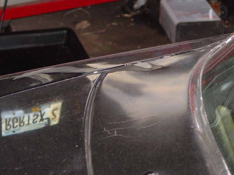

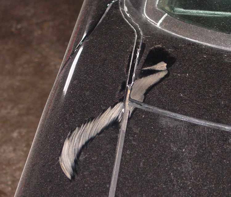

Well, maybe it is just a bad scuff. Yeah, that's it, a scuff. Lets get a look at it from the other side. No, no. That is a nice, sharp, 3/4" deep FRIGGIN' DENT!!!! AHHHHHHHHHHHH!!!!! (IMG:http://www.914world.com/bbs2/html/emoticons/headbang.gif) (IMG:http://www.914world.com/bbs2/html/emoticons/chair.gif) (IMG:http://www.914world.com/bbs2/html/emoticons/barf.gif)

Oh well. (IMG:http://www.914world.com/bbs2/html/emoticons/smoke.gif) I'm calm now. Car needs paint pretty damn bad anyway. I guess I'll just have to get to it a little sooner than I planned. (IMG:http://www.914world.com/bbs2/html/emoticons/confused24.gif) Waddayagonnado.
