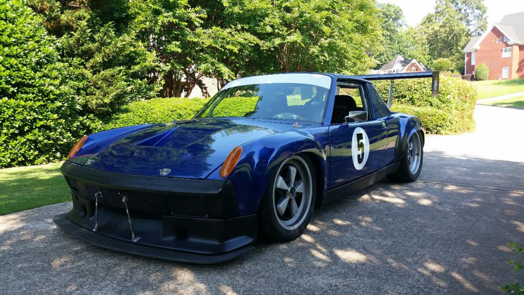

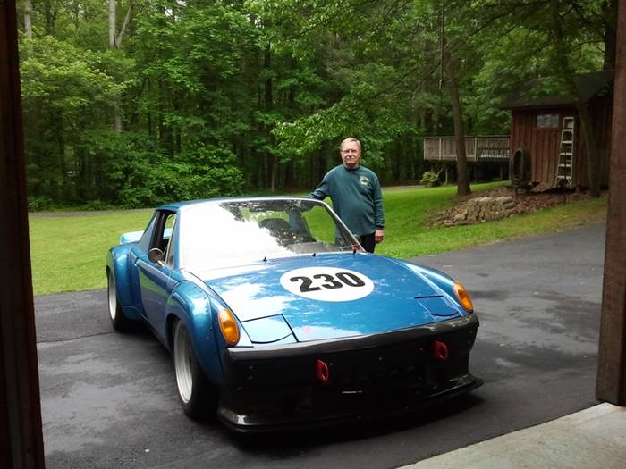

Obviously, there are a few options and what you end up choosing will probably be based upon your budget and time frame (and whether you can/want to do the work too). Definitely use your current car...do you have the skills, time and equipment to install flares yourself?
I have had both glass (I installed - riveted) and currently have steel - I like both but prefer the steel. The down side is that a full exterior paint is most likely necessary or at least easier when finished. Mo-money, mo time.
Glass can be installed and paint matched fairly easily. It took me about 30 hours to hand fit each panel (total time! LOL). The devils in the details to make a glass car look outstanding - fit & finish wise.
Best of luck!
PS: I do like blue..
Tony
STEEL
GLASS (Lewis Broyles - Friend who helped quite a bit on this build)

Tony cracker, I love you man. Your dad is looking svelt.
Ben... it's just flares. You aren't seriously talking wide?

Cracker
post Aug 7 2016, 11:05 AM
Posts: 2,148
Joined: 2-February 10
From: Atlanta (area)
Member No.: 11,316
You are not THAT far from Kent...Billy did a great job on his! Get my drift? (IMG:style_emoticons/default/poke.gif)
Tony
Tom T. - Although all of these type things are a matter of taste and highly subjective - what isn't is what Porsche choose to do, and how. (IMG:style_emoticons/default/beerchug.gif)
I personally do not care for the subtle, non-flare but flared look...just me. I CAN, however appreciate someone else appreciating that style more. Good thoughts and ideas. Cheers!

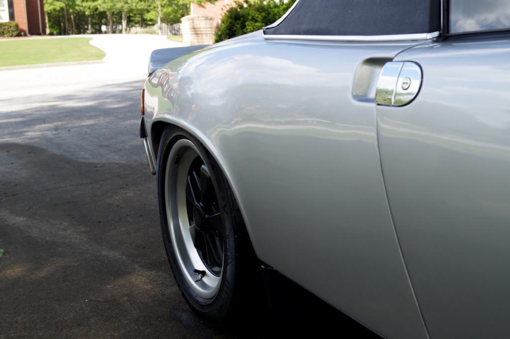

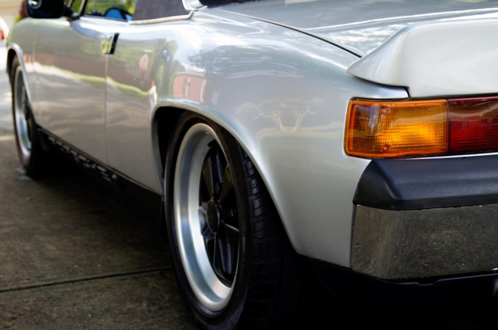

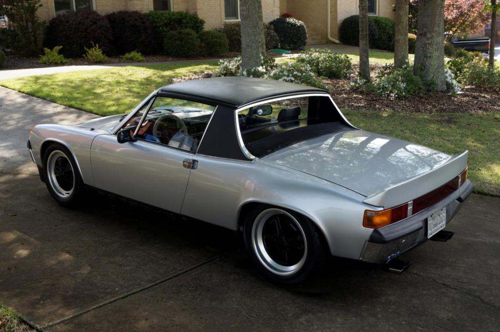

These flares were created by slicing and adding in a bit of metal and then finishing them inside and out. I can get 9x16 Fuchs under them.

Nicely done.

That's a nice look, subtle but distinct. The wheels and tires complement the car perfectly.
