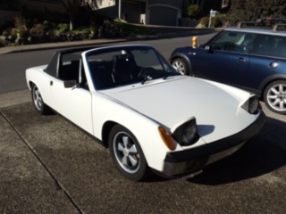

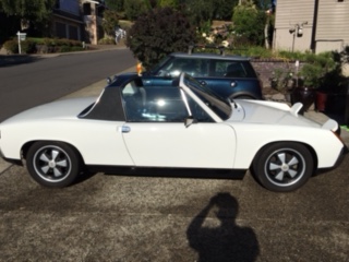

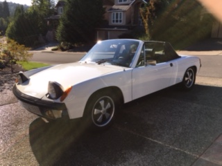

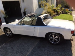

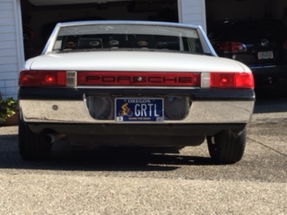

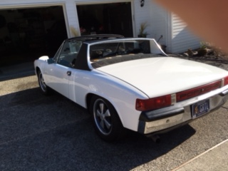

It's been nearly a life long dream to have a GT. I've got an absolutely great car and with the exception of a narrow body, I'd be content. So, I'll add some more content later but the basic question is how do I go wide?
Click to view attachment Click to view attachment Click to view attachment Click to view attachment Click to view attachment Click to view attachment Click to view attachment Click to view attachment Click to view attachment

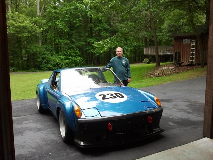

I have had both glass (I installed - riveted) and currently have steel - I like both but prefer the steel. The down side is that a full exterior paint is most likely necessary or at least easier when finished. Mo-money, mo time.
Glass can be installed and paint matched fairly easily. It took me about 30 hours to hand fit each panel (total time! LOL). The devils in the details to make a glass car look outstanding - fit & finish wise.
Best of luck!
PS: I do like blue..
Tony
STEEL

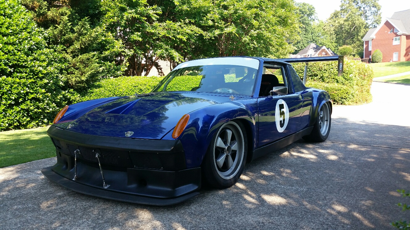

Click to view attachmentGLASS (Lewis Broyles - Friend who helped quite a bit on this build)
Click to view attachmentThis is my dream car jesus, if only it was orange

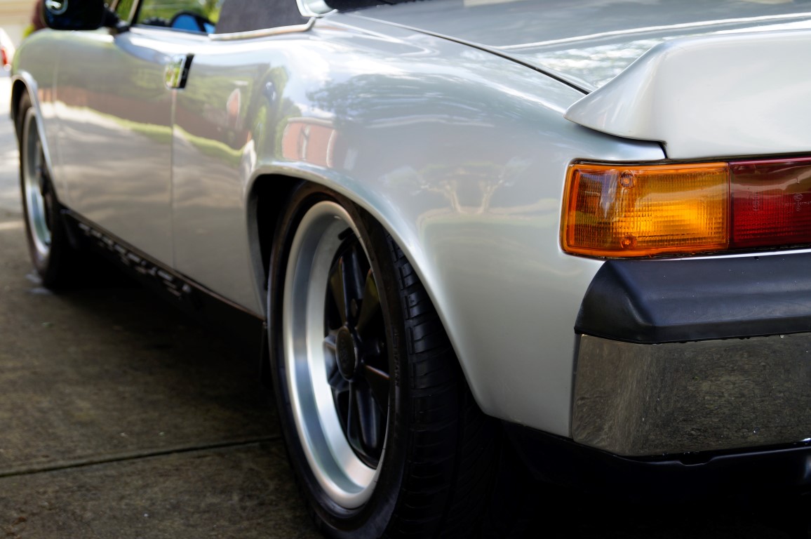

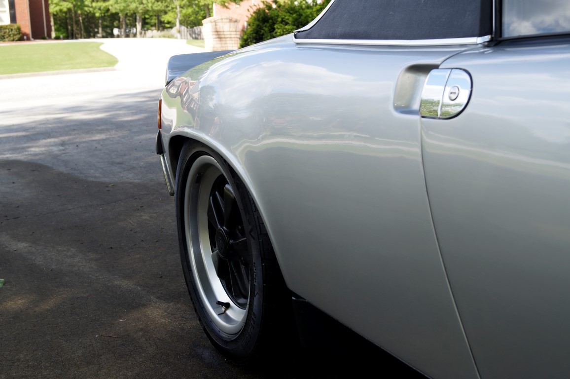

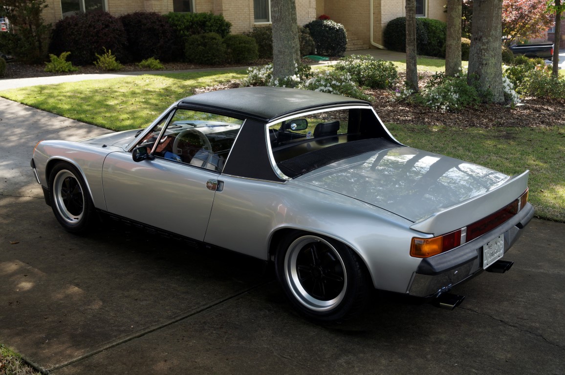

These flares were created by slicing and adding in a bit of metal and then finishing them inside and out. I can get 9x16 Fuchs under them.
Click to view attachmentClick to view attachmentClick to view attachment

If you stick with Fuchs the 7 & 8's will weigh significantly less than stock steel 4 1/2 or 5 1/2 wheels.

"If you do a search here there is a way to do this just banging it out by hanging a big purse filled with sand over the fender.
No cutting needed."
Mark, it is subtle in these photos but I can tell you that it's not practical to try to "beat out" the fenders as much as they are. It really does take adding some metal to do it right.
I have been tempted to go back and try to flare the front somewhat just by stretching the metal but I haven't yet. Subtle flares on the front as well would be nice.

- Yes, 'I gotta go wide?' is a rhetorical question. But, how I should do it requires some feedback. I could use help!
- My skill level; on a scale of 1 - 10. I'm a 0. This isn't something I want to touch at all. I'll call myself a visionary for my ego sake but this is WAY beyond my pay grade.
-Time Frame; it's a lifetime dream and I'm 43 years old. If it takes a year I wouldn't be remorseful.
-Budget; OK, here's the deal. As long as you don't tell my wife... I'm pretty much good to go to get the job done. Now, that being said. I'll shop around and make sure I'm getting a good deal. But bottom line I'll pay what it takes.
-Type of flare; I'm feeling like Steel is the way to go.
-How Wide?; factory specs for a GT. See purist below.
-Purist?; Not at all. Yet, I've seen enough flares to realize that for some reason the factory GT look sits well in my eyes. If they did it wrong or right is all in the eye of the beholder. I'm for whatever reason drawn to the factory look.
-Current car or switch out; Sounds like I'd be better off keeping my current car and modifying. I'll probably post an add on the classifieds just to see if some teener is sitting around with a flared 914 wishing he had a narrow body. Boy...wouldn't that be cool!
-I've got limited space in the garage. Two isn't possible. It's not like I have other toys. I'm not really a car guy or even a Porsche guy. I'm just a 914 guy since I was 18.
-for those not a fan of the GT look; I get it. It's the in thing. It's like being a Lady Gaga fan. You love it but can't help it. Let's face it, the heart wants what the heart wants. That being said, I appreciate the narrow body and all other versions of the 914. But, I gotta have GT at least for some part of my life.
So, where I'm left now is; where do I go and who can assist me in this project? Closer to PDX the better, but I'd be willing to travel if need be.
Thank you again wonderful community!

QUOTE(Reverend Troublemaker @ Aug 6 2016, 06:55 PM)
Obviously, there are a few options and what you end up choosing will probably be based upon your budget and time frame (and whether you can/want to do the work too). Definitely use your current car...do you have the skills, time and equipment to install flares yourself?
Best of luck!
Tony
STEEL
Click to view attachmentWOW..........Tony, love that wing. How can I get one?
Best of luck!
Tony
STEEL
Click to view attachmentTony!
That wing.........cool. Where can I get one?
