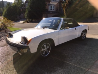

It's been nearly a life long dream to have a GT. I've got an absolutely great car and with the exception of a narrow body, I'd be content. So, I'll add some more content later but the basic question is how do I go wide?

Chris914n6   You're looking at about $1500 for flare b...   Aug 6 2016, 08:16 PM
Elliot Cannon   Fiberglass with "dzus" fasteners. Unles...   Aug 6 2016, 11:58 PM
mepstein   If you have a good car, flare it. There is no reas...   Aug 7 2016, 08:00 AM

Mark Henry   Why not one of each.... narrow and a wide :idea: ...   Aug 7 2016, 08:28 AM
mb911   Flare it as is.. Why try to sort 2 of them out. Un...   Aug 7 2016, 08:42 AM

Reverend Troublemaker   You are not THAT far from Kent...Billy did a great...   Aug 7 2016, 11:05 AM
Tom_T   Hey Ben, Contrary to the "I love 914-GT Flar...   Aug 7 2016, 11:01 AM

db9146   These flares were created by slicing and adding in...   Aug 7 2016, 05:12 PM

mepstein   If you stick with Fuchs the 7 & 8's will w...   Aug 7 2016, 05:54 PM
My 914   That's a nice look, subtle but distinct. The ...   Aug 7 2016, 07:00 PM

Krieger   Live your dream! Go steel and have them welde...   Aug 7 2016, 11:24 PM

sixnotfour   Haters........10 up front 12 rear german steel fl...   Aug 8 2016, 09:39 AM

ben*james   Well - I'm very thankful for the comments you ...   Aug 8 2016, 08:54 PM

JRust   I am not sure if Jerry Mahoney is still doing body...   Aug 8 2016, 09:12 PM

sixnotfour   9.5 and 10.5 911 rsr style fenders :sawzall: :wel...   Aug 8 2016, 10:36 PM

sixnotfour   914 fender tip outs 7/8s   Aug 8 2016, 10:49 PM
sixnotfour   Cary.....old rookie learning fast. going pro... I ...   Aug 9 2016, 08:43 AM

Mark Henry   If you want to see flares done right here's th...   Aug 9 2016, 10:06 AM
Ferg   :idea: I like the idea of the removable glass fl...   Aug 9 2016, 11:50 AM
My 914   I agree. I remember the first time I saw a 914-GT...   Aug 9 2016, 12:44 PM
sixnotfour   roll fatties 15x9 245/50-15 tight on standard GT...   Aug 9 2016, 01:16 PM
