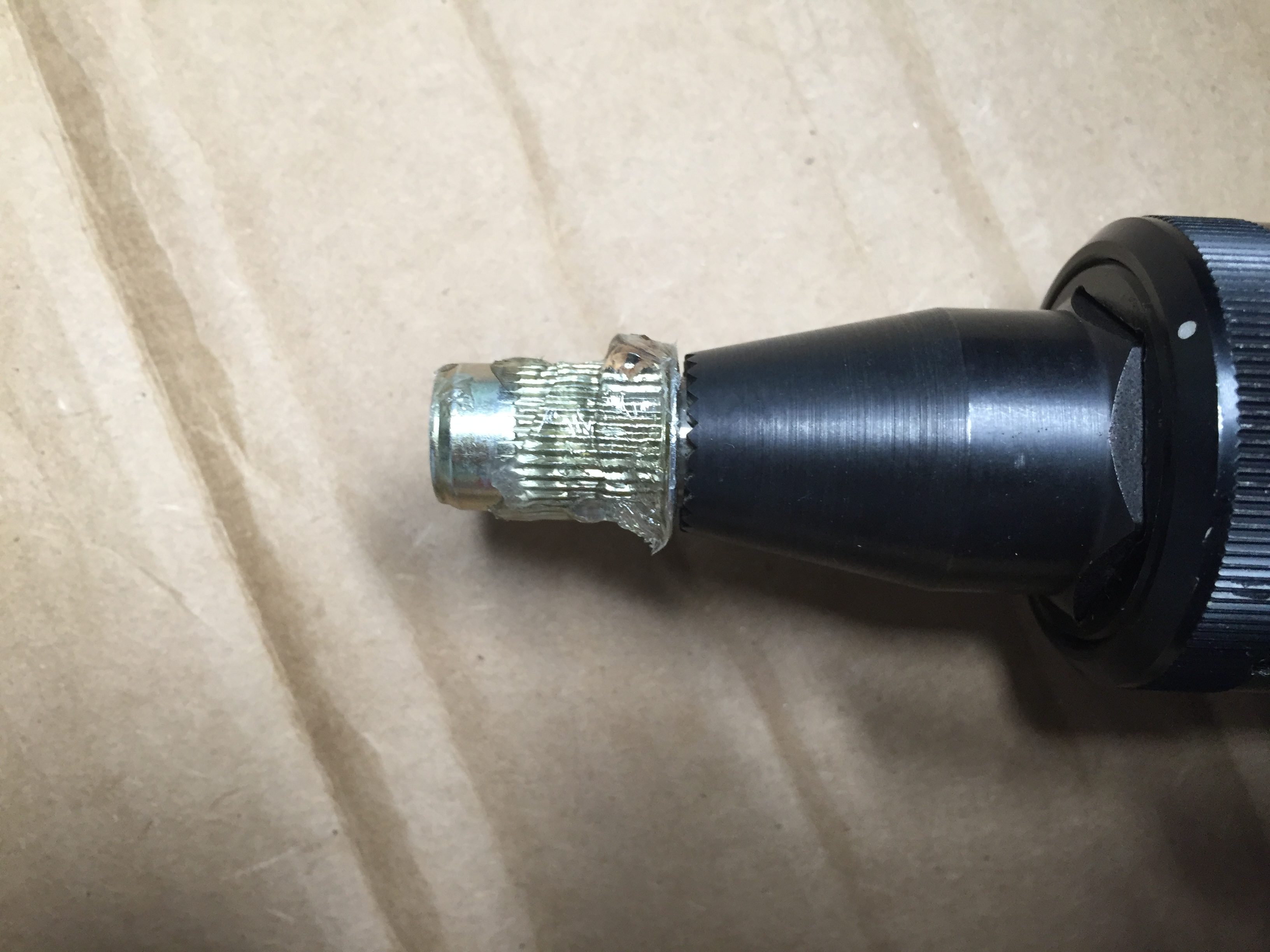

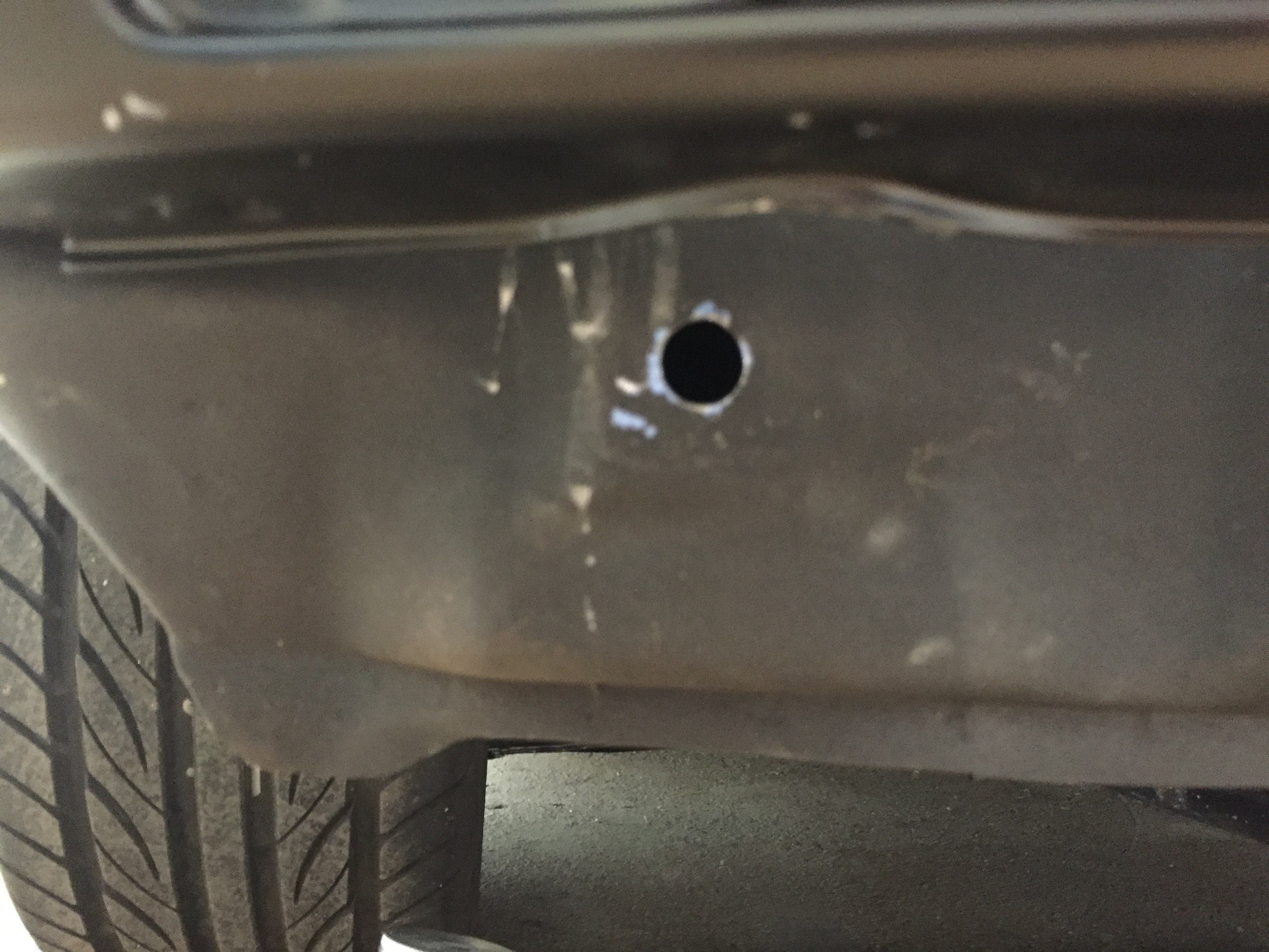

I borrowed a rivnut tool from work to install the Ric nuts for my fog lampsAttached Image
