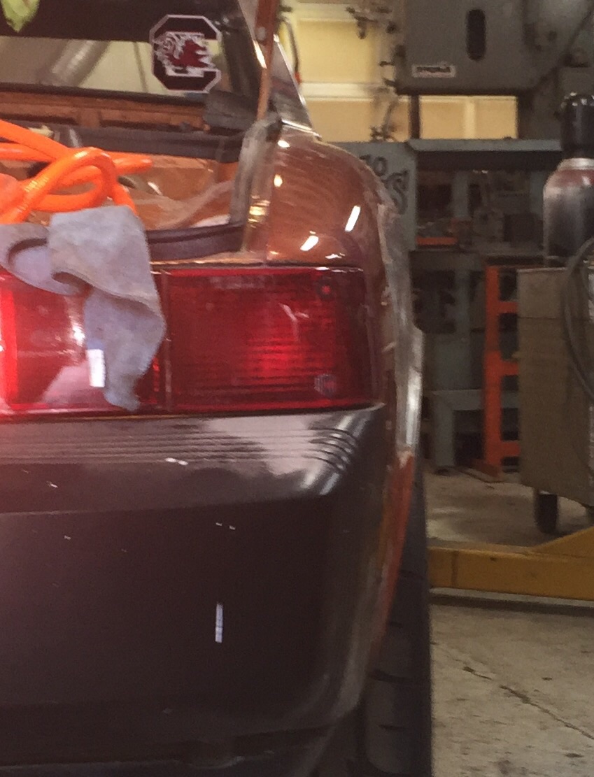

post Sep 9 2016, 07:46 AM
Dr. Phil
Posts: 5,971
Joined: 9-December 09
From: Kennesaw, GA
Member No.: 11,106
This kind is shows the profile after the lip repair and whole fender being hammered out- they are in there but it's really tight- I now regret having tried to fit those 7's in there because the fenders were perfect before I went down that road- I have to live with the consequences and $$ it cost to rectify- and I almost just said screw it and put GT flares on, wold have probably cost about the same considering the $$in shop time by Chris and the gang trying to fix straighten make room for the 7's- but I was talked out of doing that being the car is mostly original 2.0 matching # appearance and a rare color-
Chris did a great job on your car, they still look very original whic is what I was after too.
Have you tried to see how 7" 16's fit? You could or ably put some small spacers on to use up the rest of the space with our risk of rubbing
