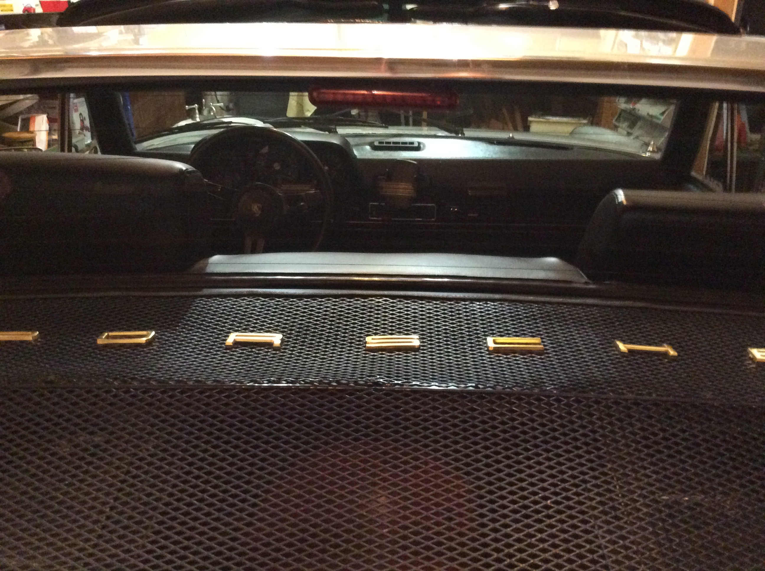

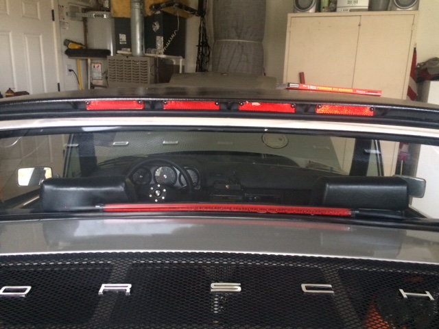

Here is my application with a 2 foot strip inside - upper four short strips are reflectors.

QUOTE(Keith914 @ Apr 27 2017, 08:00 AM) *
Oops! here it is.

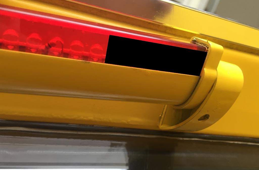

A solution to cut down on most of the unwanted light energy is to block off the top and bottom of the lens like shown below. Either with paint or tape. This will not diminish the light output to the rear but will cut down on the extraneous light coming back into the cabin.

In my case there is no negative impact on my rearview mirror images - no issue.
