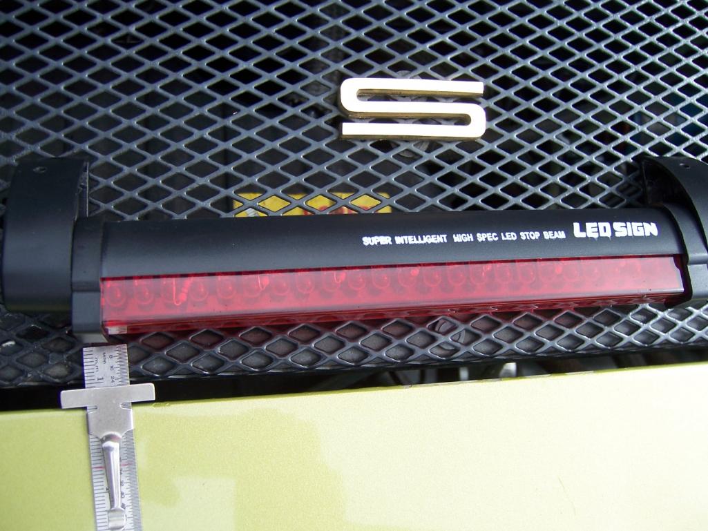

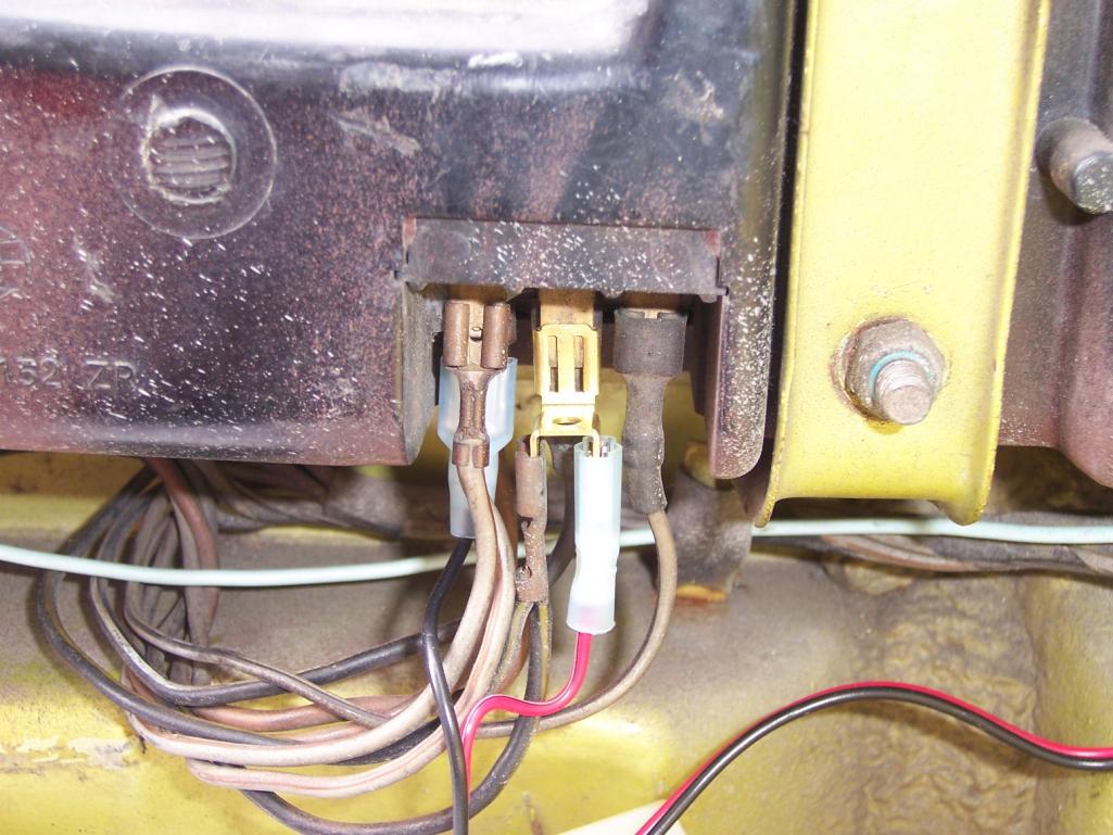

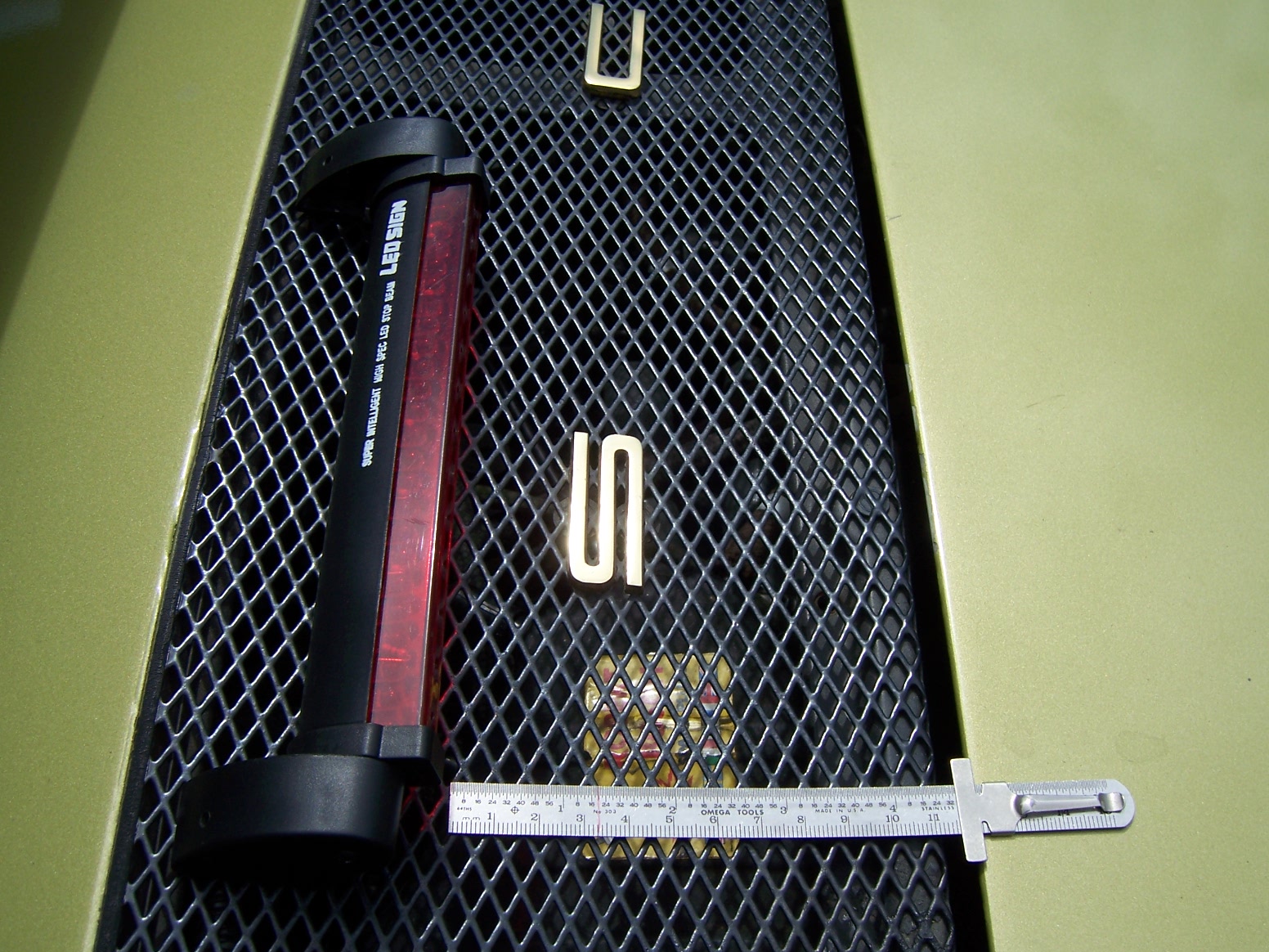

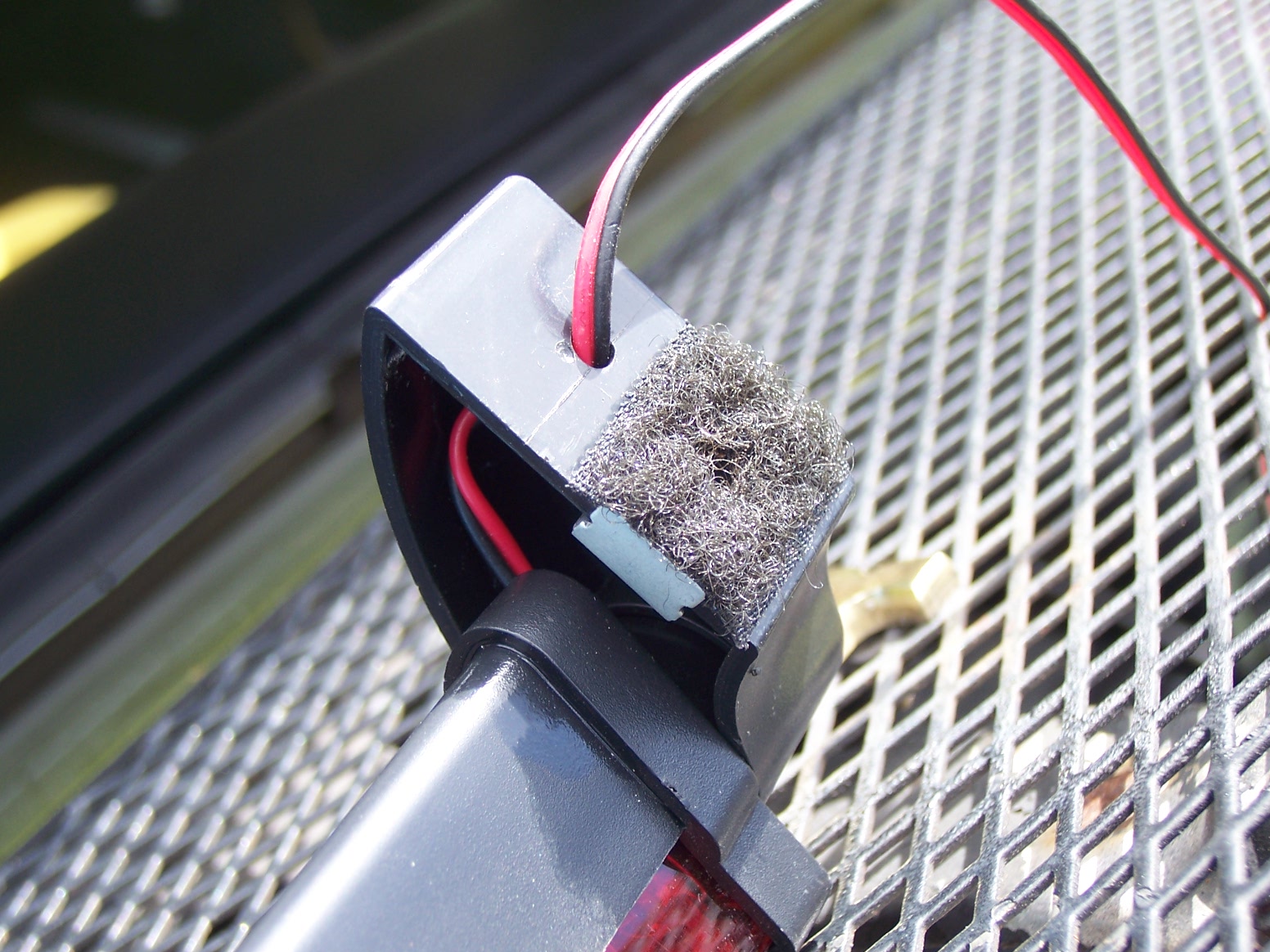

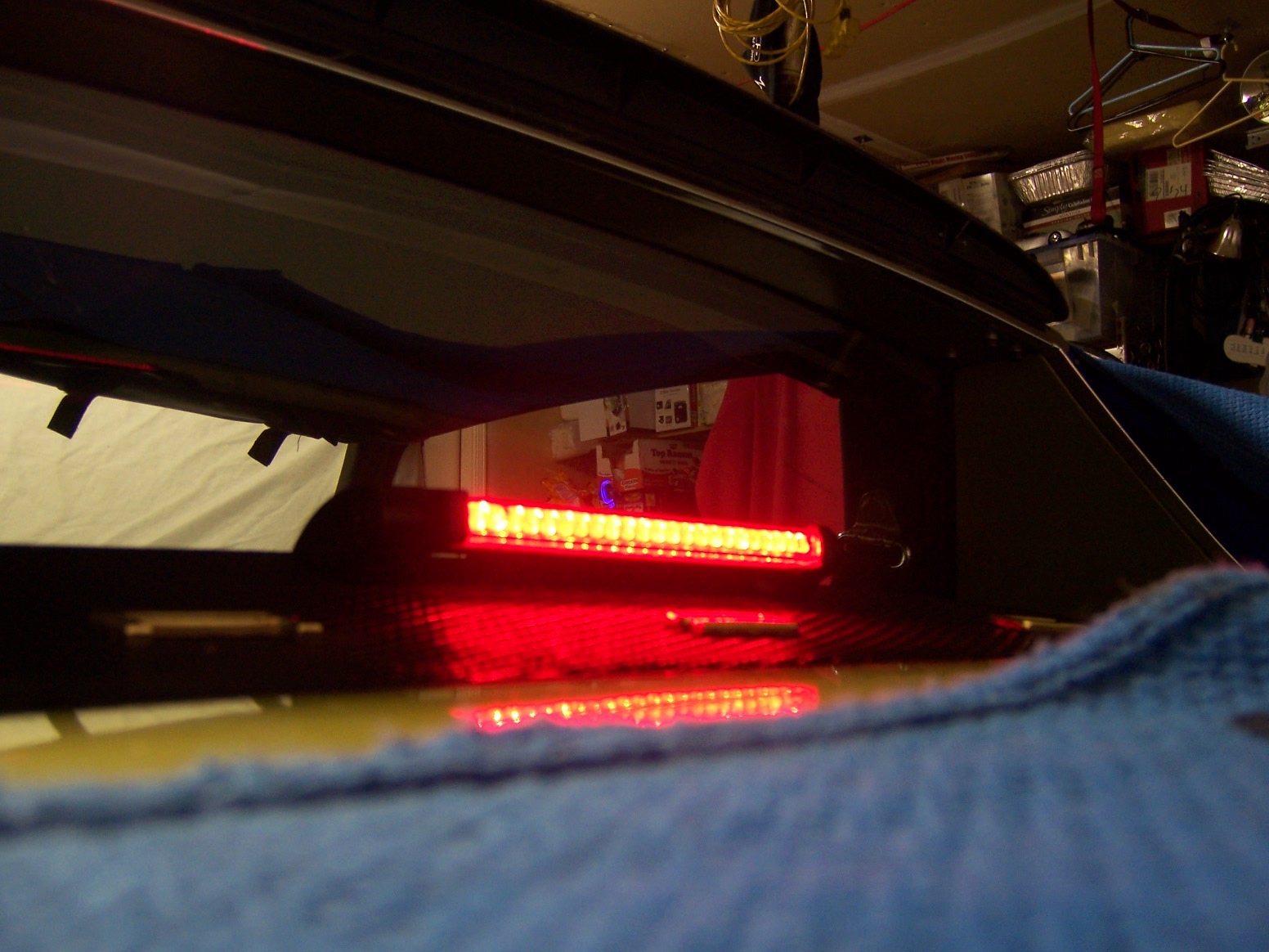

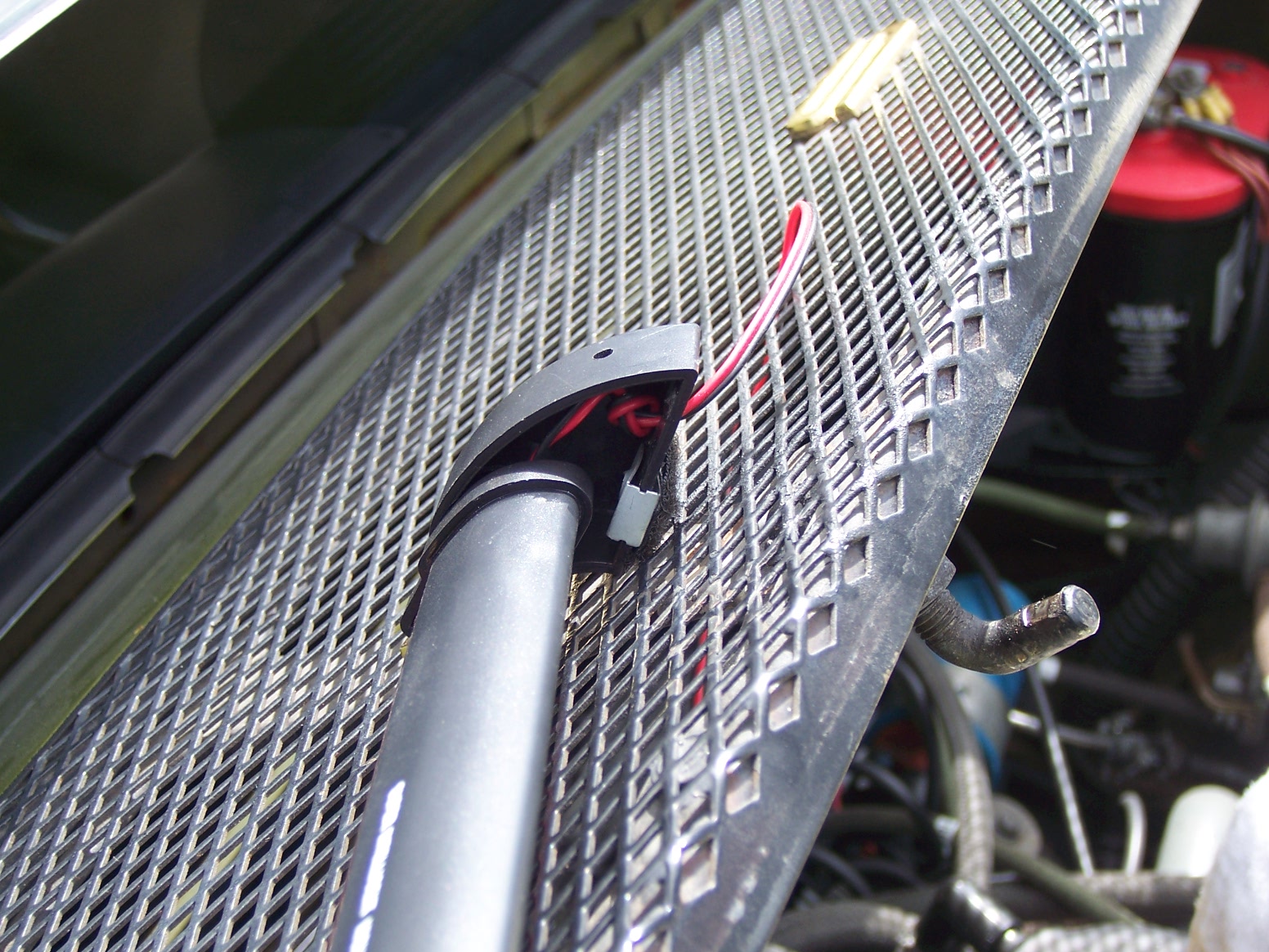

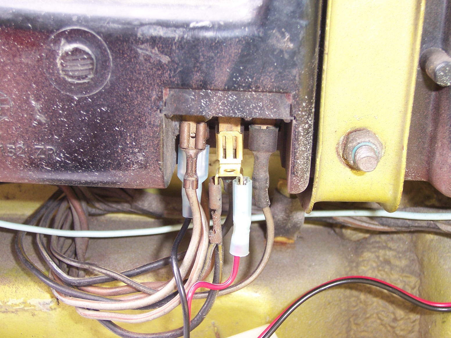

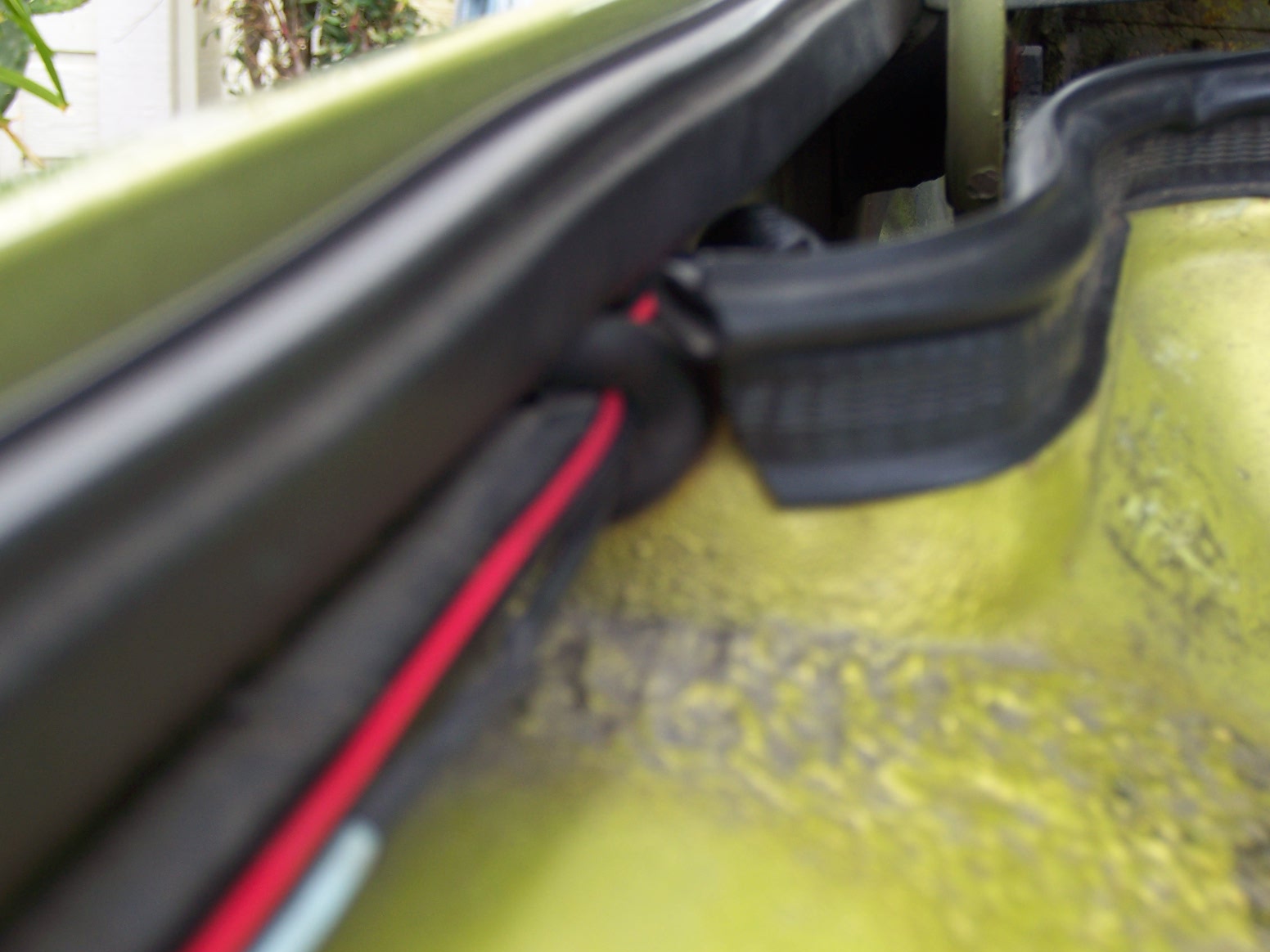

How many of you are paranoid of being rear ended? I certainly am. Here's my installation of a 24-LED brake light that I installed with a few bits from my workbench. I got this 24-LED from a Bang Good.com. That website gives free shipping. The current model is on sale for $5.19 and that model is SKU010514. I bought the 24-LED version, which they no longer stock and it cost me $4.55. Its $7.49 at AMAZON. NO RELAY OR OTHER ELECTRICAL PARTS NEEDED. I know I have seen these in the FLAPS for at least double or triple that. Anyway, as long as you can wait a couple of weeks, you can either buy it there or go to the FLAPS. I finished the install last night. This morning when I went to open the rear trunk, I see that I should installed the light closer to the rear window. Almost tore the thing off! Pic one shows the wrong way to do it. Pic two shows the wiring from the left rear tail light housing. I put on brass spades (get from FLAPS) that sisters the existing connections and no OEM wiring was cut or spliced to do this install. Pic three shows routing for two leads into the engine compartment into the engine compartment. Pic four shows how I drilled the plastic with a 1/8" bit and threaded the wiring. I also used speed clips (from car speaker install kits) and you see the galvanized metal in the pic. I stuck a patch of velcro as a vibration pad. Pic five shows the velcro in place. I also added a flat washer and a lock washer when I screwed it into place. Pic six shows the completed installation. I also covered the entire wiring in small plastic tubing and zip tied everything in place, leaving a large loop of wire so the engine lid can be opened. I considered installing this under the targa bar, but routing the wire would have been too much work and I did not want to use the double sided foam tape that came with the light. This install can quickly undone with a pair of dykes in a few minutes.

I think it would look better forward of the grill

Cool job.

really like how did the wiring, with nothing cut... very clean. I think I would like to figure out how to mount to the underside of the roll bar, but I think its a very smart idea to have a third brake light on these cars.
Great job! (IMG:style_emoticons/default/beerchug.gif)

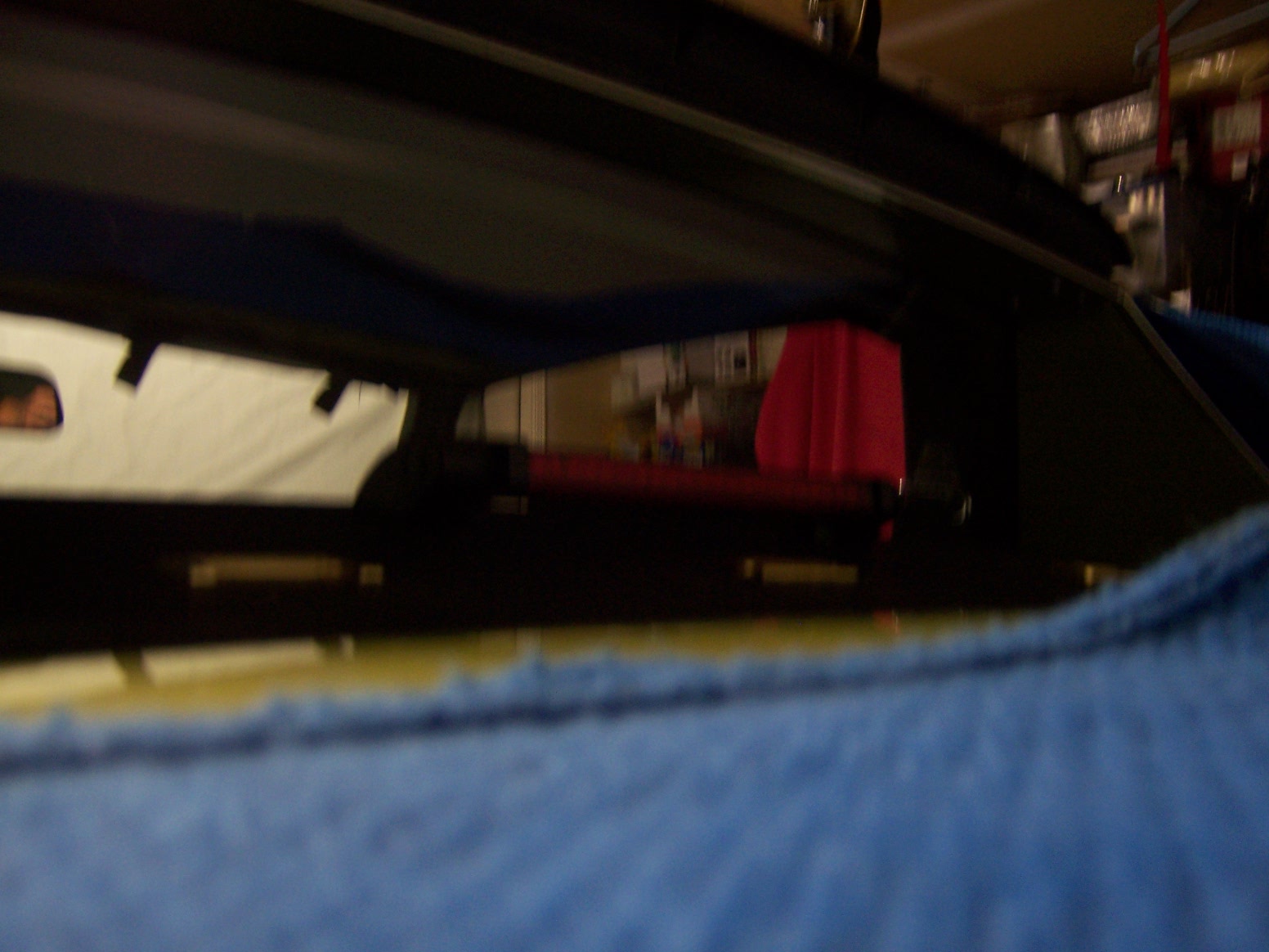

So does it work???
Show me the RED!
dangrouche
post Jun 15 2013, 11:44 PM
dangrouche
Posts: 550
Joined: 1-May 04
From: San Francisco Bay Area
Member No.: 2,012

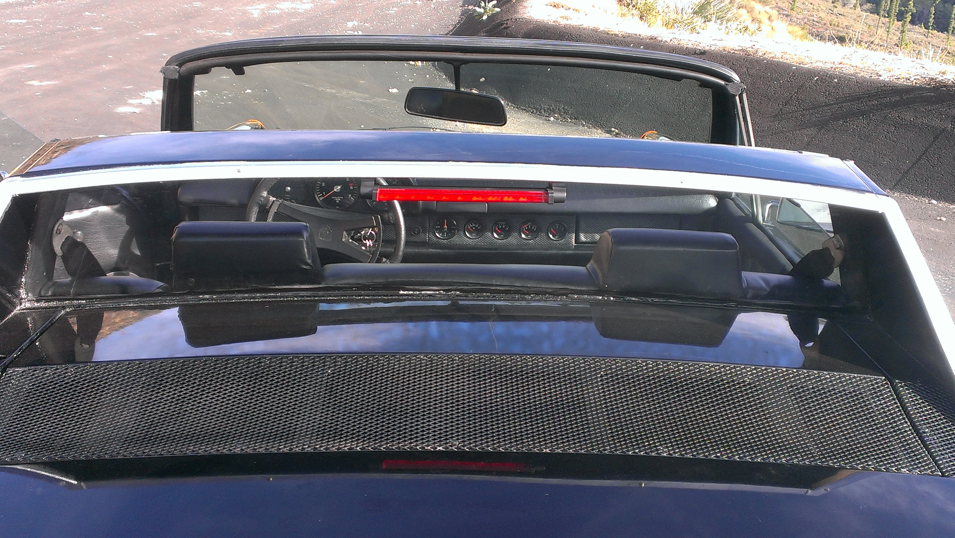

okay, no one around to help me step on the pedal, so I had to put on self timer, one blurry and the other lit up

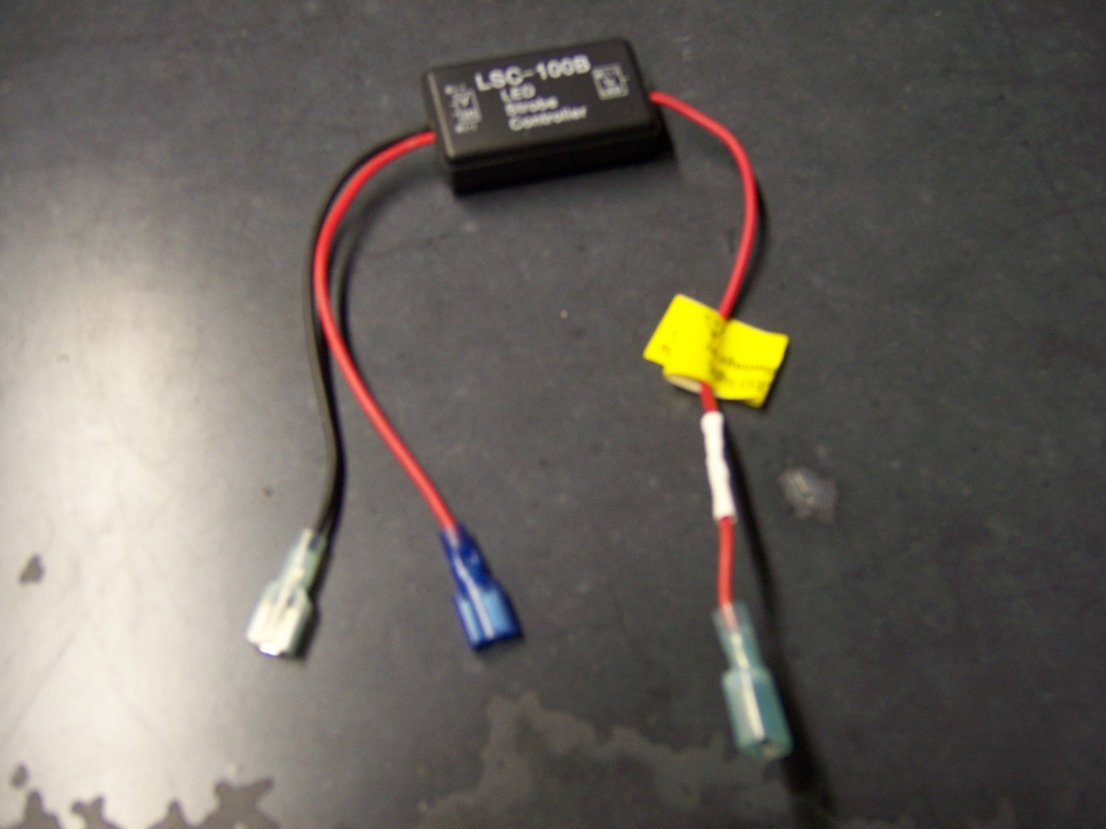

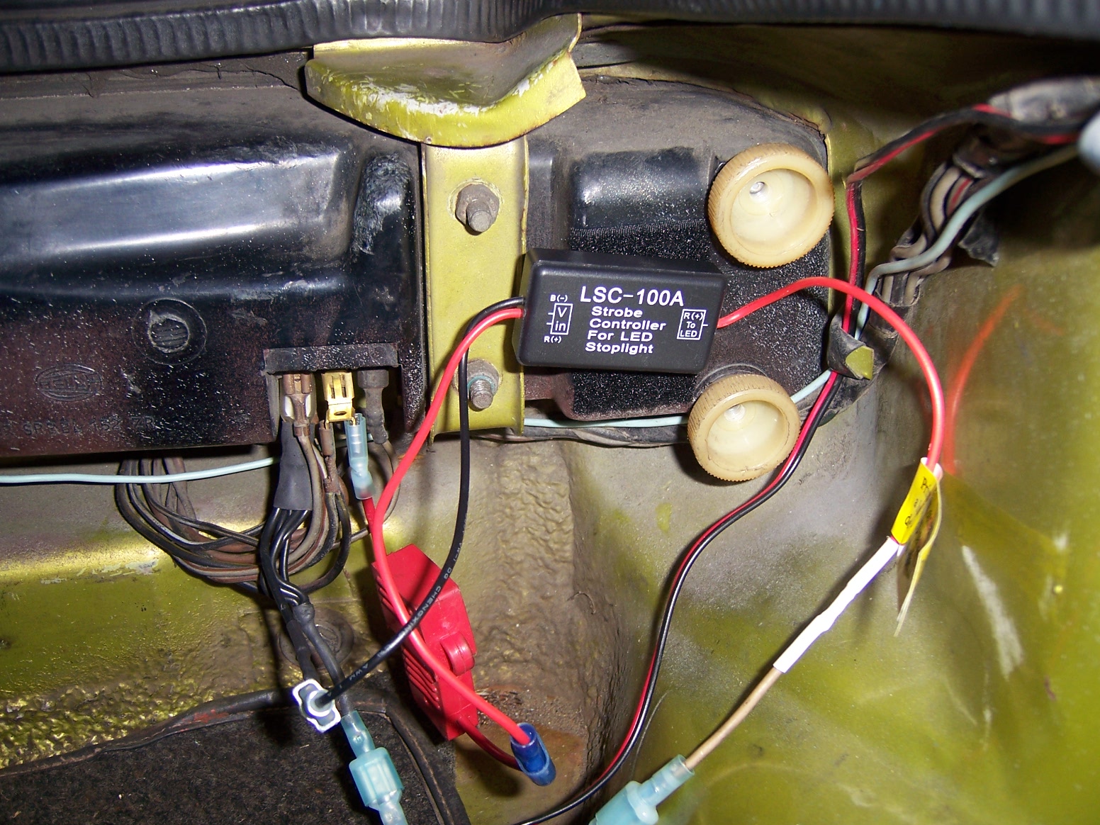

I added a $5 strobe flasher to my 3rd brake light set up, so now the 3rd brake light flashes in a pulsed manner. I bought the two models of the flasher module from superbrightleds.com, model LSC-100A and LSC-100B. LSC-100B gives you continuous flash pulsing as you step on brake. LSC-100A gives a few strobe pulses then brake lite stays on solid. I put on push-terminals so I when my mood strikes, I can change the mode of the flashing. Sorry, I don't know how to attach a video file of the actual light flashing. You will have to look up a youtube search at the vendor website using the model numbers discussed above and you will get an idea of the flashing mode outputs. (IMG:style_emoticons/default/smile.gif) I added a fuse assembly as well. Wiring is simple, two grounds off of the left terminal, the hot terminal off of the the light housing feeds the strobe unit black lead, and the red lead exiting the strobe unit connects to the hot feed to the 3rd brake light. Attached Image Attached Image

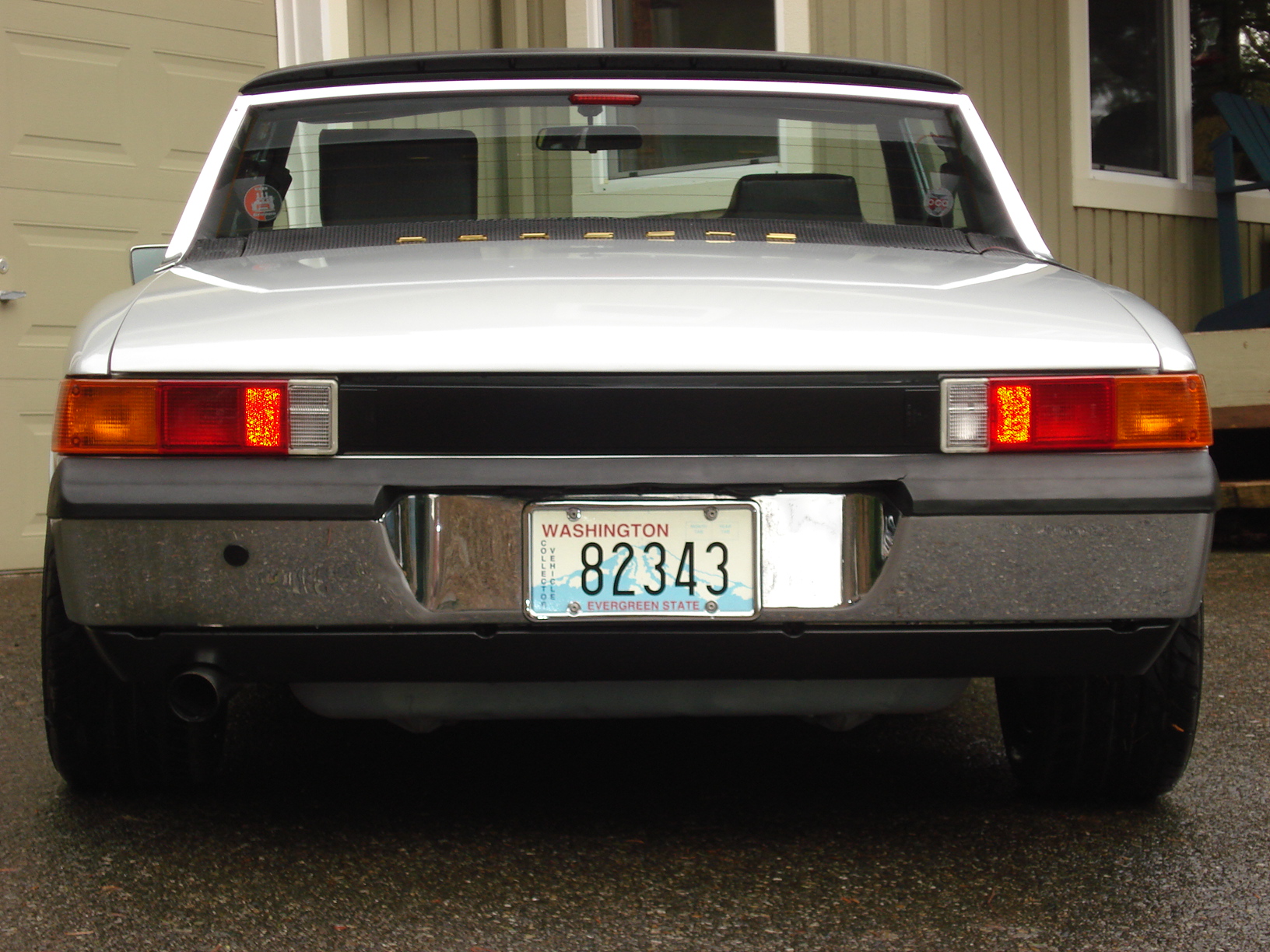

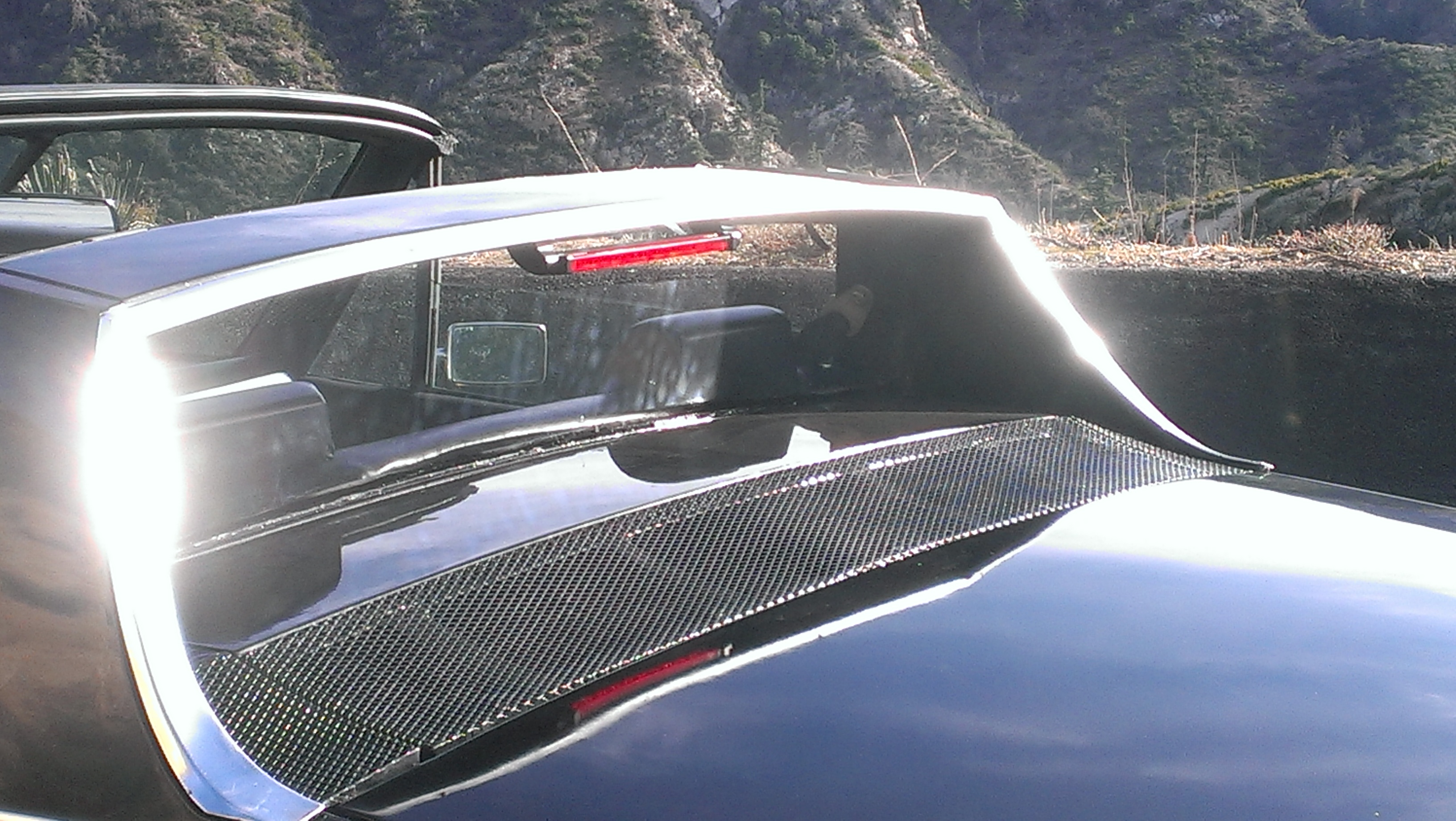

Nice work and yes I am just as paranoid adding a high intensity strobing stop light from a motorcycle lighting company (4 pulses and then goes solid). I took a little different tack and mounted it under the top edge of the roll bar.
Great job and paranoia works since I mounted the same in my 82 SC

Nice work, and thanks for the tip on the LSC-100A . . . I need to look into that!

Hi Steve thanks for the kind words.
This is the source and a video of the compact but bright flashing LED brake light. I did not use the red wire for the running light, only the flashing brake: Knight Rider Non-Sequential LED http://www.customdynamics.com/knight_rider...l_led_video.htm
I used Dan's wiring method to the tail light and then discretely popped out the wires though the fixed wing of the engine grill next to the targa bar. I then removed the targa chrome trim and ran the wires under the trim and popped them out in the center of the bar - since it is very low voltage, I used a thin gauge speaker wire.
The light indeed is attached by 3M double stick tape.
The cost was $30.00 but felt that was cheap to save my ass. Here is the link to the page for the NON-SEQUENTIAL DUAL INTENSITY (not yelling but they sell several types). Scroll down around mid-page: http://www.customdynamics.com/knight_rider_led_light_bar.htm

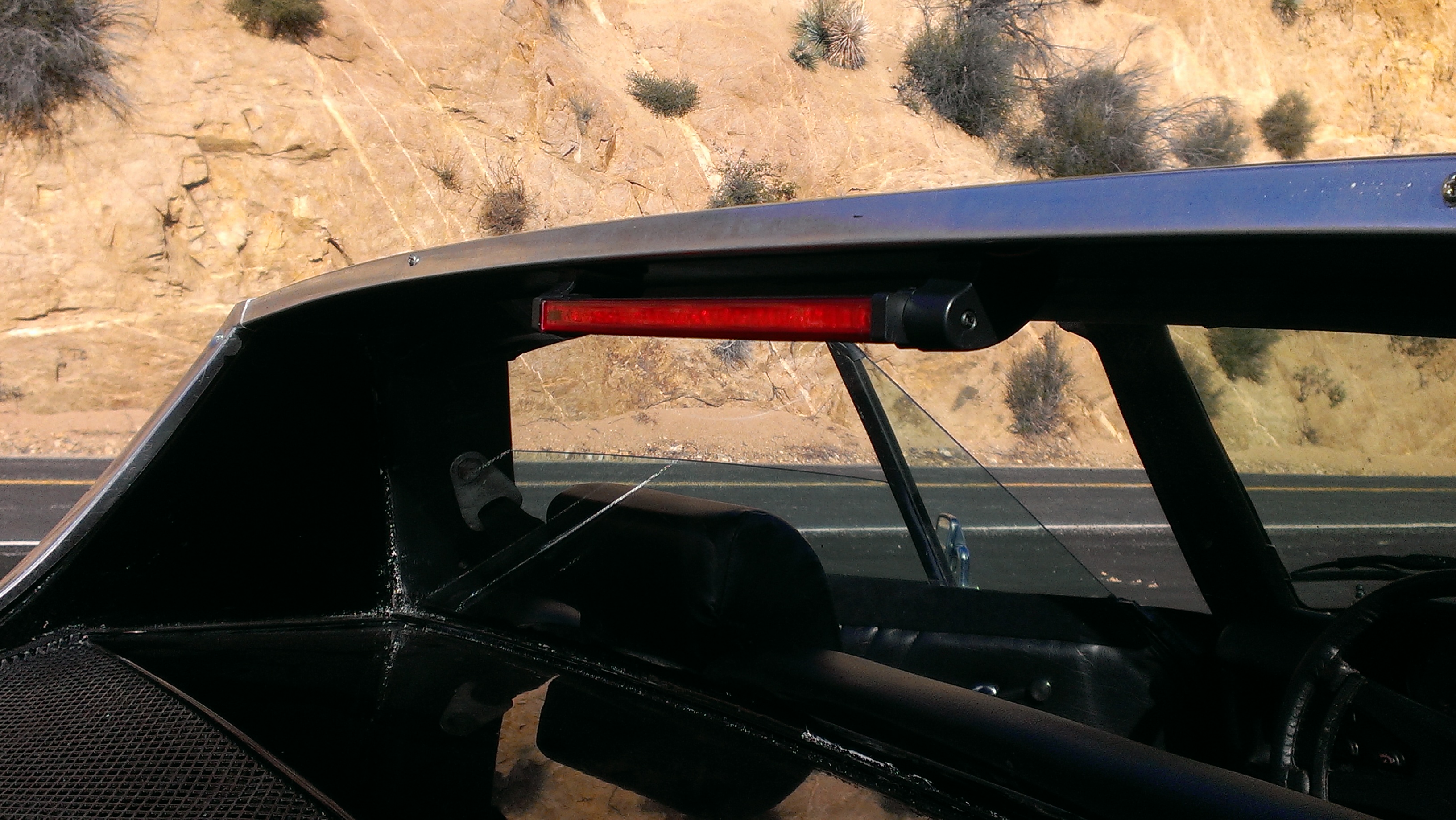

I had an extra...10 minutes...to this and did it with a minute to spare.
"NO EXCUSE GUYS...BUY THE LIGHT AND PUT IT ON!
Take one more factor out of someone hitting you.
I mounted the same $5 ebay light under the targa bar. Light is stick on and it sticks ok so far. Since the light mount is a bit of an angle the lens extends further back than the targa so at night you see more red...plus it can be adjusted.
I mounted just behind the chrom trim and tucked the really thin wires under the trim and down the sail panel trim...didn't remove the trim, just loosened a little to slip the wires under.
Into the side engine grill and under into the trunk, etc. like described in the above posts...invisible.
No pulse yet but I do notice (in daytime) that drivers behind me brake sooner. and keep an extra foot or two open after they stop. Maybe my perception is (IMG:style_emoticons/default/blink.gif)
