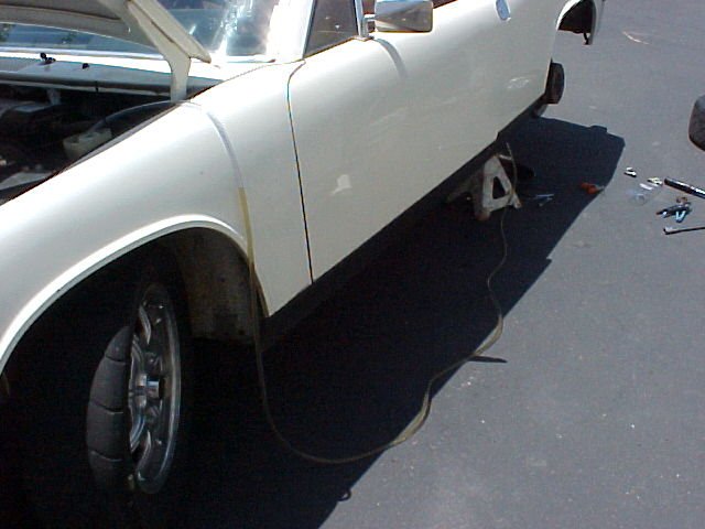

Here it is, the moment you've been waiting for.
You'll spend more time taking the wheels off and on, if you do this!
Install Speedbleeders.
Put 10' long clear vinyl tube over the bottom bleeder on the right rear.

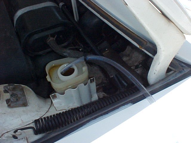

Drape hose into brake reservoir after flushing system and secure with a zip tie.
Crack Speedbleeder 1/4 turn and pump until you see the bubles stop going by.
Tighten speed bleeder and move to upper bleeder.

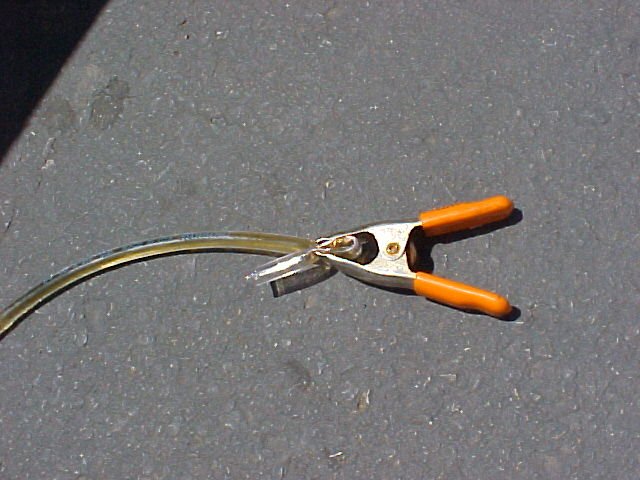

Fold hose over on itself and secure with a clamp between calipers to keep the prime in the hose and avoid making a mess.
Repeat for left rear, right front and left front.
This is *TOO* easy.
KT

After the fluid starts going into the reservoir, stop and top it off with about 4 onces of brake fluid.
This will be the last time you will even have to check the level again during this process.
Every pump puts *exactly* the same amount back in the resi. (IMG:http://www.914world.com/bbs2/html/emoticons/wink.gif)

The long hose will reach all valves and pass by the drivers's door so you can watch the bubbles stop.
Bleed off *all* the valves or you *will* have *some* air left in there.
Why not spend the extra five minutes and save yourself the headache of having to do this all over again beacuse your pedal is still mushy. (IMG:http://www.914world.com/bbs2/html/emoticons/ohmy.gif)
KT

Clamp it!
When you are all done, just throw away the hose if you're worried about making a mess or damaging your paint the next time around. The hose is about $1.50. (IMG:http://www.914world.com/bbs2/html/emoticons/wink.gif)
