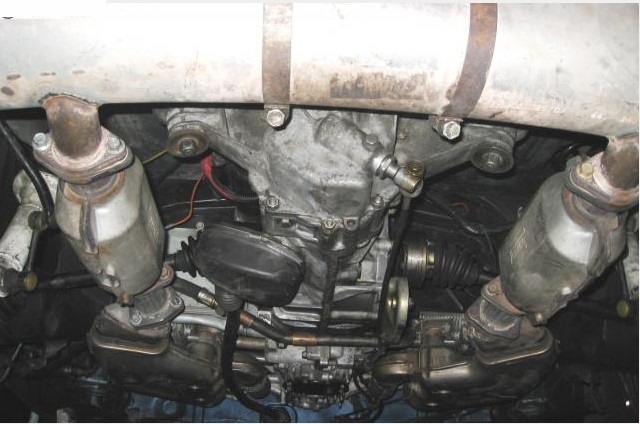

I’d like to see how they used the 993 heat exchangers and I wish we didn’t need to deal with this coronavirus because I’d love to help you sand down that body.

Picture of the 993 heater boxes.
The heater works really well, nice clean heat. Very good airflow.
If you look closely, notice there's no 914-6 bulkhead or cross bar. He modified the 911 bar and put mounts on the engine bay shelves. I'm eh about it, he reinforced the shelves and it looks okay. But I'm pretty certain I'll install a bulkhead mount.

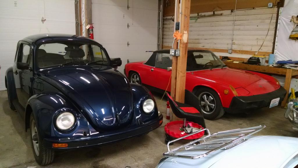

With building a house as my first priority, I'm not getting anything done on the 914-6 other than order up some parts here and there.
I drove it again last week and oh-boy, that is one sweet engine! With CIS, CATS and hydro-lifters, I'm certain the 2.7 isn't living up to it's potential. But it has plenty of power, very quiet and the heat works so fast and so well.
Here's a picture sitting next to my Bug:

I'd like to see more pics of the exhaust when you get them. 993 shouldn't be that bad for flow, Porsche was getting better with exhaust systems by then. That size of cats and they're away from the engine, hot but shouldn't cause issues.

993 heat exchangers work great.. They are not equal length but they are 1.625.. I ran these on my 911 turbo 3.2 short stroke build.. Worked really well.
I would highly recommend running the mad dog factory style bulk head mount. It allows for the most clearance every which way you look at it.

QUOTE(mb911 @ Apr 8 2020, 02:28 PM) *
@mb911 I already purchased your regular 914-6 bulkhead mount. Will that work with 993 HX's? If not, maybe I need to upgrade to the factory style.
