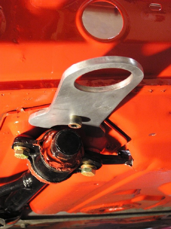

My BB does not have a front tow hook or loop, evidently it was sacrificed when the A/C was installed in 74. I would really like to put a ring on the front somewhere and the front subframe mounting point seems to be a great spot for this.
I've seen pictures of 914 track cars with a loop at that spot. anyone out there know where to source one of these?
And then, can I just remove the subframe bolts to mount the ring without the torsion bar ruining the day?

yes you can do that - just look on any site that sells racing parts - most race venues require them - usually they will be RED - scca requires a 2" loop
- you could just buy a stock type that almost fits, then cut a U into it & drill 2 holes to mount it at the front susp point where the torsion bar connects
- OR buy the ones that fit 911-914

I have those on the wife's teen, I was going to put them on my car but IMHO they suck because they hang too low. The things are brand new and one is already bent. They also offer no protection like the stock part.

I slipped one in between the bottom of the front bumper and the front valance. Just a flat ~12" long red tow hook and then bolted it to front trunk. I have a 75 though and used the old bumper mounting spots.

My solution.

I want a hook as well, but I think Ill do something like VegasRacer's solution.
