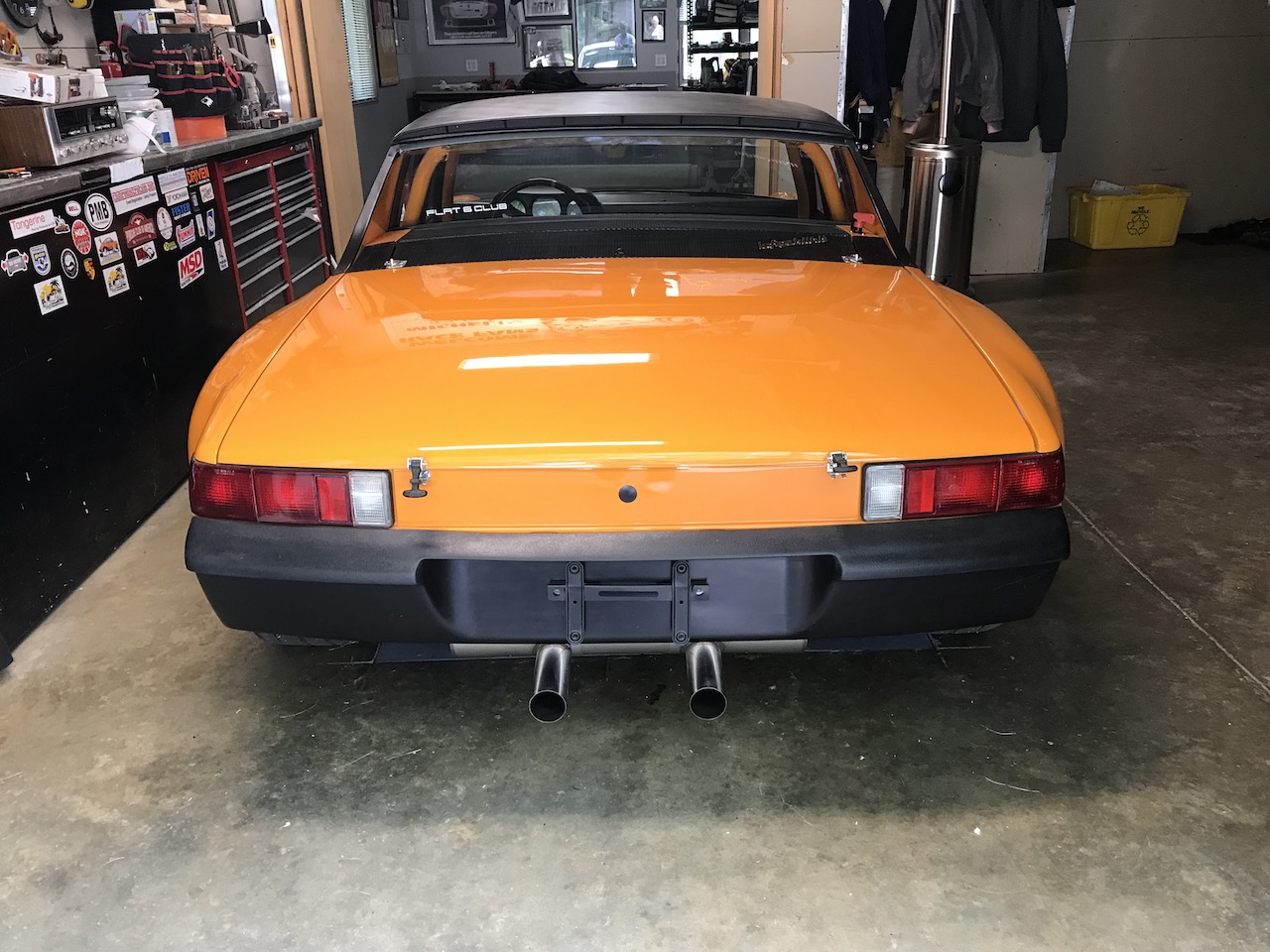

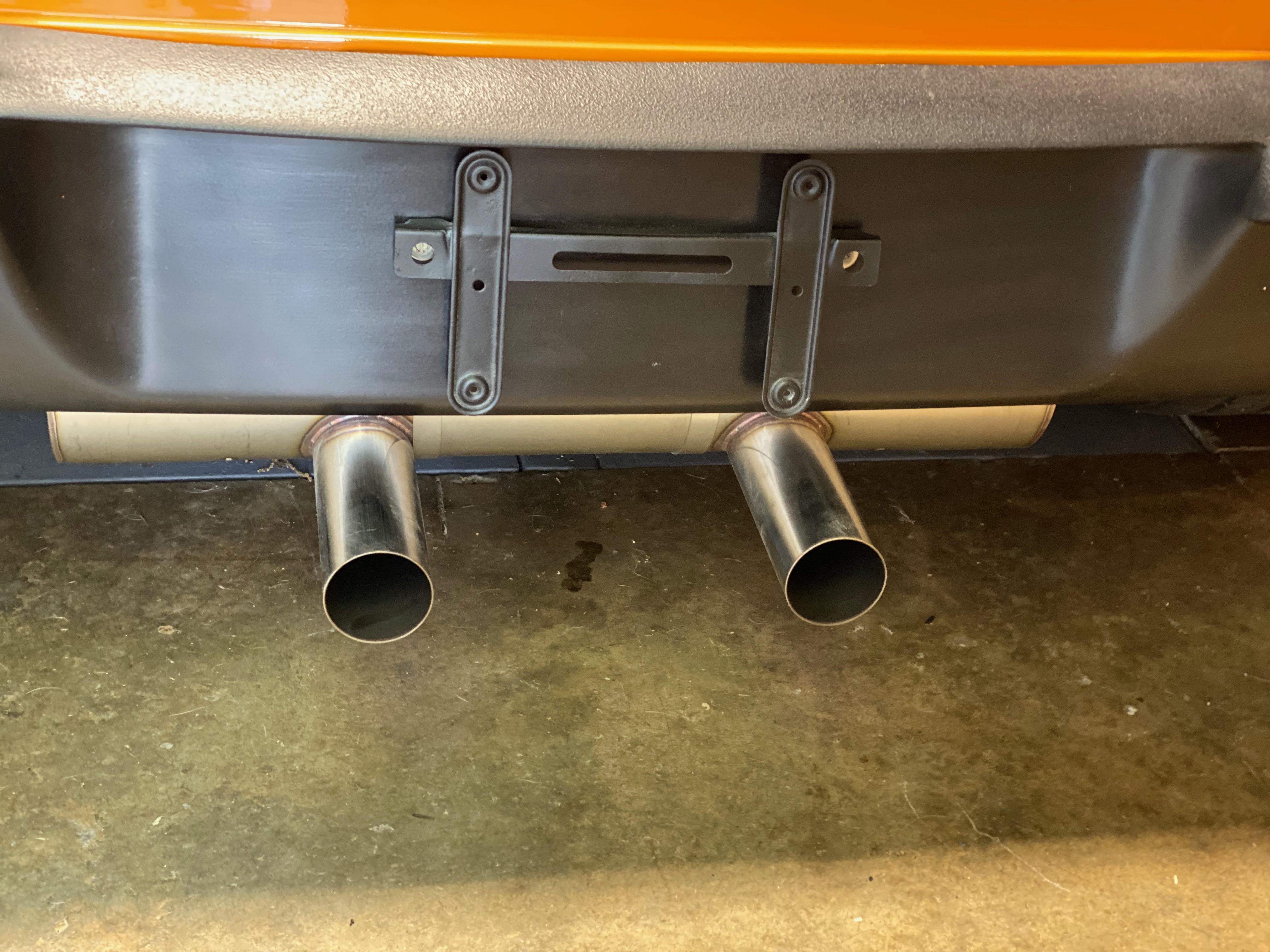

Yup, Ben's sport muffler, will make sound video tomorrow. MarkAttached Image Attached Image

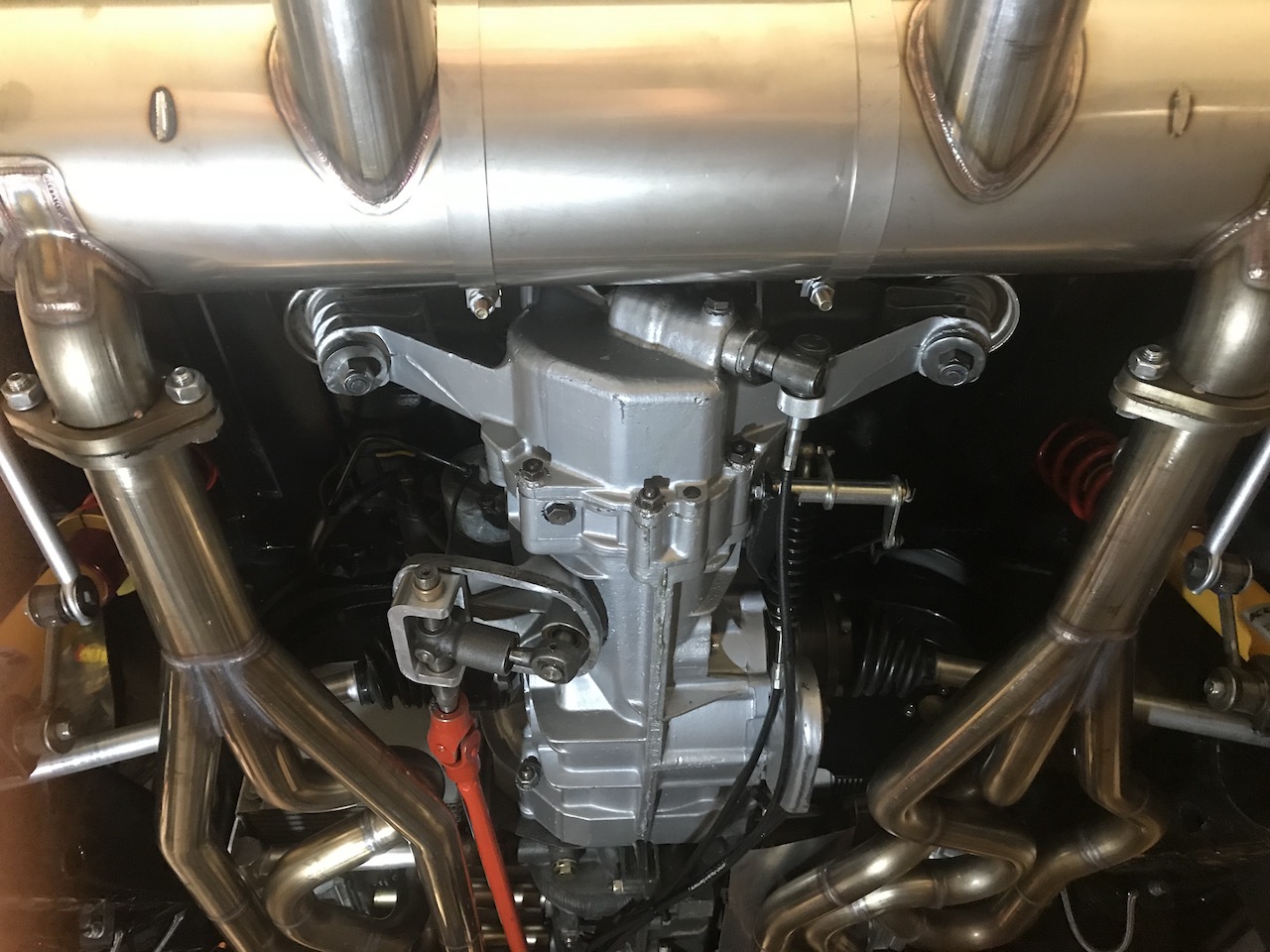

Just look at Ben's work, both header and muffler.Attached Image
