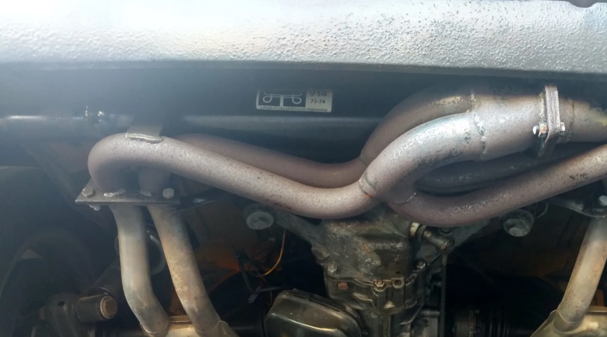

Who puts an aftermarket reflector, a rusty bursch exhaust, removes the rear trunk springs and swaps out the heat exchangers on a 6k mile car?

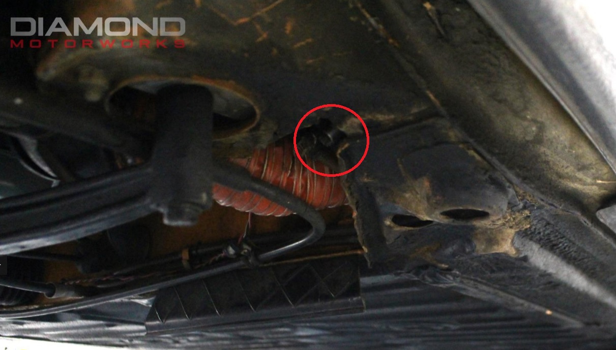

Seems to be some questionable wiring hanging down by the trans and along the lower firewall.

"arguably the best in the world"??? Im not seeing a very strong argument

(IMG:style_emoticons/default/WTF.gif)
is that a socket?

the BAT ad is interesting as it implies the rear reflector was fitted as part of a "special dealer package" when the car was new!!!! (IMG:style_emoticons/default/smile.gif) pretty funny that the dealers were tarting them up like that. if you look close the rear trunk lock is drilled through the reflector which is very unusual. most later aftermarket installs used a remote release.
also came with the bursch exhaust. all is not what it seems. ie its actually original from the showroom - maybe not factory, but showroom - (but restored).

QUOTE(JamesM @ Aug 6 2022, 02:14 AM) *
is that a socket?
May be the connector for the original fuel pump.
What is the twisted pair of wires by the hand brake cable?

Or maybe Bursch had a psychic tell them that this exhaust that was "dealer installed" in 1973 would only be useable though the 1974 year cars. (IMG:style_emoticons/default/rolleyes.gif)
