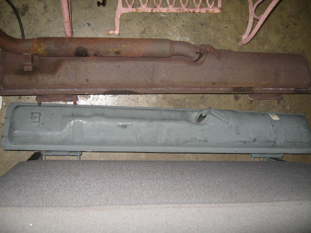

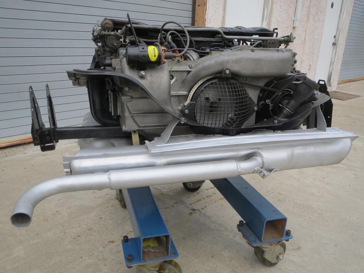

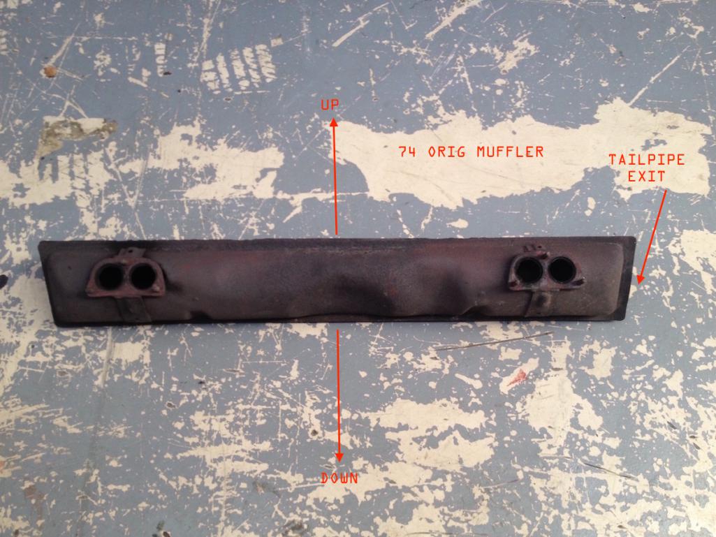

here is the original factory 914 muffler that was once on my car.
its a 74 1.8

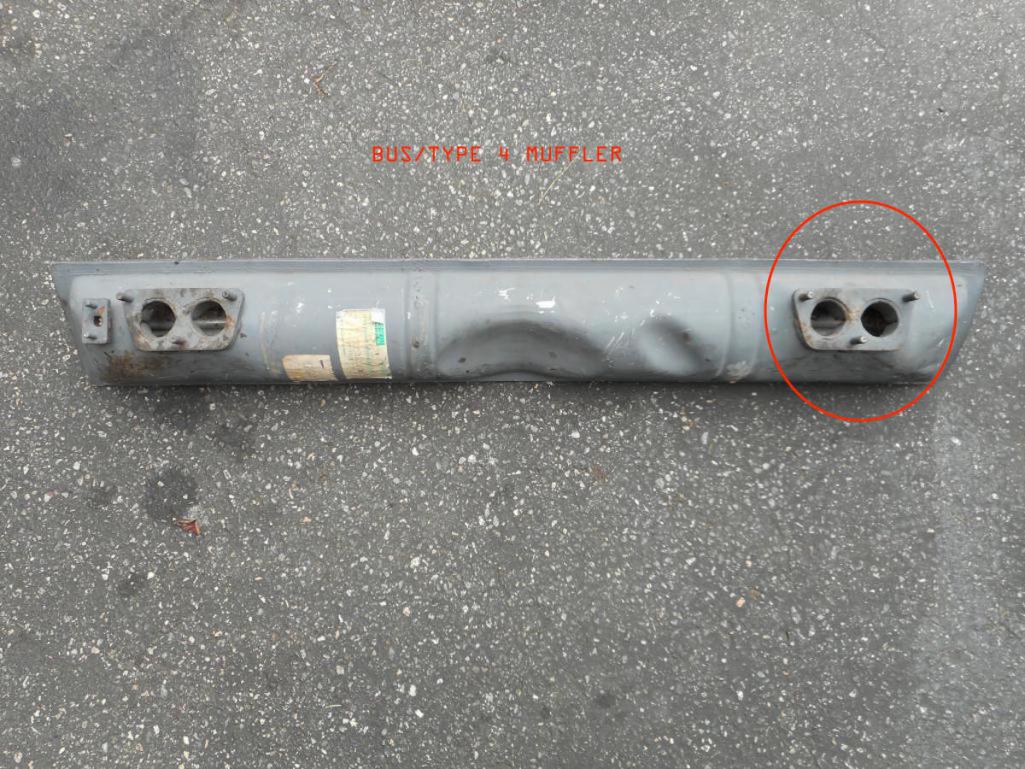

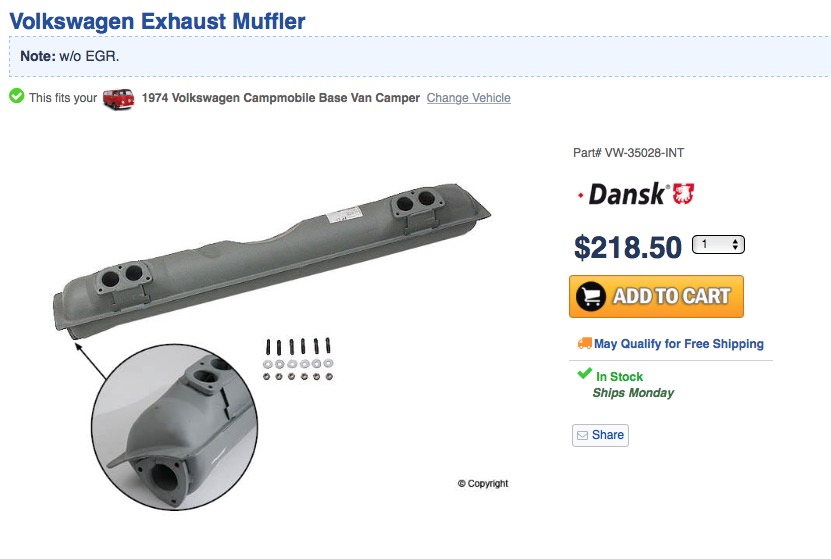

here is bus (or late 412) single piece german factory muffler.
notice how the VW application has the inlet flange plates welded at 180 degree rotation to a 914.
they used the same basic muffler but that was the difference.
this allowed the 914 to retain its lhs tailpipe location in these later single piece mufflers.
the bus and the type 4 exited on the rhs.
all the crazy dents and creases in the muffler are because it tucked up under the fan housing and allowed for the oil dipstick filler tube because they faced up in the bus.
they end up facing down in the 914 and make no sense because its not tucked up under a fan housing. (IMG:style_emoticons/default/biggrin.gif)

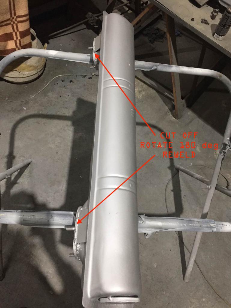

or you can do what i did which was modify the bus muffler and cut the inlet flanges off
and reweld them back on 180 degree rotated.

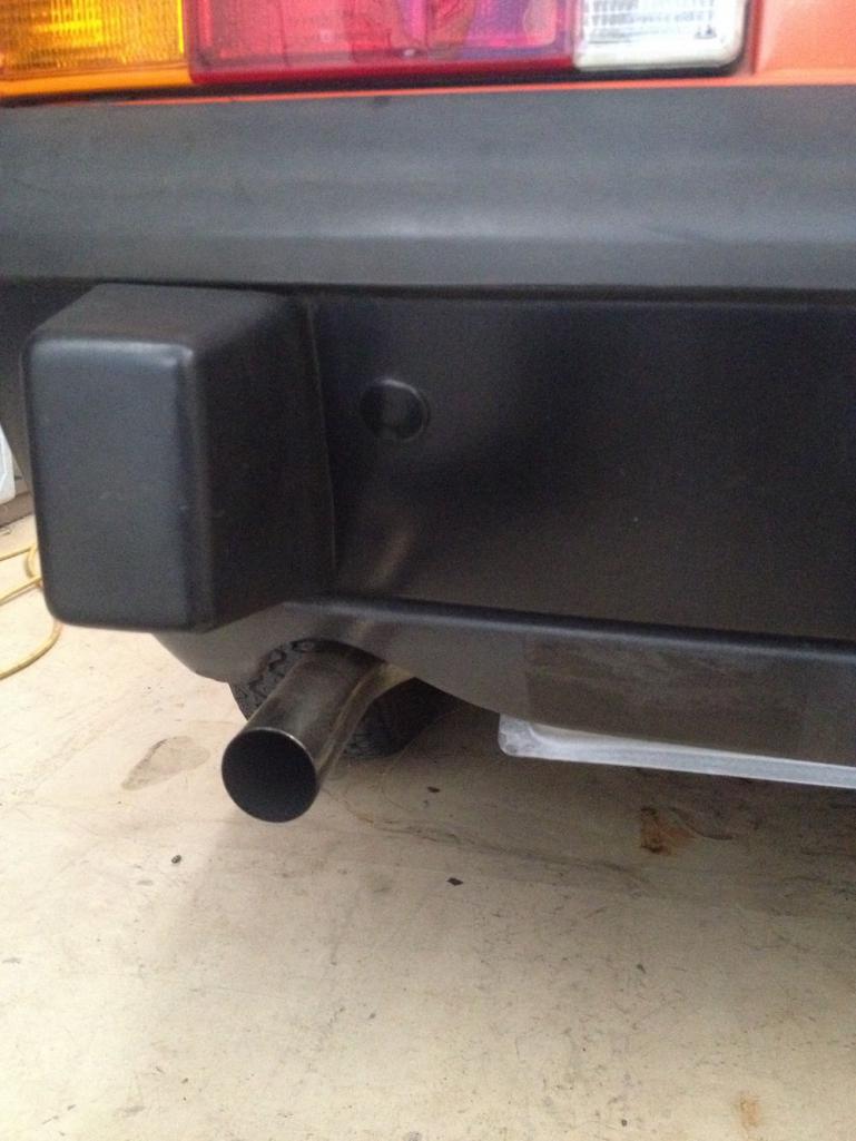

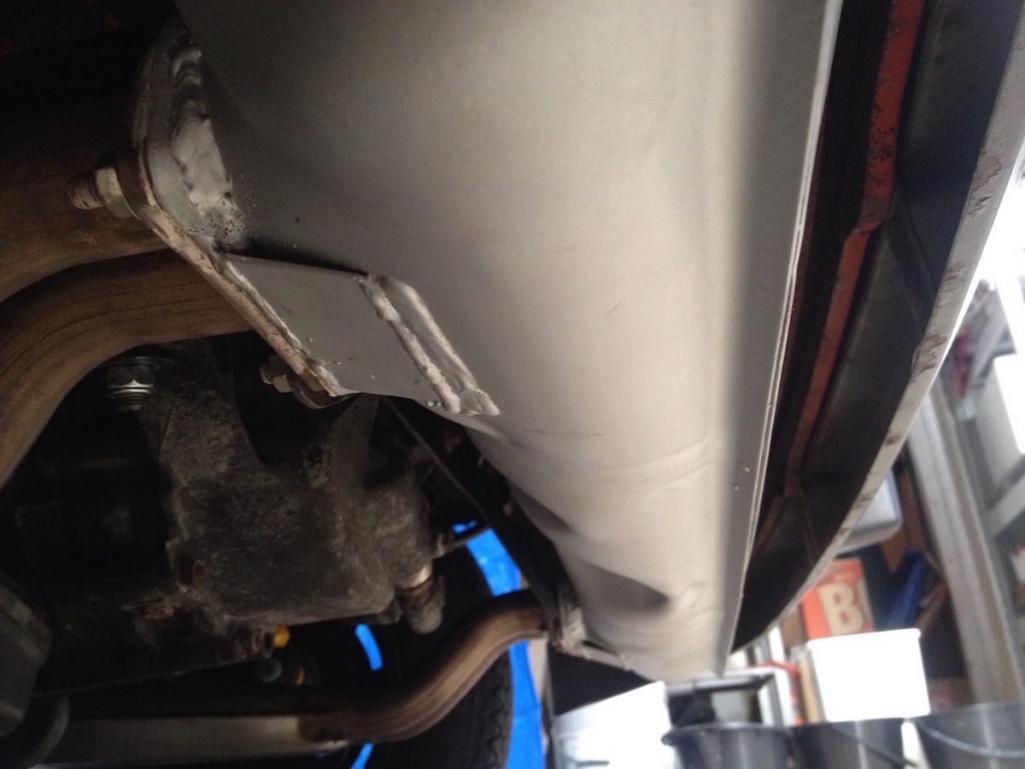

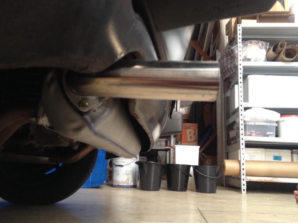

here are some photos of back when i modded the bus muffler.
about 4 years ago.
i did run it unmodified for a while before that with a modded tailpipe out the rhs just for convenience when i first had to change the muffler. (that was when the penny dropped about the rotated flanges. when we first looked at the muffler both my mechanic and i thought, aha its just a bus muffler. but then after getting hold of one and going to tfit it we both said, oh no its not quite a bus muffler. (IMG:style_emoticons/default/smile.gif) )then i took it off and did it properly a bit later on.
the photos have reminded me we did a bit of reinforcing to kind of duplicate how the 914 mufflers have reinforcing plates from the flange back to the muffler body.
we did "sturdy" plates but given the muffler pretty much hangs of those flanges even though the flanges are suspended from the hanger off the gearbox i figured i'd make sure it did not vibrate so much it would crack the flange welds down the track.
it all works really well except the exhaust does sound very "tinny" until it warms up.
i put that down to the SS heat exchangers in addition to this SS muffler.
doesn't have that deeper tone that the mild steel exhaust systems have.

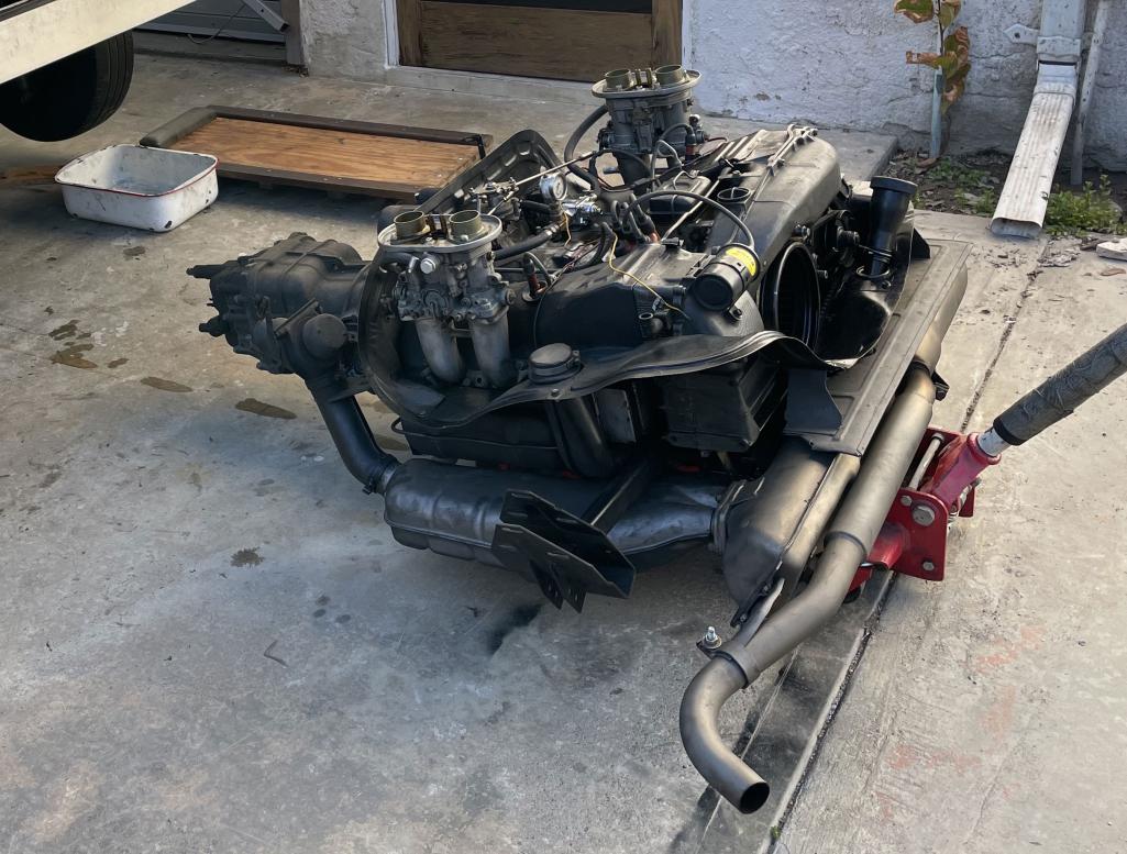

The rusty one here came off my 72 914 which has a snowplow valence. Both of these are the same. The tailpipe lined up with the hole.
Here is the nos muffler above on the engine of my 72 bus.
(IMG:http://www.914world.com/bbs2/uploads_offsite/www.thesamba.com-21899-1671587553.1.jpg)
I'm thinking maybe the tailpipe of the side exit 1.8 bus muffler can't be made to work with the 914 valence? I know it's triangular/3 bolt, and could go 3 ways(?) I've run the Ernst before but I don't have one currently to check..

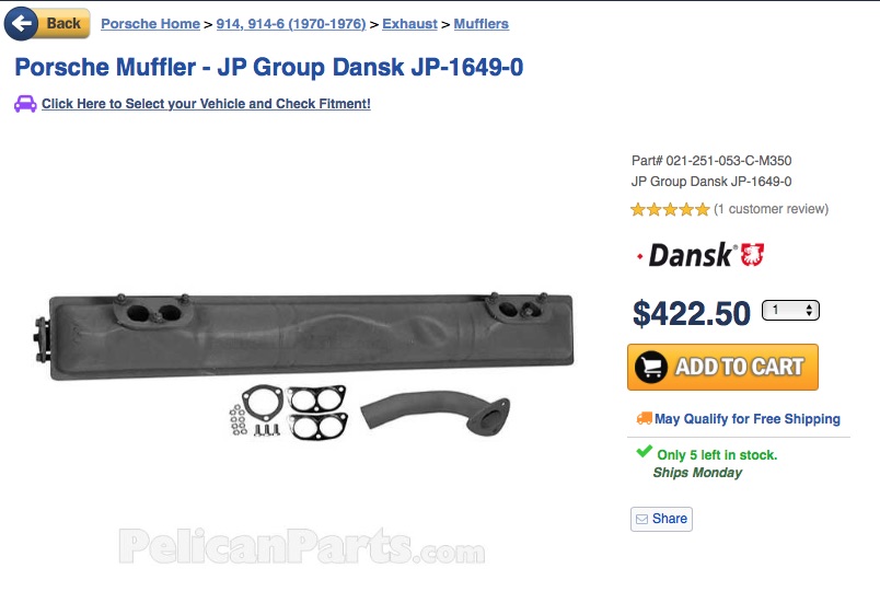

@nathanxnathan

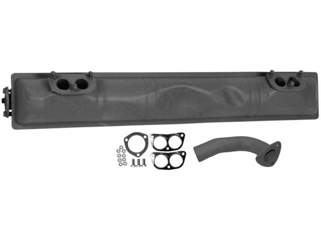

here are the two dansk ads side by side.
you can see it all clear as a bell.
note where the tailpipe outlet is in both mufflers then look at the flange plates.
the ernst will be the same as the dansk VW one.

Ah yeah, I see what you mean. The side exit mufflers come out the right side. You actually have to modify the 72 bus right side rear bumper bracket to clearance for the tail pipe. In 73 they switched the tow hook to the left side.
Still, unless the Dansk muffler has the picture wrong, the outlet is coming out the right side, and it is essentially a bus muffler.

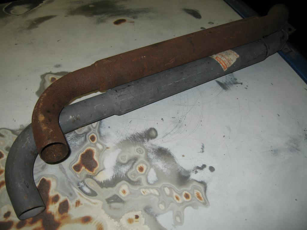

Here's a pic of the original 914 1.7 L center exit tailpipe (rusty one) vs the longer (411?) tailpipe.
The proper early type 4 bus tailpipe is actually like this, since I'm all showing off my early tailpipe collection. (IMG:style_emoticons/default/biggrin.gif)
