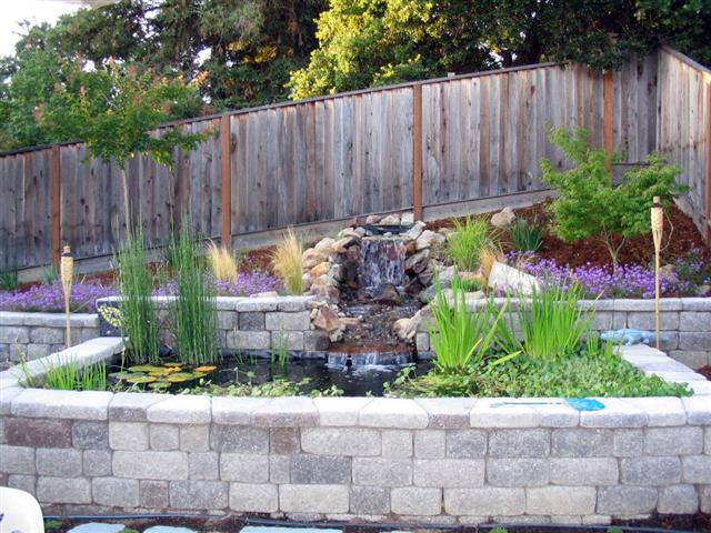

I built a 1,400 gallon koi pond with a stream and waterfall a couple of years ago. It is about 2 feet above the ground using interlocking blocks (10 pallets worth), my back aches just thinking about it. I can't make my picture smaller, so I will e-mail one to you. I've often sat on my patio thinking about the same thing. Biggest problem would be keeping it clean enough to see through, not to mention the possibility of leaks. My pond's enough work as it is.

Hopefully this works...

Nice pond.
