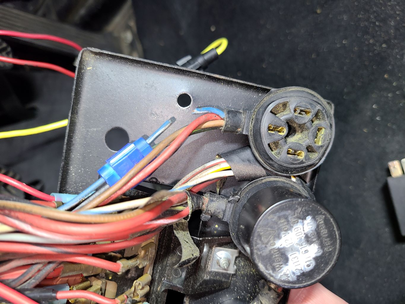

Going to RRC2023 last week, I lost all my gauges just after leaving home. Pulled over to check things out and found a blown fuse. Blew a couple more before I figured out it was the left turn signal. Didn't use them for the rest of the weekend. I asked around and someone suggested I check the flasher or turn signal relay. I dropped the fuse panel and found this. Did someone swap my relays around?

They are not in the same location/order as mine, but I don't believe you can swap relays into the wrong receptacles/slots as the pin configurations are different for the Wehrle and the square units..

I guess the bases could be swapped. I'll have to look at the connecting wires.

The electrons don't care where the relays are. They just run along the wires to anything that happens to be there. The relay sockets can be moved around with some effort, and may not always have been put in the right place by Hans and Fritz at the factory.
Check the wire colors. If they're right, that's not your problem.
If the left turn signal is causing issues, the most likely causes are the turn signal housings front and rear, and the side marker light. Or the wires going to those.

I see lots of NON STOCK wires in the background. Are they hooked up where they might cause a problem?

That is a jumper wire to make the later 5 pin directionsl relay mimic the proper working of the original 4 pin relay.
