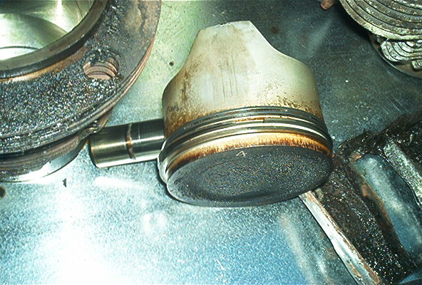

I may just power wash this stuff, will anthing cut it?

post Aug 21 2005, 06:40 PM
Whiplash
Posts: 1,514
Joined: 1-June 04
From: Lake Zurich, Illinois
Member No.: 2,140
got things clean (er) (IMG:http://www.914world.com/bbs2/html/emoticons/huh.gif)
#2 with some scuff

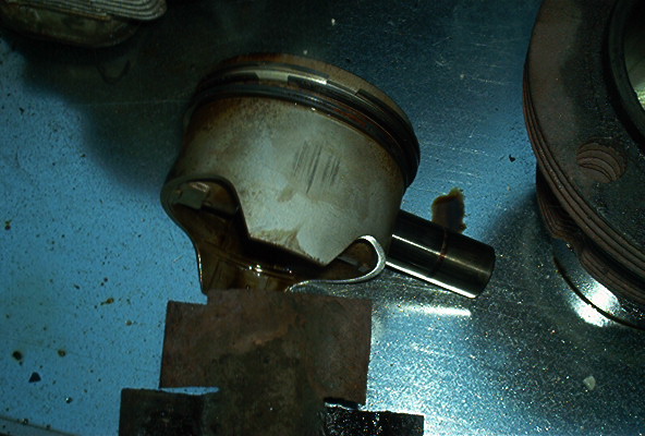

qa1142
post Aug 21 2005, 06:42 PM
Whiplash
Posts: 1,514
Joined: 1-June 04
Member No.: 2,140
#4 with scuff
