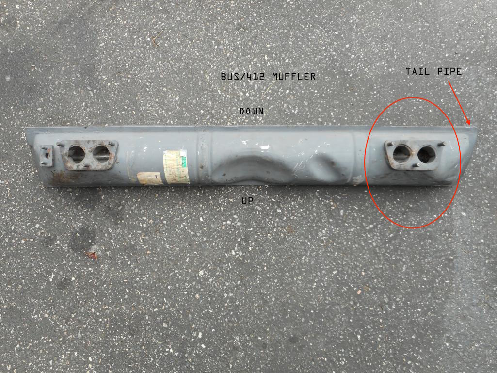

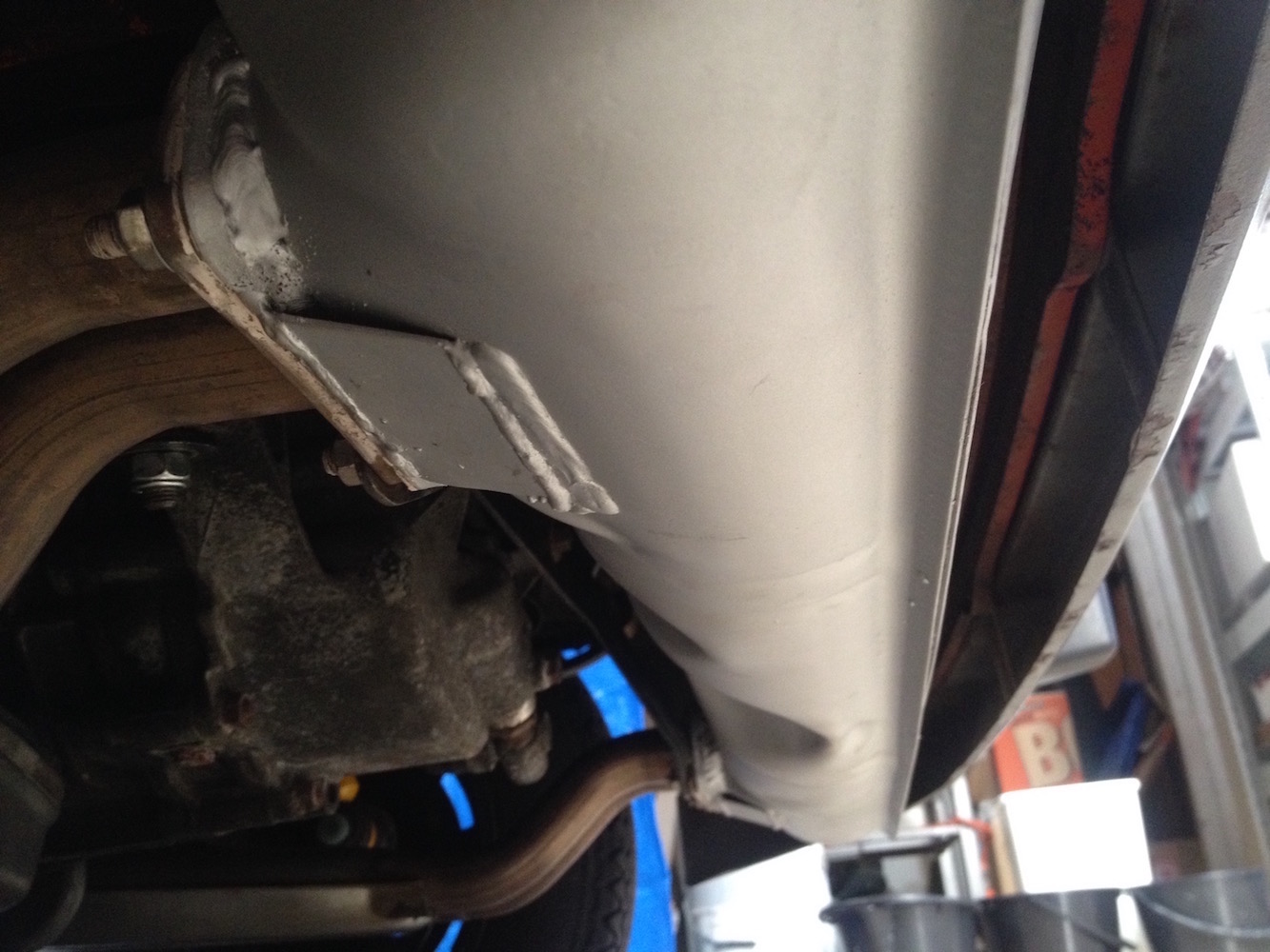

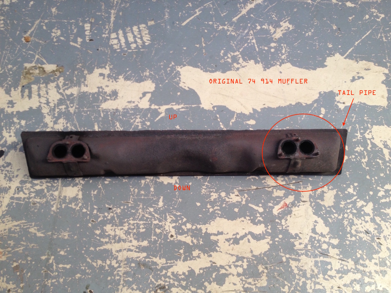

if you are handy with a welder i have a tip for you.
the stock muffler on a 1.8 is in fact a late bus muffler.
except for one thing.
the inlet flanges on the muffler are welded on upside down compared to a 914 muffler.
all the strange dents formed in the 914 muffler that are visible on the bottom face the other way up on the bus and allow the muffler to fit against the bottom of the fan casting and for the dipstick tube to pass above it. was also on the VW 412. right hand side tailpipe.
if you go to VW parts website you will find that dansk bus muffler is about half the $ of the same thing for a 914. (IMG:style_emoticons/default/blink.gif) (IMG:style_emoticons/default/sad.gif) (IMG:style_emoticons/default/smile.gif)
you cut those inlet flanges off and weld them back on upside down.
i was real lucky about 25 years ago. i found a stainless bus muffler here in Aus.
not entirely certain whether it was an Aus parts manufacturer who made it or whether its german and originates from the 70s or 80s. but i did the mod on it and i've got an entire stainless system from heat exchangers through to muffler.
it will outlast me and the next owner.
only disadvantage. it sounds tinny and horrible until it warms up. its very funny how the tone changes for the exhaust note from stone cold start up to fully warmed. (IMG:style_emoticons/default/biggrin.gif)

here is what i am talking about @Artfrombama
there is also all sorts of weird versions of this late muffler type.
like super quiet ones for 412s that were a bit more restricted internally etc.
but as far as i can determine, the 914 got the bus one. which was i believe less restricted internally.

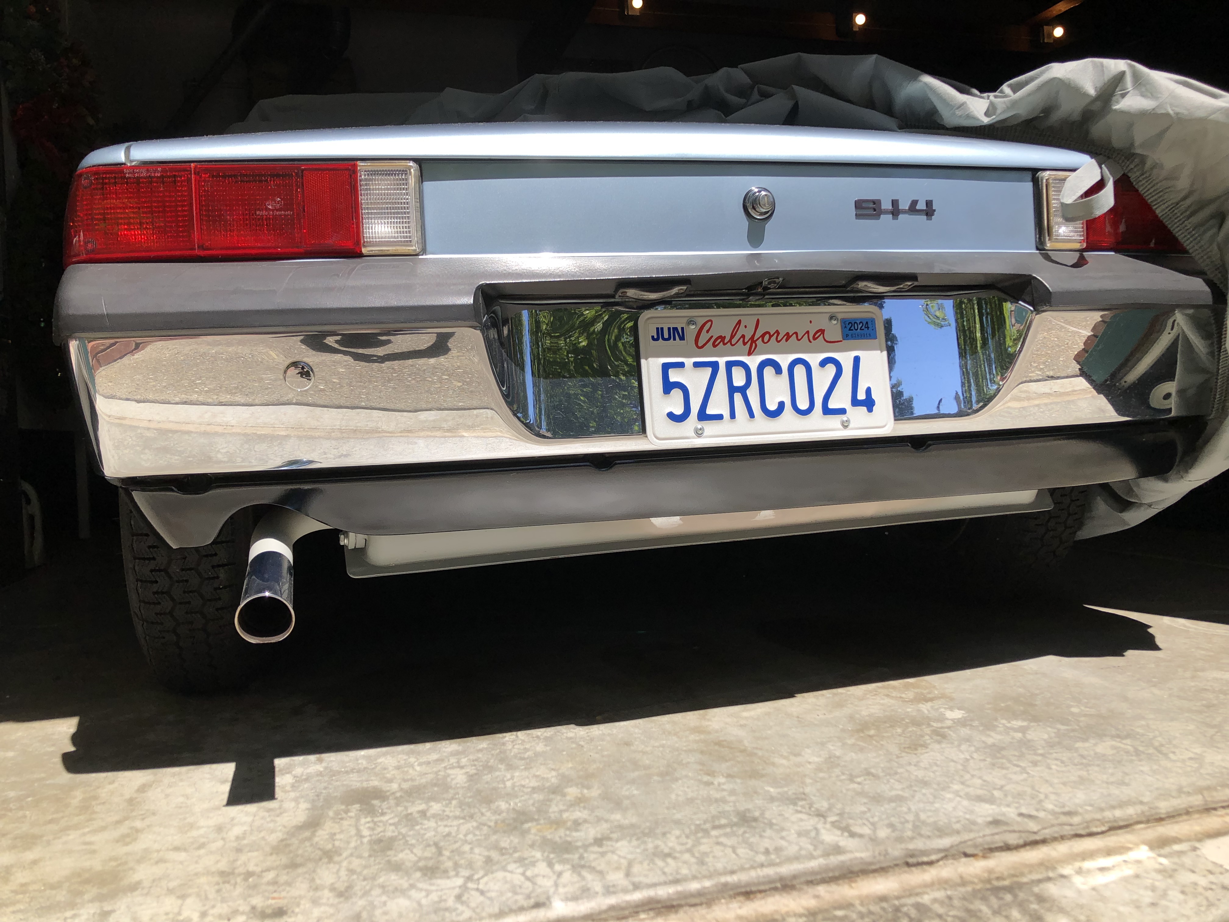

Have your muffler shop add a 2.5" (#f4) flange just after the 4x2x1 merge. Bolt on a 2.25" core magnaflow muffler; then blast and ceramic coat everything. You get a great working/sounding system, not heavy and run a custom (R exit) style valance/ or no valance
(IMG:style_emoticons/default/marty914.jpg)
Maltese Falcon
post May 30 2024, 06:28 PM
Posts: 5,236
Joined: 14-September 04
From: Mulholland SoCal
Member No.: 2,755
If you are handy with a hole saw/ Dremel you can run a (fiberglass) valance creation like this...
