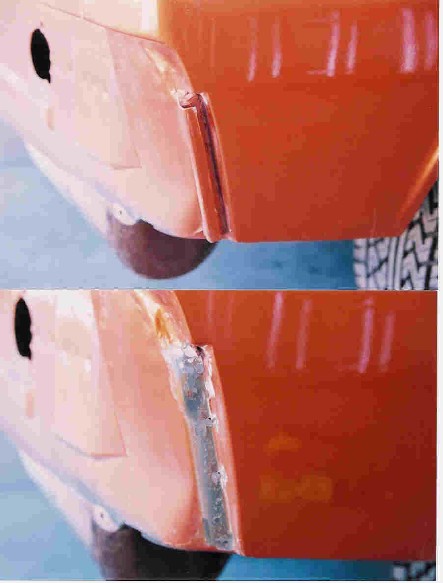

Yep, just did mine.
Old
Allan

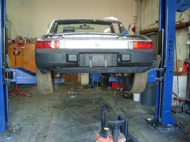

post Sep 29 2005, 02:43 PM
Teenerless Weenie
Posts: 8,373
Joined: 5-July 04
From: Western Mesopotamia
Member No.: 2,304
New

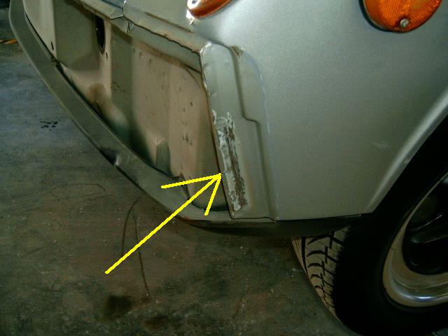

Show him the tabs you had to cut off. There's one on each side of each bumper; they're where the bumper cover hooked onto. Also the front lip of the channel where the front trunk seal goes is taller, you need to deal with that (cut it or remove/replace it).

See my blog. I did it. You have to cut off these tabs and the lip that runs right below the front trunk lid. Easy swap to do.

front tabs. 1 on each side.

QUOTE (Headrage @ Sep 29 2005, 03:25 PM)
Oh yeah...those too!

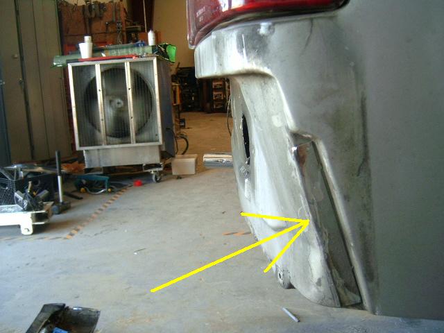

And this channel needs to be cut back.

Same on the rear.

I just drilled the spot welds enough to pop them off and then smoothed everything out. No need to drill all the way through.

Then ya gotta plug these hole so water doesn't get in the trunk. I'm going to use the shock retainers as a template and make some plugs in case somebody down the road wants to go back to original.
