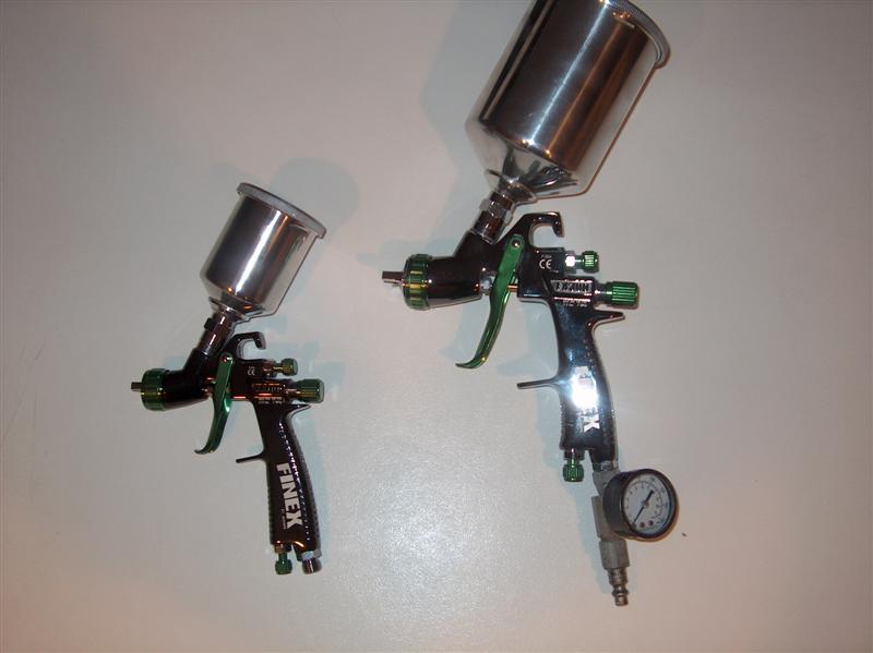

Buy this gun
Its LVLP ( LOW Volume Low Pressure) meaning it wont tax your compressor so much. Most home compressors can barely keep up with a HVLP gun. The evo needs 7.8 cfm at 40 psi, but I have found spraying high solids clears that 25-29 psi is fine
Oh the Evo is $154 but worth it, though you can get by with cheap guns. The EVo is very efficient with paint meaning more paint is sticking to the car than getting wasted as overspray
