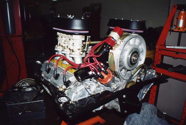

I'm looking at possibly getting a 3.0 but it has no F.I. So I would just run it with webbers.
Does anyone out there have this set up now? Are You running the CIS cam or was it changed out to a early T,E or S?
Bruce Andersons book says it's an easy 200HP with Webbers (set correctly) and headers, and the stock CIS cam.

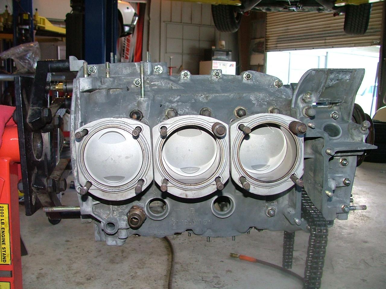

QUOTE(James Adams @ Feb 7 2007, 01:15 PM) *
The problem is that valves will hit the pistons with the more aggressive cam grinds.
So change pistons and cams if you want something like S or Solex profiles
Like these... (IMG:style_emoticons/default/biggrin.gif)

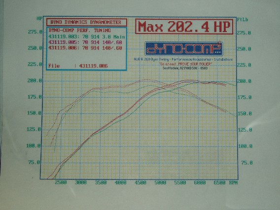

The 'E' Cams are the hot setup for a 3.0 with Webers. Ton's of Tourqe down low. I get 200 HP with as much torque to the rear wheels. The valve clearance is close, I think it still has the CIS pistons.
Here's the dyno at the wheels:
