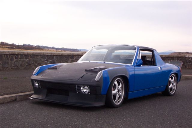

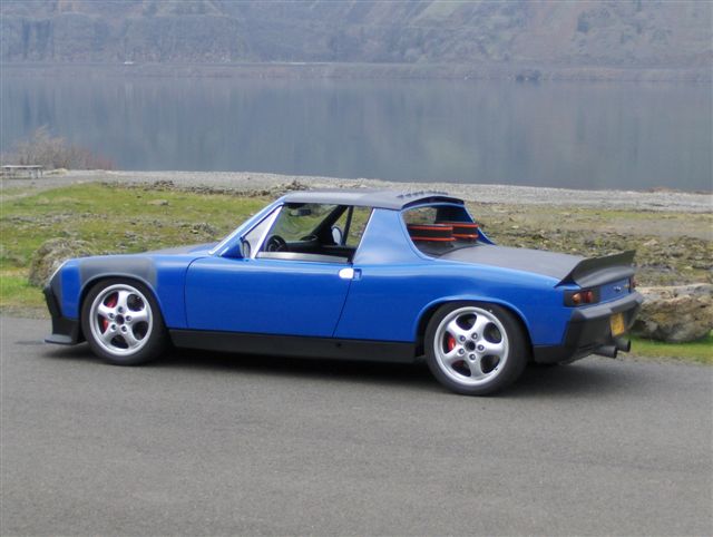

These are 8" x 17 with 235 on all 4. Previously I had 7 x205x17 on it. Now doing bolt on flares, with 9x255x17 on all 4.

This picture is with 7" x 17. I have this set for sale.
