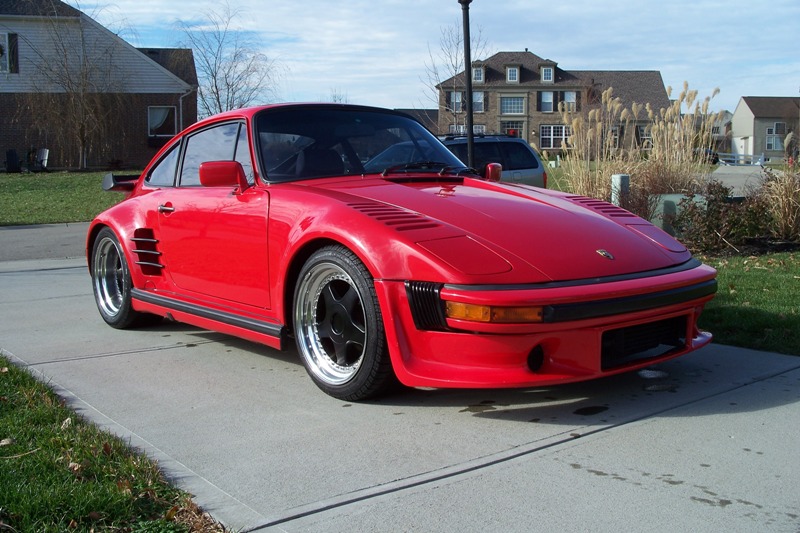

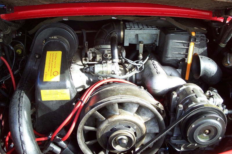

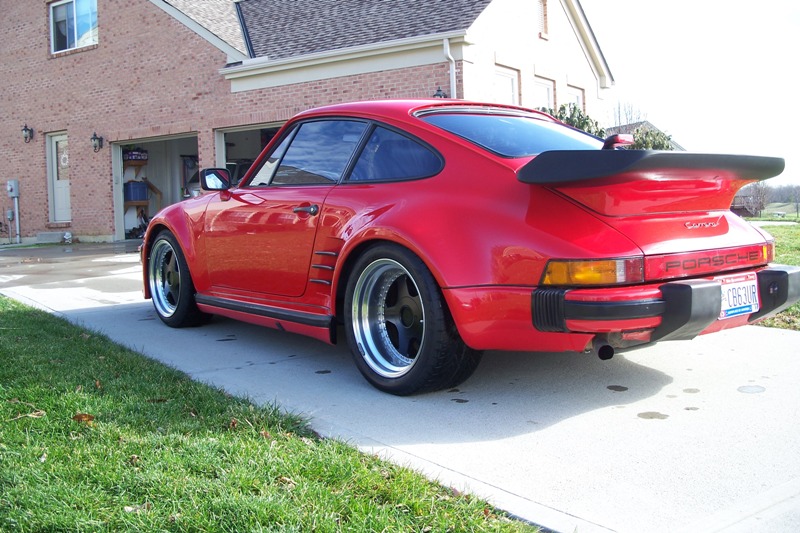

Not sure if you would want to drive this everyday, but I am thinking about selling my 911. It is an 84 Carrera 3.2 with 111k on the clock, a full steel slantnose conversion, and it just had a major service done at the dealership - received a very clean bill of health. A very fun car. It needs a couple of things if you are into perfection, but if you are looking for a very nice, fun car to drive, it would be great. Asking $17k.
Ken

PS... I am sold on the 3.2. I love the torque and the throttle response from this engine. I am selling the 911 to fund a 3.2 in the 914. Given the reliability and cost of maintenenance, it is the only engine that I am considering for Ol' Blue, my (nearly) rust-free '75 1.8.
I have two young kids, not much time, a 3 car gargage and 5 cars at the moment. I have to sell 2 and as much as I hate it, the 911 hase to be one of them. PM me if you want more pics.
Ken
