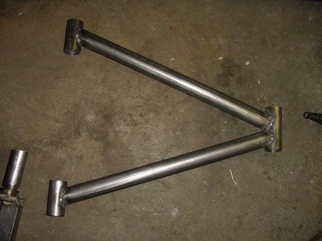

I made the mistake of buying an arc welder first when I should have bought a mig. I used it a good bit on my rail buggy. I could already arc weld before I bought it so I was a bit farther ahead. If you do buy a welder start with a mig or wirefeed welder you can convert to mig later on. It is just much easier to use a mig. I drag out my arc welder about once or twice every six months. I use the wire feed at least every other day. I'm using it right now to build a set of A-arms for the front suspension on my rail buggy. I couldnt do this easily with an arc welder.
