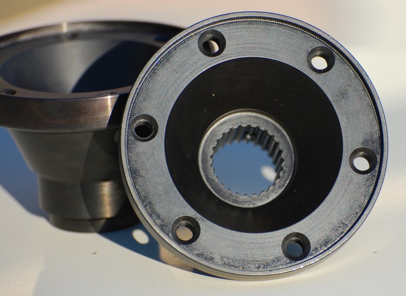

I picked up a 2002 Subie 2.5L N/A engine and 5 speed for $600.
However, like some else said the $$$ is in the conversion parts!
Magic flanges $500, VW Bus axles $220, Bremar 2WD conversion parts $325...

What are magic flanges???
Will they make me look thinner?
Rich

Magic Flanges thanks to Porcharu (Steve)

Thanks Zaney. I have seen those, but the price is nearly the price of an adapter from KEP. I woul just weld the two sets of axles together (Subie inner, 914 outer) to make it work for me.
