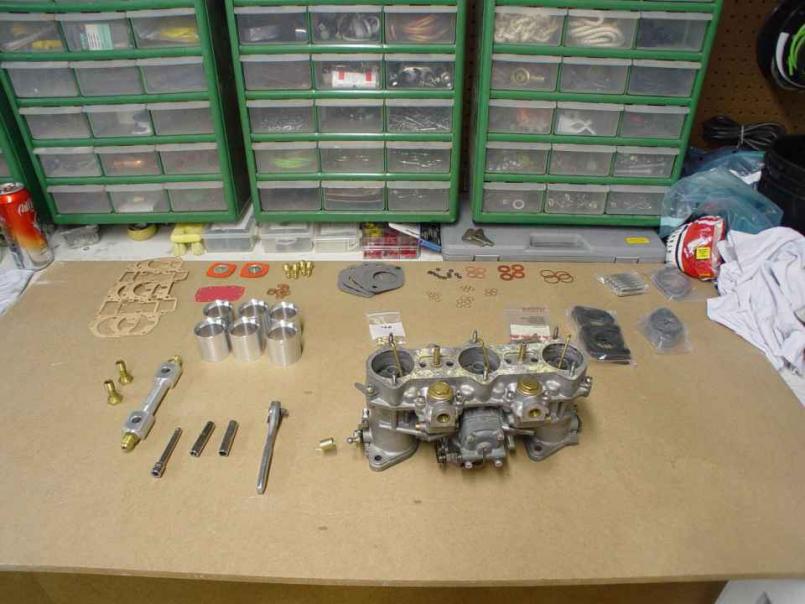

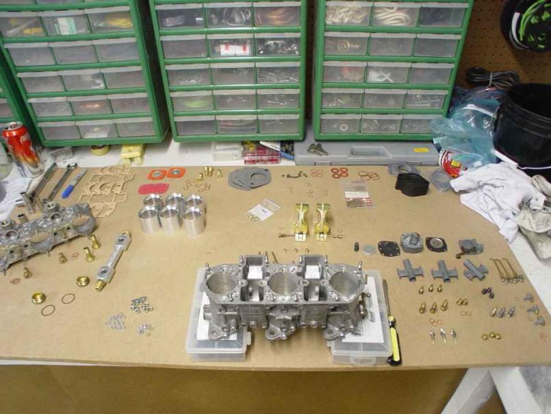

Well after 3 fricken weeks!!! I should have my powder coated stuff back from the dude @ Premier....been polishing wheels (no fun BTW, pics to come after paint!) and sent off my GT door panel pulls and bits to Bob @ ABC (pics when they come in!).
My carb parts came in from Richard @ PMO. 36mm chokes (VS 38 that were in there) and 160 mains (VS 155) and F5 emulsion tubes (VS F26) all per his recomendations...SOOOooo it was time to tear em apart and rebuild.
WHO KNEW??? there were so many parts in an IDS carb.....Funny thing is after taking it ALL apart I understand how it works....Carbs look DAMN good after 40 years dont you think?
