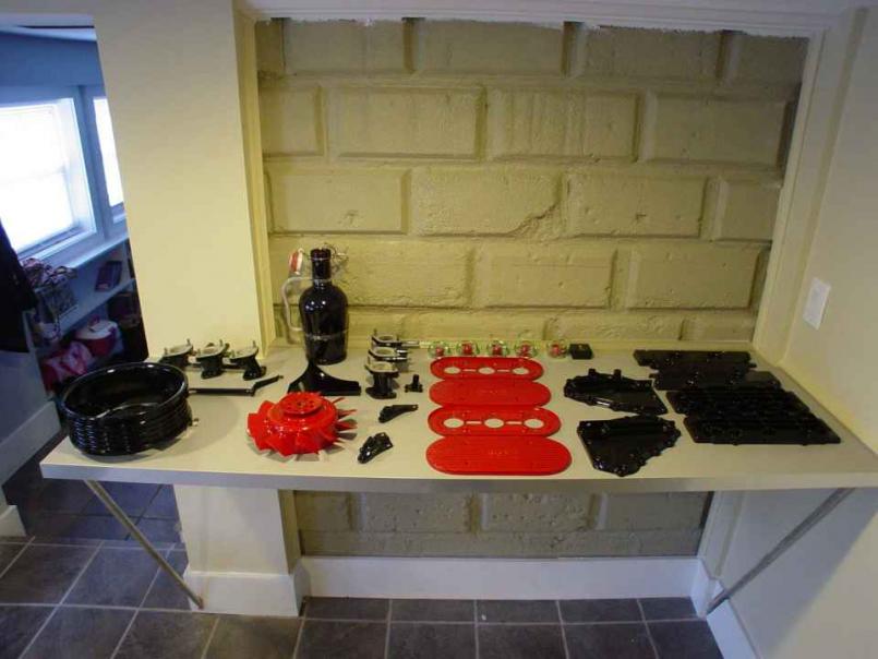

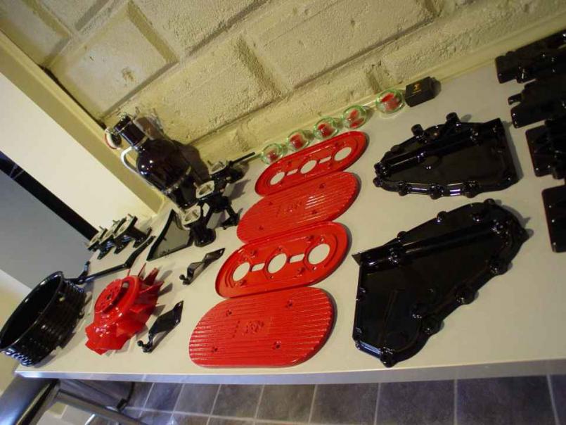

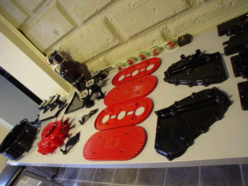

degreeoff   Ok so I started out with waynes book How to rebuil...   Jan 27 2008, 08:27 AM
GS Guy   I have all my valve covers/cam tower covers/fan/f...   Jan 27 2008, 08:42 AM
degreeoff   Premier Powder Coating (301) 772-3200 8521 Rainsw...   Jan 27 2008, 10:41 AM
