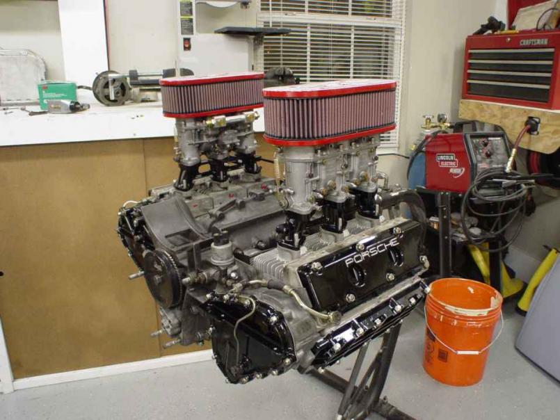

It all started when.....after many (5 or so) years of using and trying to improve my 4 cylinder performance I blew a heli coiled plug at an autoX....well that was the end I had already sunk a shit load of $$$$ into my ride and another shit load of time and I was DONE!! time for a sixer!! see the below web site for things I did previously to my lil friend by the time I blew the plug it was a 2056 with a KH header and MSD ign.
http://www.daybydayco.com/car4web/914.html
OK the scoop (AKA what I have bought so far)
-Engines [u](3)
A 2.4 ltr 2.4 with a 7r case and CIS.
A basket case 2.4 with rebuilt and ported heads, 2.2S P&C's and S+ cams +all new "stuff" to assemble it.
Lastly a rebuil 2.7 with all the good machine work done newly rebuilt heads, Ross 9.8 P&C's and GE 40 cams.
For induction I have weber 40IDS carbs
For exhaust I have European racing headers and muffler
For Ignition I have a HPV Crank fire setup
For Fuel I have a Carter rotory pump and a 15 gallon cell all lines will be AN/SS braided.
Suspension is out of a SC with Bilstein shocks, 22mm front sway stock rear sway, mono balls up front. 21mm TBars and 180lb springs
The body panels are ALL FG hood, trunk,skirts,valances,bumpers and flares.
The oil system is stock 914-6 tank and Earls front mount cooler with GT shroud
MISC stuff in no particular order.....solid mounts, Momo wheel, quick release hub, WM short shifter, Momo seats, GT door pulls, Pilot fogs, NEW Porsche exterior mirrors and a shit load I am forgetting.

degreeoff   Well I am on it now....Progress includes teardown ...   Jan 6 2008, 11:36 AM
Blood red 914-6gt   You sold the CIS for 250? I would have thought you...   Jan 6 2008, 01:53 PM
degreeoff   Well I got the P&C's on...deck height @ ....   Jan 10 2008, 05:41 PM
crash914   Nice! Give me a call if you need a hand, I go...   Jan 10 2008, 05:59 PM
degreeoff   Well Herb if all goes well I will be having my own...   Jan 10 2008, 06:06 PM

degreeoff   Ok so I started out with waynes book How to rebuil...   Jan 27 2008, 08:27 AM
GS Guy   I have all my valve covers/cam tower covers/fan/f...   Jan 27 2008, 08:42 AM
degreeoff   Premier Powder Coating (301) 772-3200 8521 Rainsw...   Jan 27 2008, 10:41 AM
