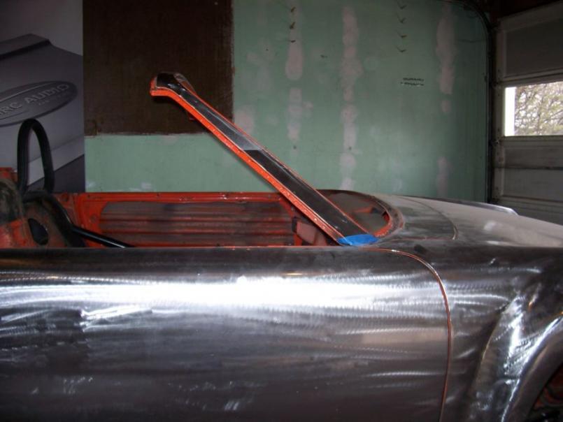

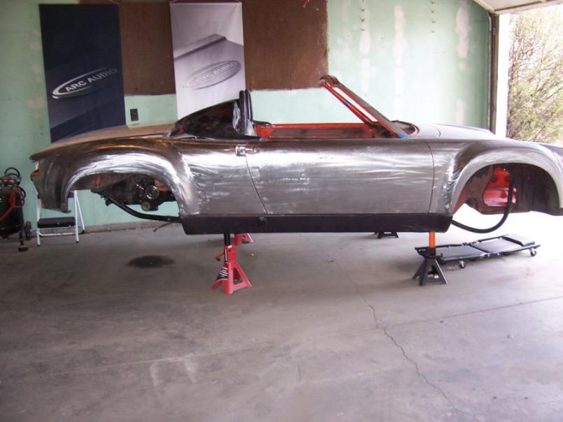

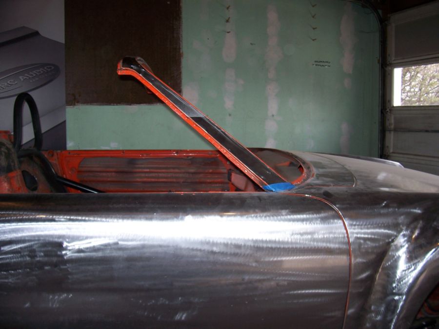

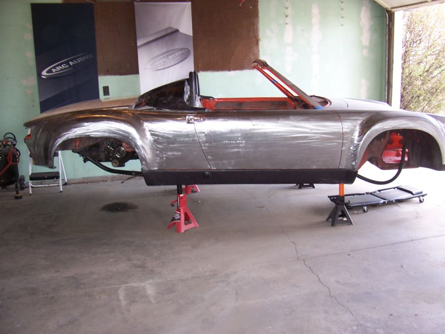

I raked the windshield posts back as far as the stock windshield allowed.
Next I will chop the windshield posts so the top of the frame is even with the top of the rollbar hoops.
I found a guy that will cut the stock glass to fit. Or cutting a lexan one is always an option if all else fails.
Here's how things are looking now.

plymouth37   I raked the windshield posts back as far as the st...   Jun 9 2008, 05:00 PM
914rrr   I found a guy that will cut the stock glass to fi...   Jun 10 2008, 09:44 AM
