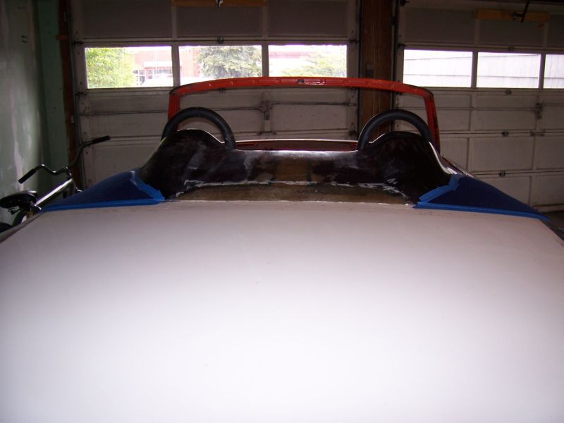

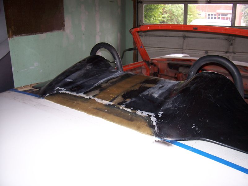

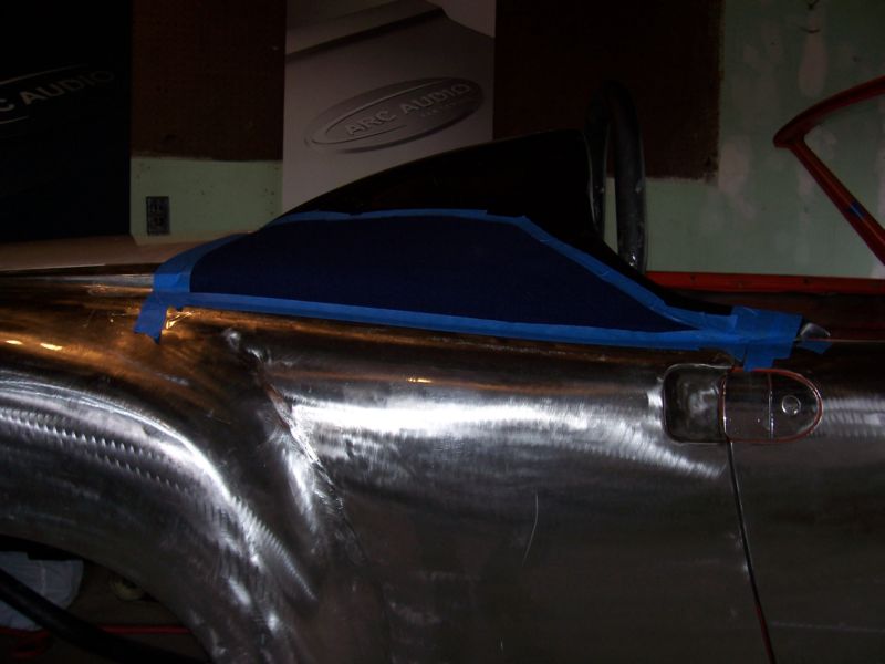

I started 'glassing the humps today and remembered how terrible fiberglass is to work with.
I 'glassed the two halves together and filled in the area at the back of the lid between the humps. Despite my total lack of skill I think it's coming along pretty well. It's a good thing I got these humps for cheap because the quality was terrible (good thing I am just cutting them up huh?)
To blend in the sides I am stretching polarfleece and glassing it (a trick used by audio guys to build complicated sub boxes). The fleece creates really nice transitions and when covered by F/G cloth is really strong.

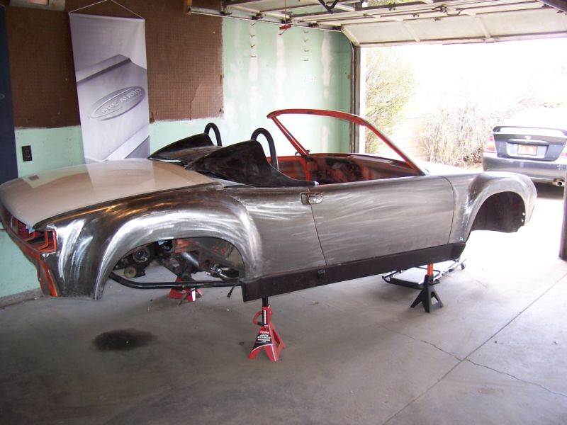

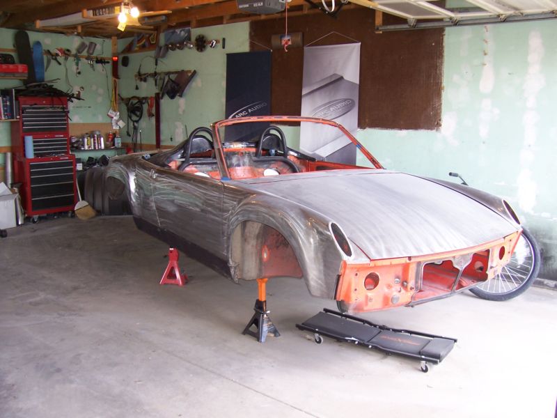

Here are some more shots of the car and the garage.
