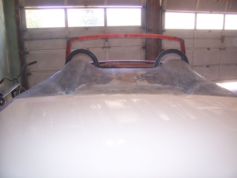

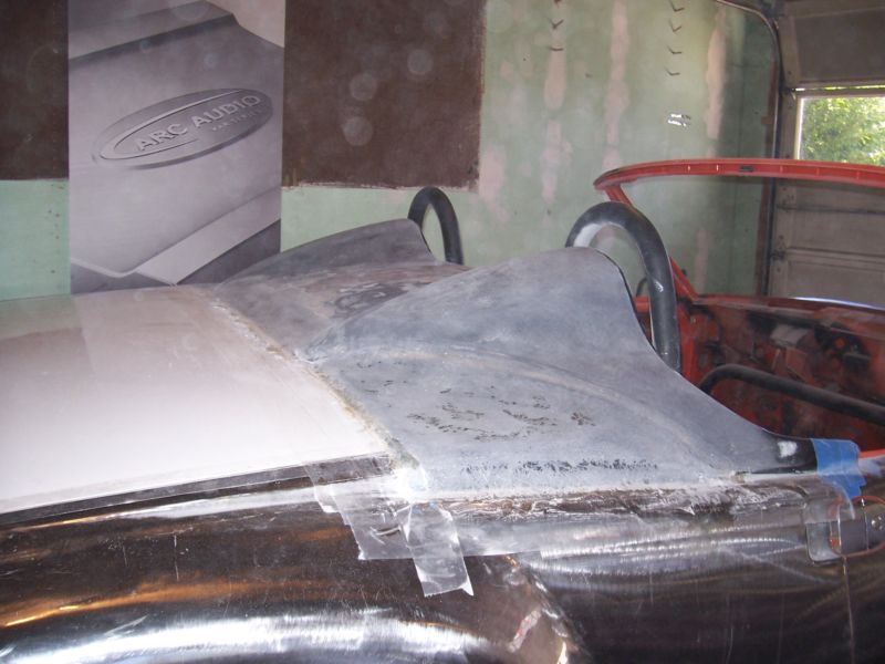

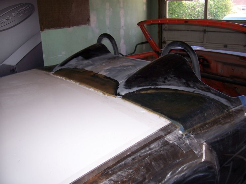

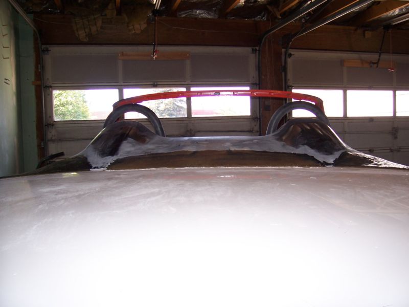

I added a layer of F/g last night:
I sanded the humps down this morning. There are a couple low spots but the shape is getting pretty close. I should be able to get it straight with one more glassing session, after that I will finish the bottom and edges.
