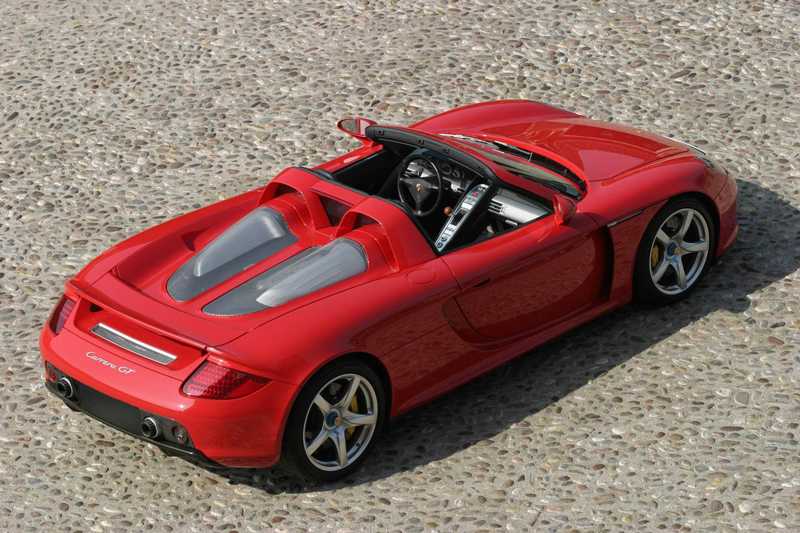

How are you going to vent the engine compartment, all from below? Howza bout grill material between the humps, a la C-GT
I have looked hard at the C-GT engine lid. I will probably be bringing in air from between the humps for the intercooler and venting the engine bay out the back of the car. I have to see the lid complete before I can tell what will look good.
