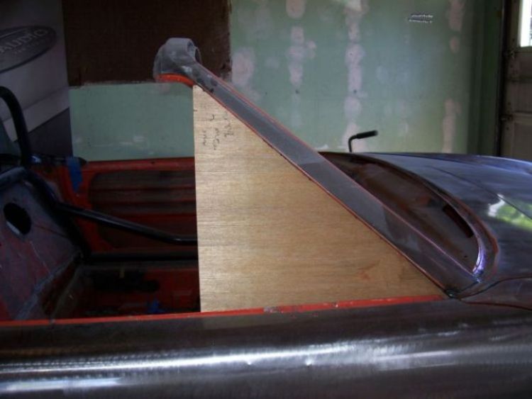

Today I made a wood template to ensure that I install the windshield at the right angle after I chop it.
Then I cut the thing off so I can modify it. Looks pretty cool huh?
I also test fitted my Getty F/G bumpers, they will need a little work but are pretty close.
It is so tempting to just toss the windshield all together.
Nothing like having to wear a helmet to go for a drive! (for some reason I don't think the wife would approve. (IMG:style_emoticons/default/biggrin.gif) )
