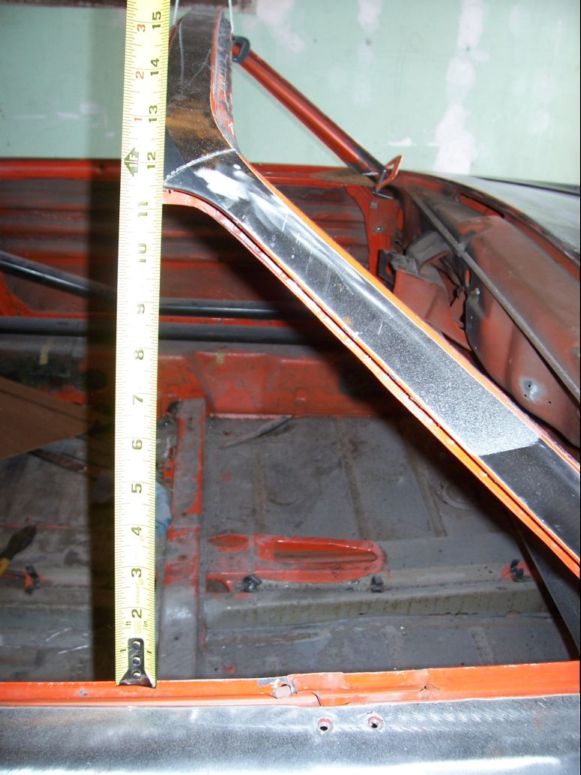

I filled in the headlight holes on a stock hood but I am swapping this one out for a lightweight F/G one.
Low enough? (IMG:style_emoticons/default/biggrin.gif) As you can see I needed to make relief cuts in the top corners to be able to spread the pillers to fit the cowl.
